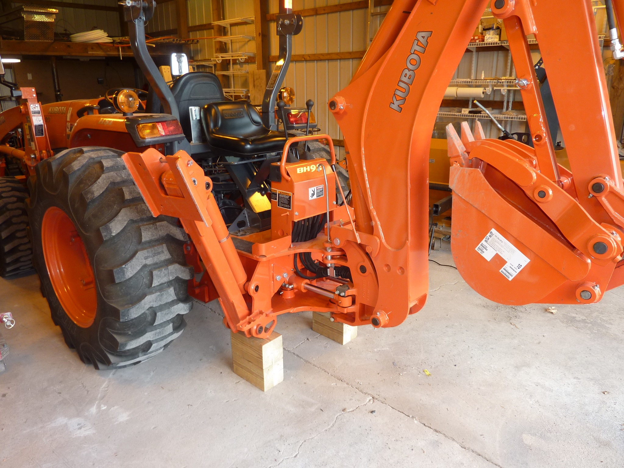

Thanks for the advice everyone.
Since the tractor will be used every couple of months, I decided not to bother blocking it up completely. I put a double 6x6 under each BH stabilizer pivot plate which raises the frame about 2" so the tires stay in contact with the floor.
Leaving the boom and stabilizers retracted actually takes more weight off the tractor than if they were lowered to the floor. This is hard to picture and even harder to describe. The 6x6's act as the pivot point of a "seesaw" with the tractor on one side and most of the weight of the BH on the other. Leaving the boom and stabilizers retracted also saves a considerable amount of floor space.
