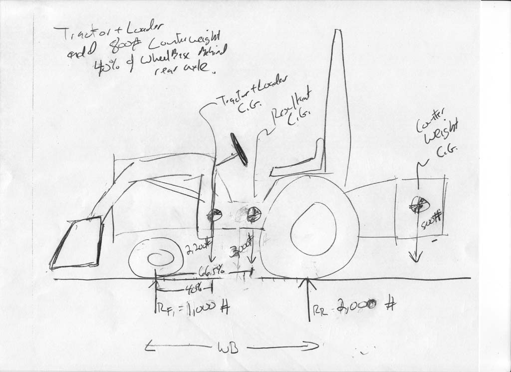

Tractor + Loader add 800# counter weight (CG of weight is 40% of wheel base behind rear axle)
Tractor weight 1,600#
Loader weight 600#
Counter weight 800#
Total weight 3,000 #
Dist of CG from front axle 66.7% of wheel base
Front axle load 1,000#
Rear axle load 2,000 #
Front axle distribution 33.3%
Rear axle distribution 66.7%
Both % and total weight on front axle are lower
Figure 5

Further reduction in % of weight on front axle, but still the same total weight as figure 4. So why bother weighting rear tires? It reduces the chance of tipping - you have to put more weight in the bucket before it'l go over. Additionally, you gain traction and it also lowers the CG to make for more stable platform (side slopes)

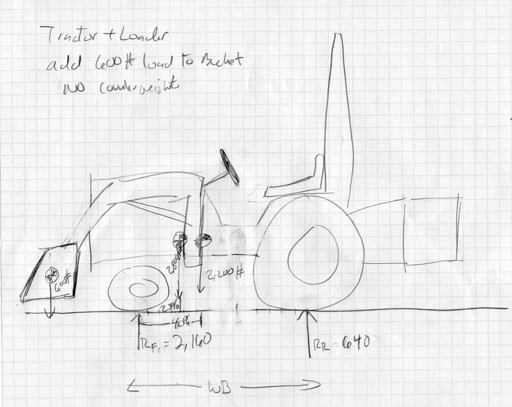

Figure 6
Tractor + Loader add 600# load to bucket (CG of loadt is 40% of wheel base in front of front axle) no counterweight or filled tires
Loader weight 600#
Bucket load 600#
Total weight 2,800 #
Dist of CG from front axle 23% of wheel base
Front axle load 2,160#
Rear axle load 640 #
Front axle distribution 77%
Rear axle distribution 23%
Now we have 3.6 times the original front axle load & a whopping 77% of the weight distribution on the front axle. You can see why we need to properly ballast when using the FEL.
