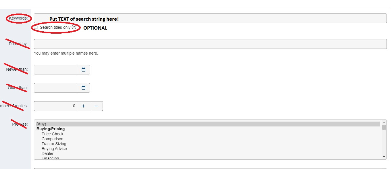

This is real basic and all you need to do unless you are searching for something or someone very specific...
