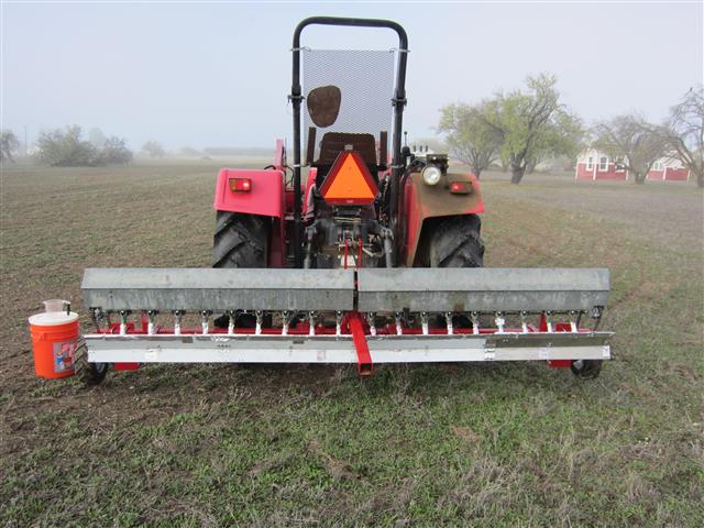

If you're talking about the standard 8-ft clearance for residential garage doors, you'll have a tough time getting a 40-50hp CUT with the ROPs in the run position through that opening. That's why my shop has 10 x 10 ft rollup doors so my 2008 Mahindra 5525 can fit with no trouble. The ROPs on my 5525 (54 hp engine) is 94" (7'10") tall.

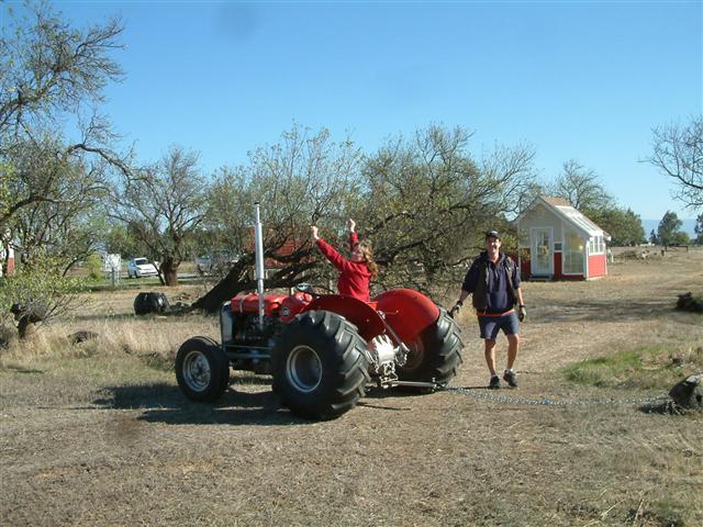

Check out orchard tractors if you're stuck with a garage door height limitation. They are built to squat low to get under the tree limbs easily. Here's my 1964 MF135 diesel (45 hp engine), a field tractor that's been modified for orchard work. The normal 28" dia rear wheels have been replaced by 16" dia rims and the rubber is Goodrich 6-ply 18.4-16A tires (18" wide, 16" dia rim, 40" tall overall).
Good luck.
