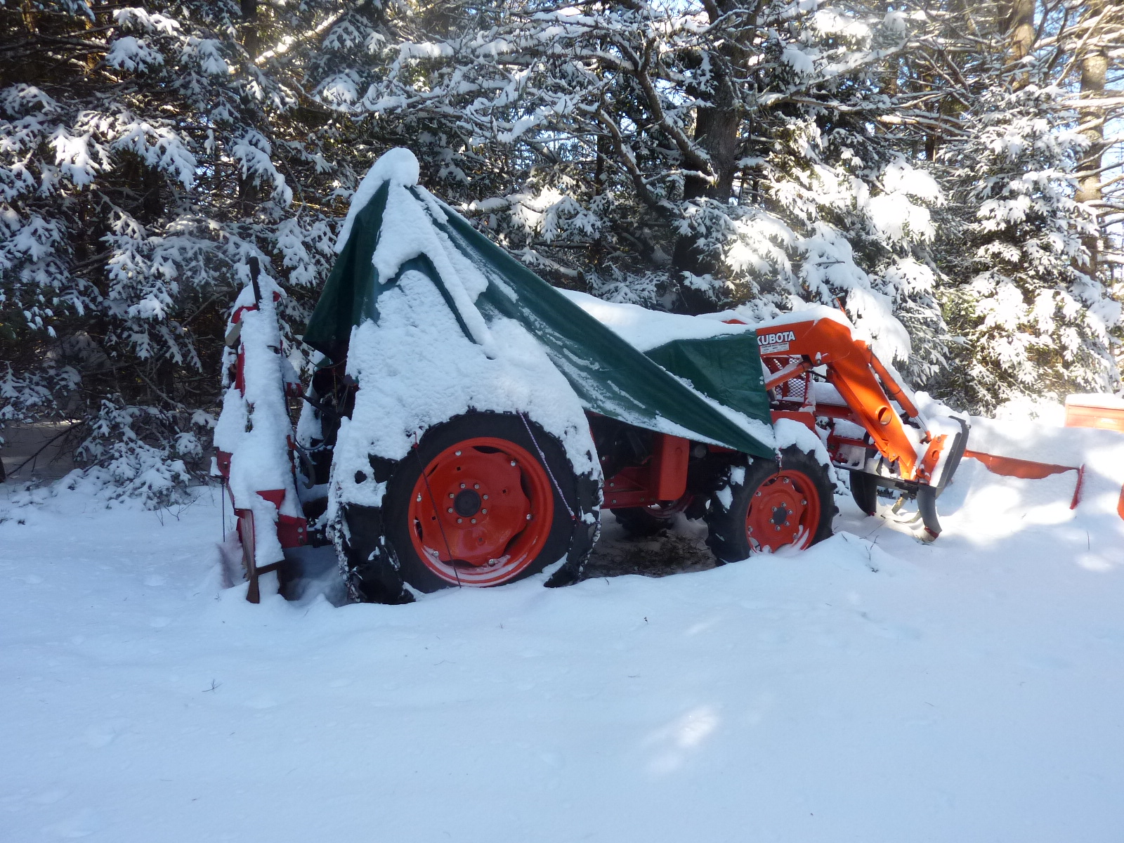

The 8x12' HF silver tarp last about it year or so. On the 3000&3600 they make a perfect tent and stay on well. I use drive way reflector marker stick on each end to form the tent and attach it to the tractors.

IMO, if you're going to use a tarp, run a line between a couple of trees as a ridgeline, pitch the tarp in an 'A' configuration (either square or offset 45deg), park the tractor underneath, then stake down the corners. It'll keep the weather off better and eliminate the tarp from resting on the machine, where it will trap moisture and potentially cause rust spots.

With a high enough wind tarps will abraid and damage a finish. They are also difficult to get positioned so you don't have water sitting in some spots. Just messy to deal with in my opinion.

We don't keep any of our equipment under tarps (though I may start doing so w/ a couple of imlements, since we're running out of space in the garages). But, I've pitched a few tarps while camping in some pretty substantial storms, and as long as you can get the edges low enough so that most of the wind blows over the tarp instead of catching it from underneath, there's usually not a problem. Don't use bungies to guy out the corners - use line (paracord is fine) and check it once in a while to make sure the lines are taught. Snow may be an issue during the winter, but I don't think the OP will have that problem in Atlanta.

Ford 2000; 3 cyl gas; 4/1 trans....I have no barn nor shelter for my tractor but have a friend in the billboard business and he scored for me a 14'x45' flex-face billboard which I cut up into tarp sized pieces. I take the muffler off the exhaust pipe, put a can on it, then an upside down large plastic mixing tub over instruments and seat, then lay the 8x10' 'tarp' over the tractor. I use spring clamps to secure the tarp to the back fenders and both steering arms. It keeps the rain off and, so far, no varmint except a wasp nest under the hood. It's also large enough to cover much of the rear tires. A word of caution...do not drape a tarp all the way to the ground. I did that once and, when I removed the tarp, the tractor was covered completely in condensation. Every surface. I use the smaller tarp now and it allows enough air movement to prevent condensation. You can find the same kind of billboard tarp on-line at places which recycle the billboards into various sized tarps - Google 'billboard tarps'. Before finding the billboard tarps, I was using regular tarps and the sun and rain killed them after about 3-4 months. Have been using the same billboard tarp for about a year and a half now and it still has a lot of life left. Can still read the Wendy's ad on one side of the tarp.
