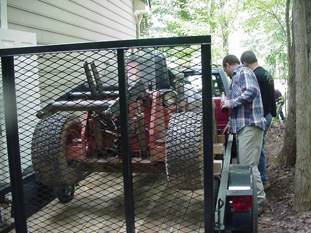

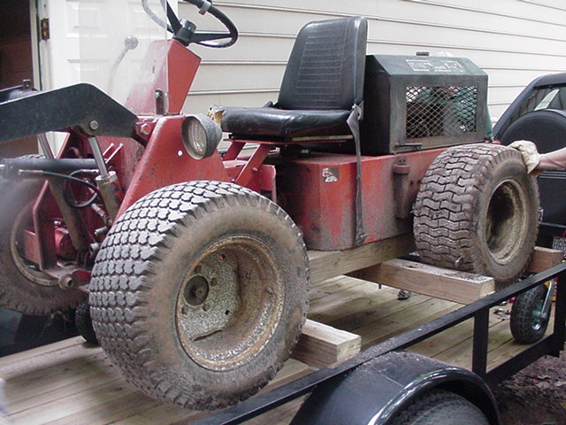

Hey guys:
Here's a few pics of the tractor on the dolly I made. It'll be on it's way to the repair shop in a few days. You can also see the new trailer I just bought yesterday (5x10 w/ ramp, 3500 lb axle, 15" tires rated for 1800 lbs each). It was quite a task to get the tractor onto the dolly, but winching it onto the trailer afterwards was pretty easy...

   / Tractor dolly #6
Curious as to why you needed the dolly. It appears the powertrac would not roll onto the trailer without the dolly. And how did you get the pc onto the dolly?
   / Tractor dolly
Beenthere, good questions.
The PT is supposed to have a tow valve which you can open and two tow ports that you hook a hose between. My model is so old, that I can't identify these, so I'm not going to risk taking the wrong plug out and damaging a $1300 hydrostatic pump. Thus, the need for the dolly. While it's at the shop, I'm going to have the folks install the fitting to bleed the pump, and also identify the tow valve and install the fittings for the tow port, so hopefully, I won't ever need to "dolly it" again.
Yes, getting the tractor onto the dolly was not an easy task. It involved quite a bit of jacking, moving around cinder blocks, etc. Got it high enough a little at a time. This probably wasn't the safest thing that I've ever done either...
