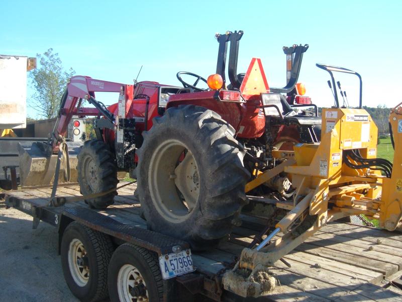

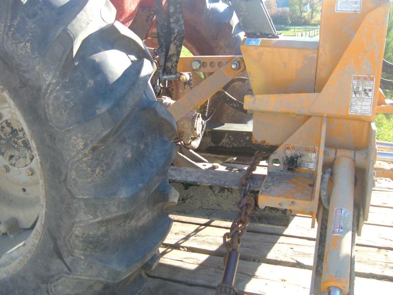

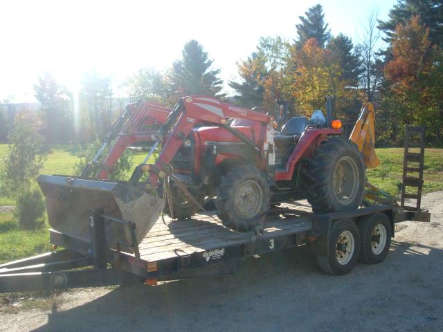

   / Tractor has new Baby
Here is a Pic.
Hi Barry,
I will attach a picture of the back end for the subframe.
I have a woods loader and the bottom frame for that may be different than a MF frame. I used 2 5"x5" H-beams front bolted to the woods under frame. At the back of the tractor I used the 1.5" hitch bar . I welded 2 3"x3" sq tube across the beams to hold up the weight of the Bh. I did notch the bottom tube so the bar would slide though. I also added 2 1.5" tubes to the top of the beams to act as a bumper under the rear axle perchases. I used the bottom mount arm on the Bh and end bolted to the H-beam. The Bh also comes with a top link connector and braces for the 3pt. that is where it belongs except I did a mod to the braces and reversed the an connected to the top of the beams. Now there is only a load on the top link tha is very light. You can still pull the pin out with all of the Bh weight .
I can send more pics if you need.
"Also do you have to take your subframe off to use the 3 point?"
Yes the frame comes off with the Bh 3 Bolts, and 2 pins.
