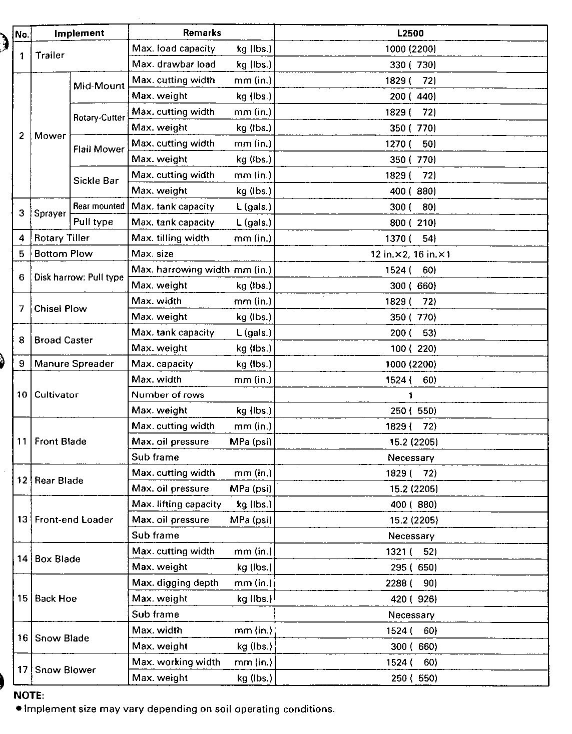

Been studying the owners manual as part of my other non tractor seat time.. ;) and thought I'd post what's in my L2500 manual. Interesting how it posts things like max weight AND width for a BB, cutters and such. How it lists a pull type disk only. And in the case of the BB, a 52" with a weight of up to 650#( I have a 60" that's about 450#). A 2200# trailer with a max tongue weight of 730#.
It doesn't change for a 2wd or 4wd. This is for an L2500, about 27hp, 2wd weights about 2000# and the 4wd is about 2350#.
Just wonder what you are thinking when you see this for your tractor.
