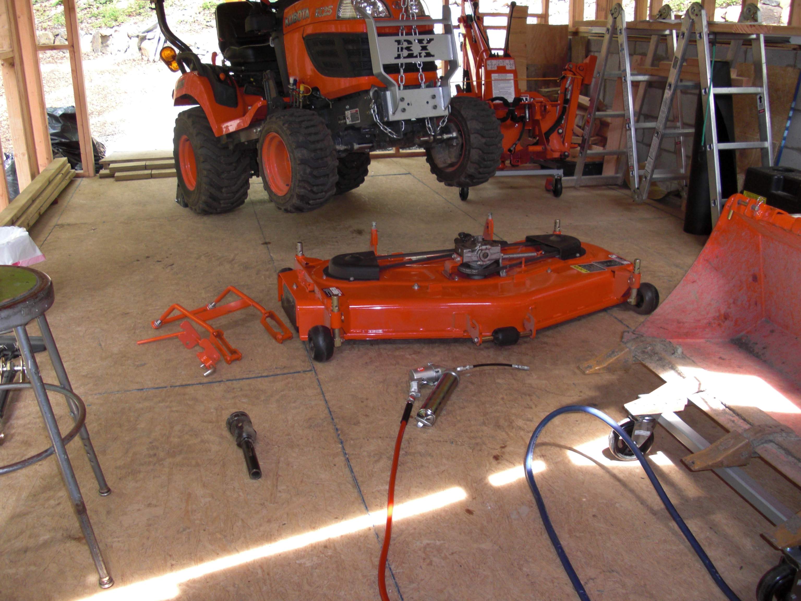

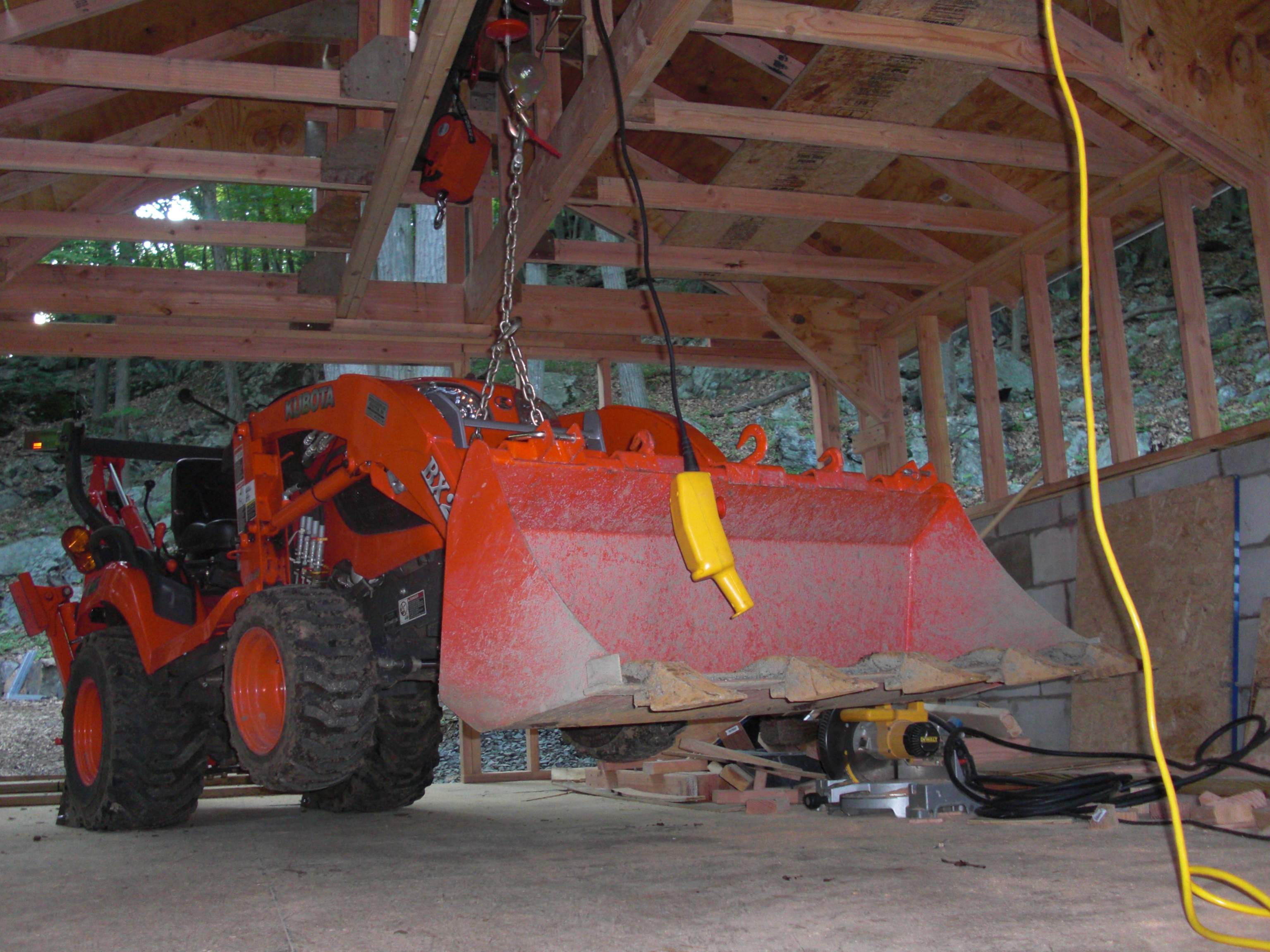

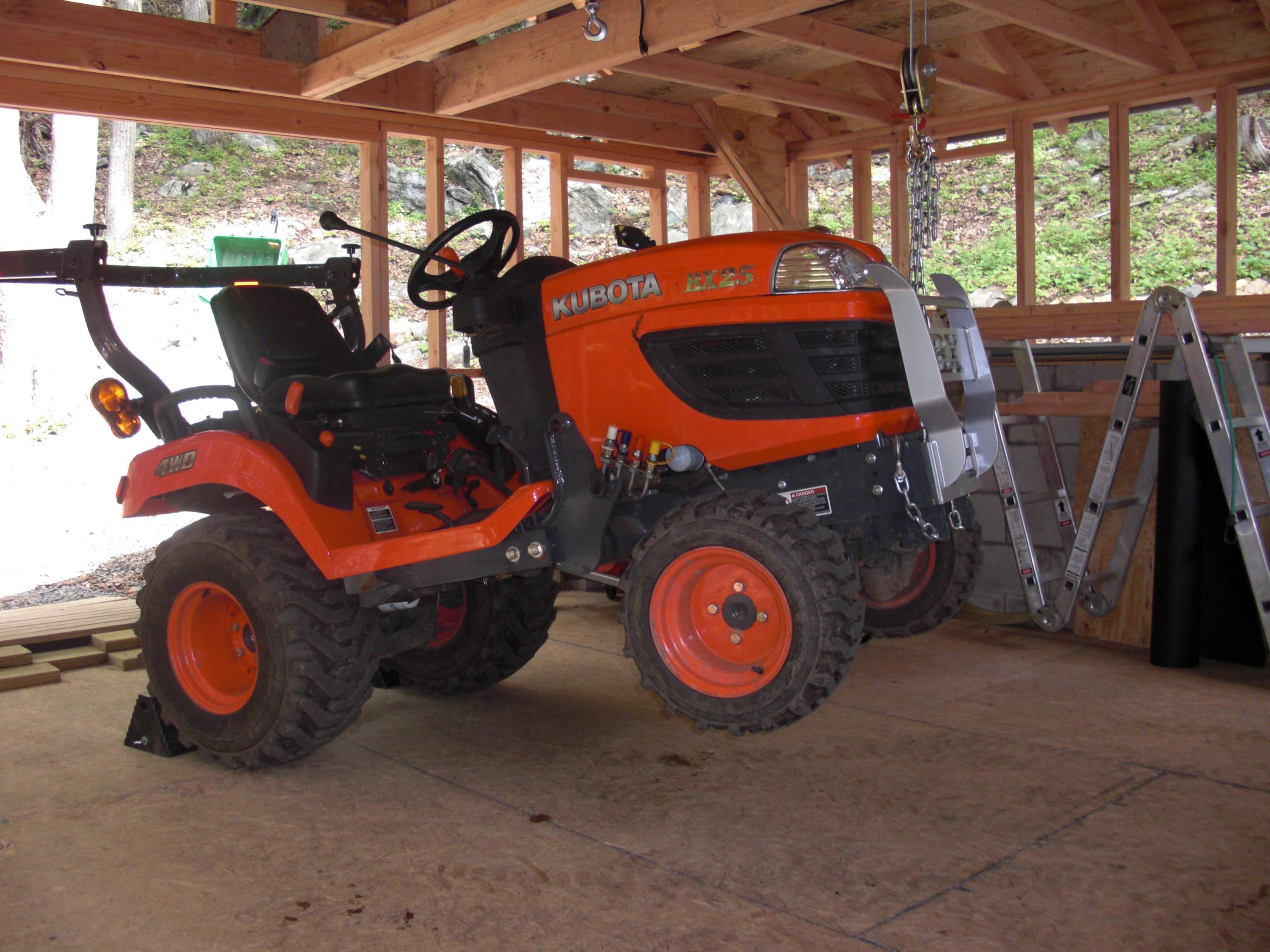

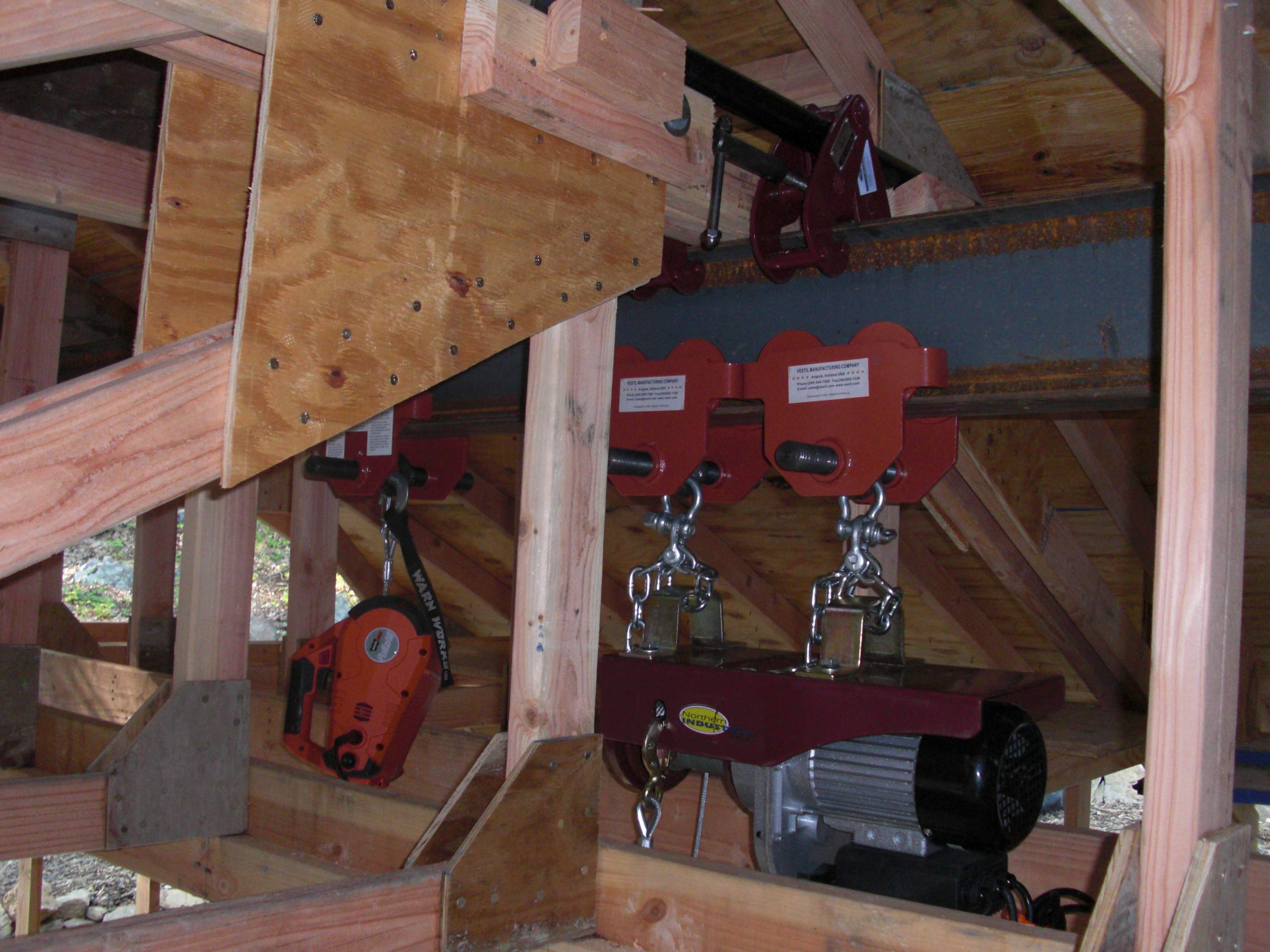

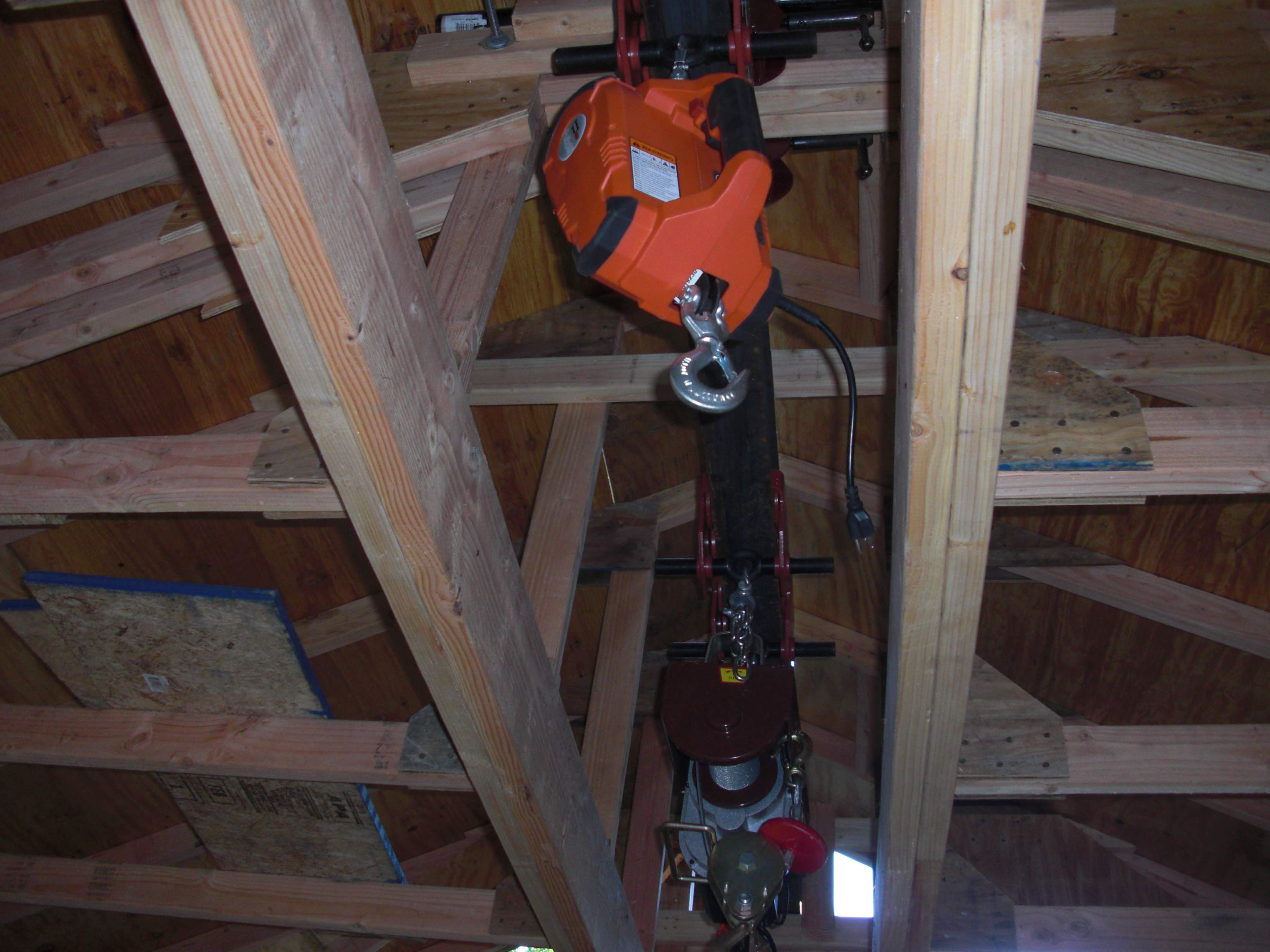

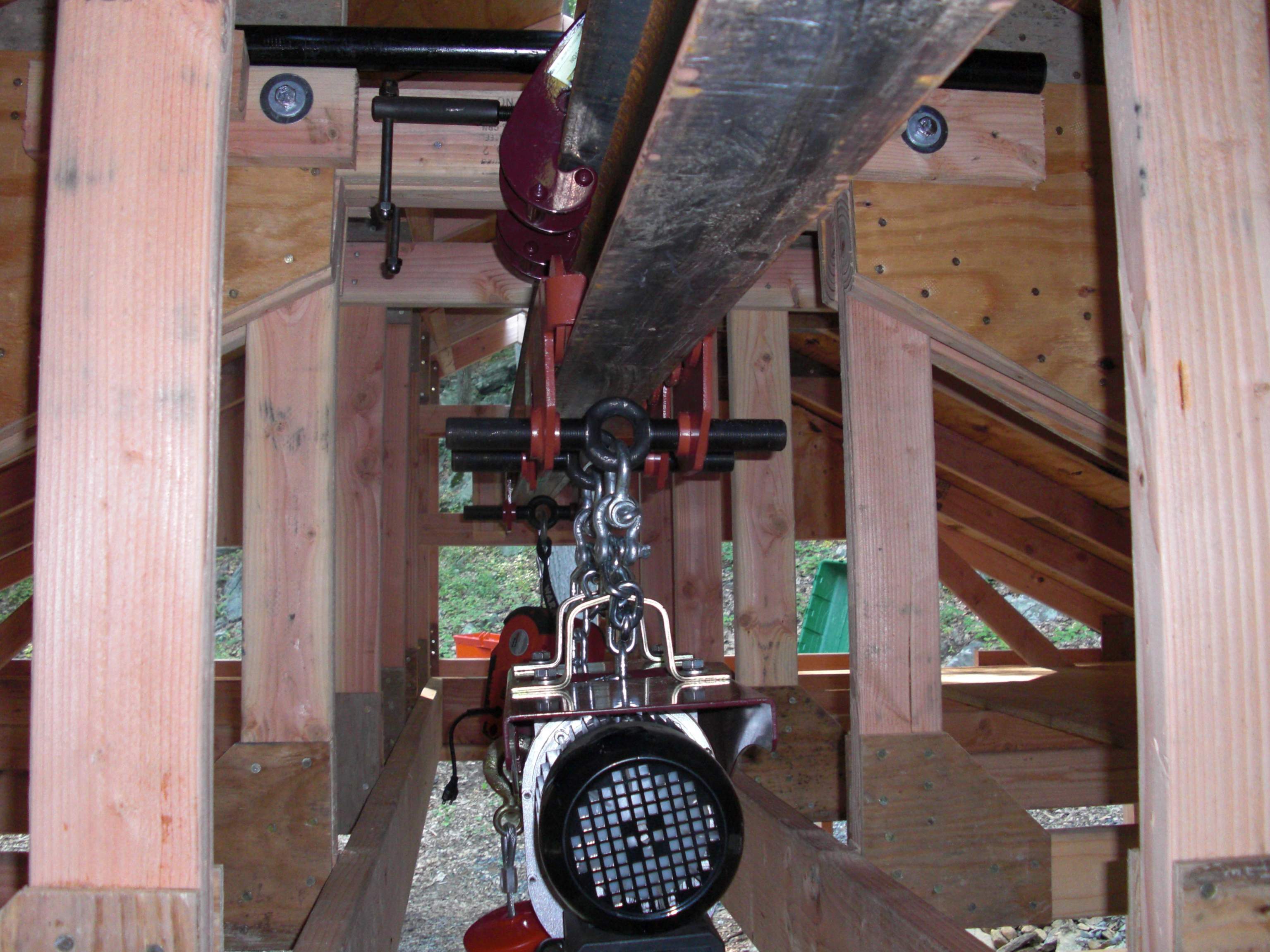

I'm having a new shed built, and a primary concern was being able to lift the front end of my BX25. Among other reasons, I prefer to roll the mower under from the front, so as not to have to change the deck wheels direction twice every time I mount the mower. Also, I wanted to be able to hoist other machinery and equipment as needed....so my builder and I decided on an i-beam & trolleys to suspend a 2,000 lb hoist from the beam. Shed is still under construction but the thing works nicely, as designed....I've lifted the front with the FEL attached with no problem....but I don't get underneath without jackstands, no matter.
If your shed or garage is sturdy enough, I'd suggest you consider a winch or hoist, and that way you can have it for lots of other uses.

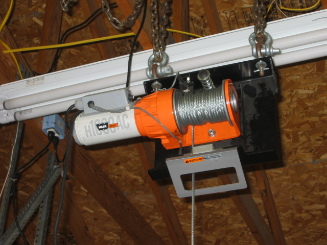

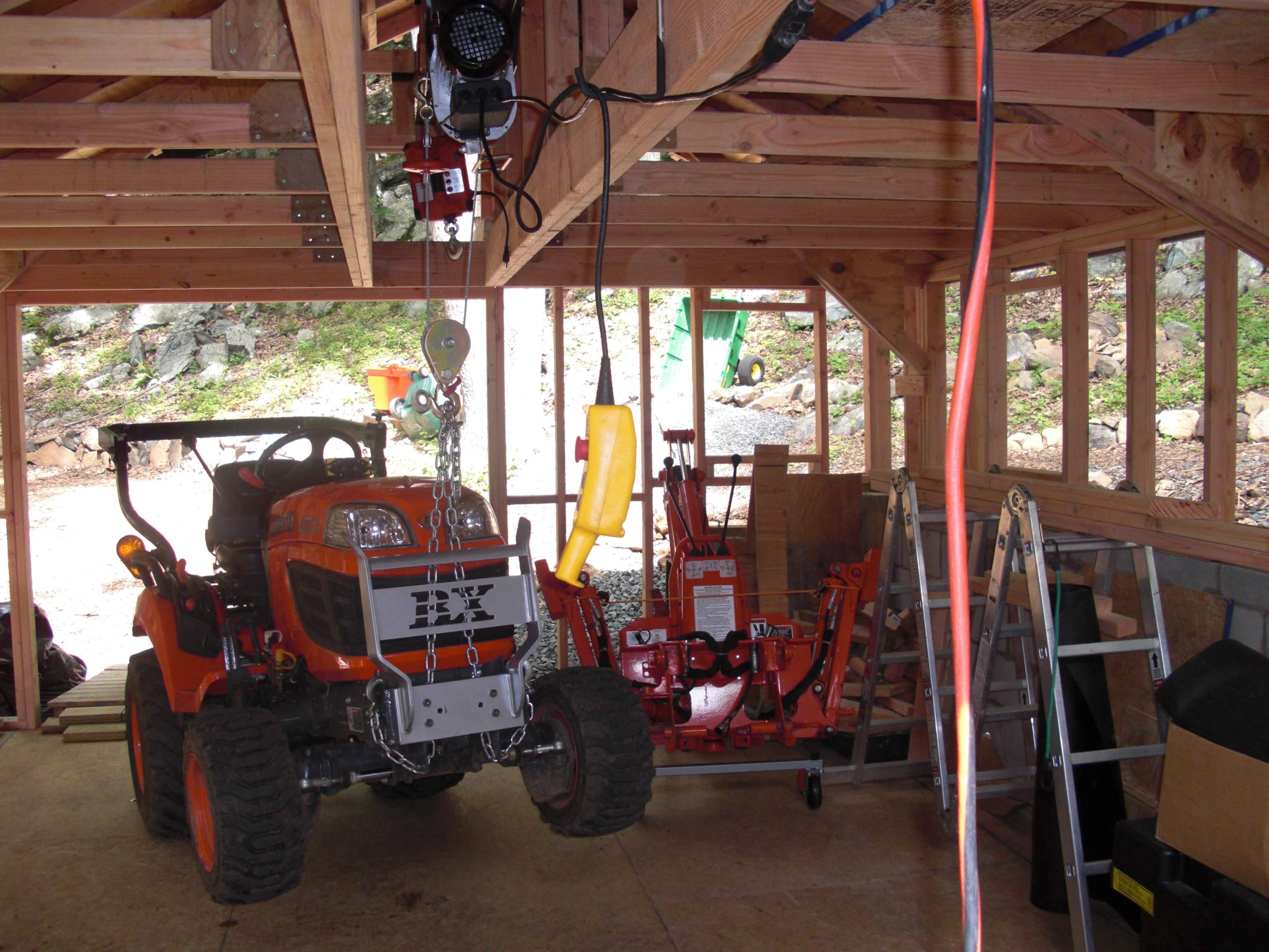

Warn hoist does it for me.
1000# lift capacity

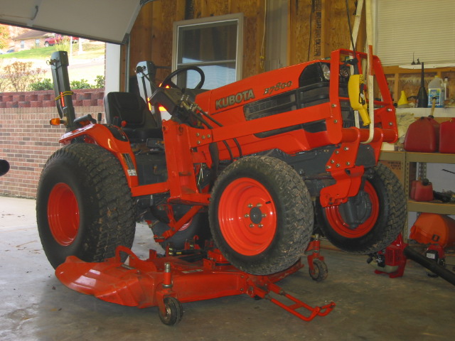

The pictures in this thread show an angle of lift that I can almost achieve just by driving my mower up on the ramps of my trailer. I can drive it up onto the ramps to service/clean under the deck.
