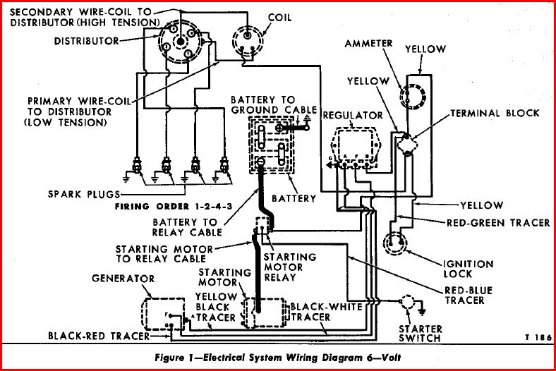

I have a MF255 1975 model and a ford 850 that belonged to my father in law. I have to do the drakes on the Massey and I just got a new wiring harness in the mail today for the ford 850. I'm searching for a schismatic for it.... I love tinkering with old stuff....

as you can see, the old ford wire diagrams are almost point to point and very few circuits.
just get the ones on the vreg correct and the rest pretty much fall into place.
