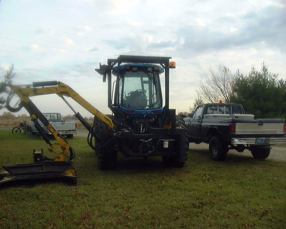

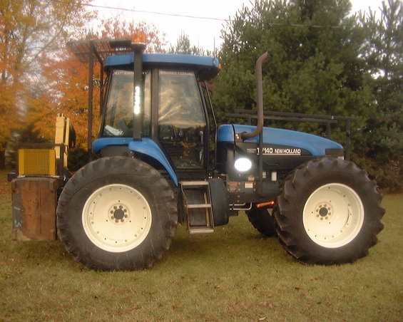

Tiger and Alamo is what we ran at the road commis.
The weight of this one actually cracked the rim, and we made a custom HD one for it.
That was our big mower used for steep or knocking out overhanging tree bracnches.
The other mowers we ran just a pivoting side mount, not on the boom. Check in the contracts you are looking at to see if to meet requirments that you need a brush hog or flail.
Some of the contractors they hired around us use flail, and avoid any brush, they do a worthless job. The whole point of them in our county is to mow at least 5-6ft off the road, or larger for primaries. Not to go around little sticks.

I talked to on of our local road guys about this, as stated, the weight breaks tractors so they put the mower on a track hoe.

Our county was running big NewHollands but now running Deere. I suspect both do the job and it is a matter of low bid. They pull large rotary cutter with a wing that lifts.
The maintenance, regardless of brand, has to be the big item here. Be prepared to cover all the cost of new equipment every year, and then hope it isn't that expensive.
