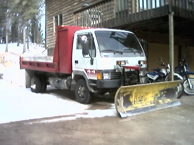

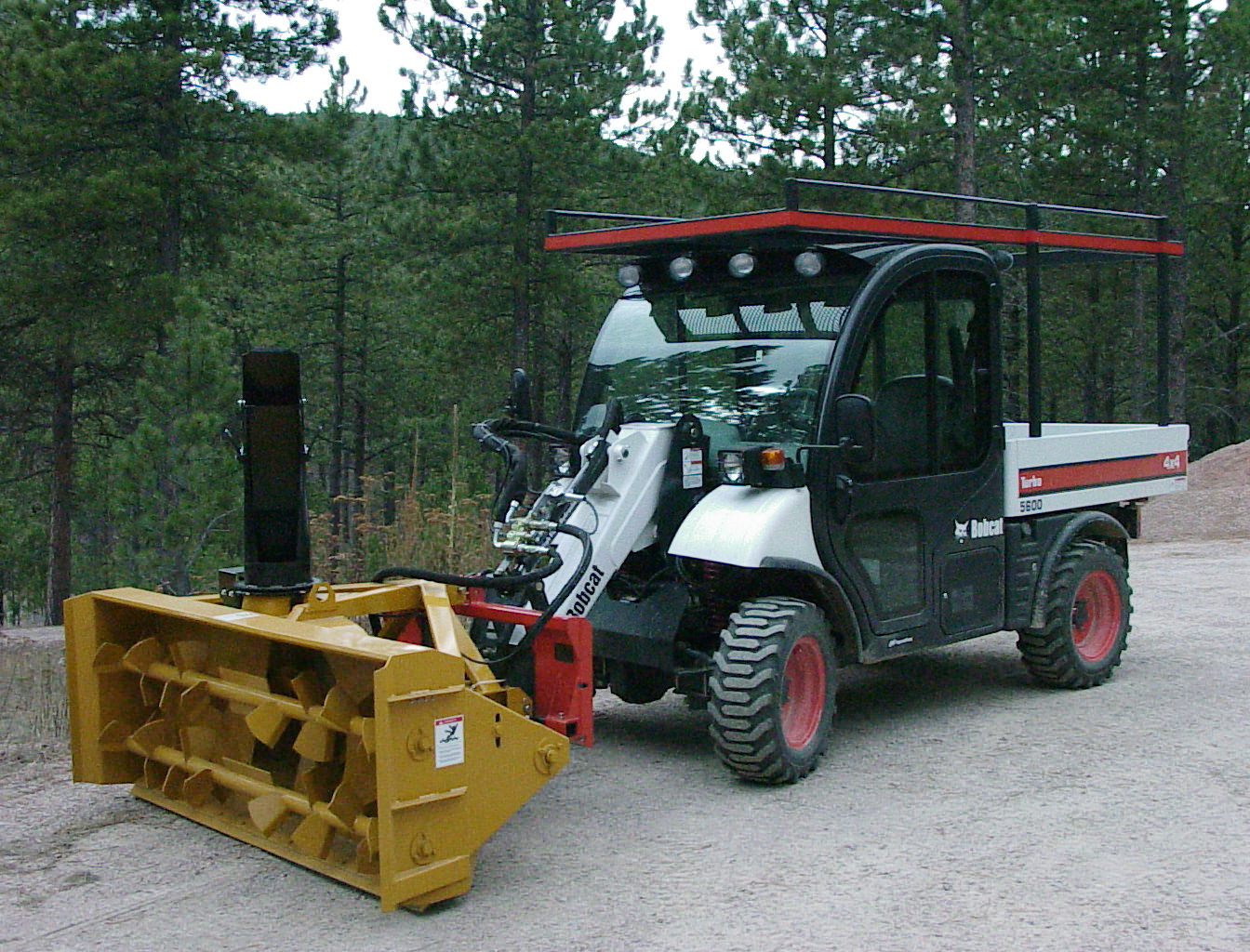

Tools should match the job. Plowing roads & drives - scale the truck and plow. No ditches, have to remove the snow (parking areas) - loader or blower. Warm gravel or dirt (1st or last snow) - blower or bucket trumps blade.
