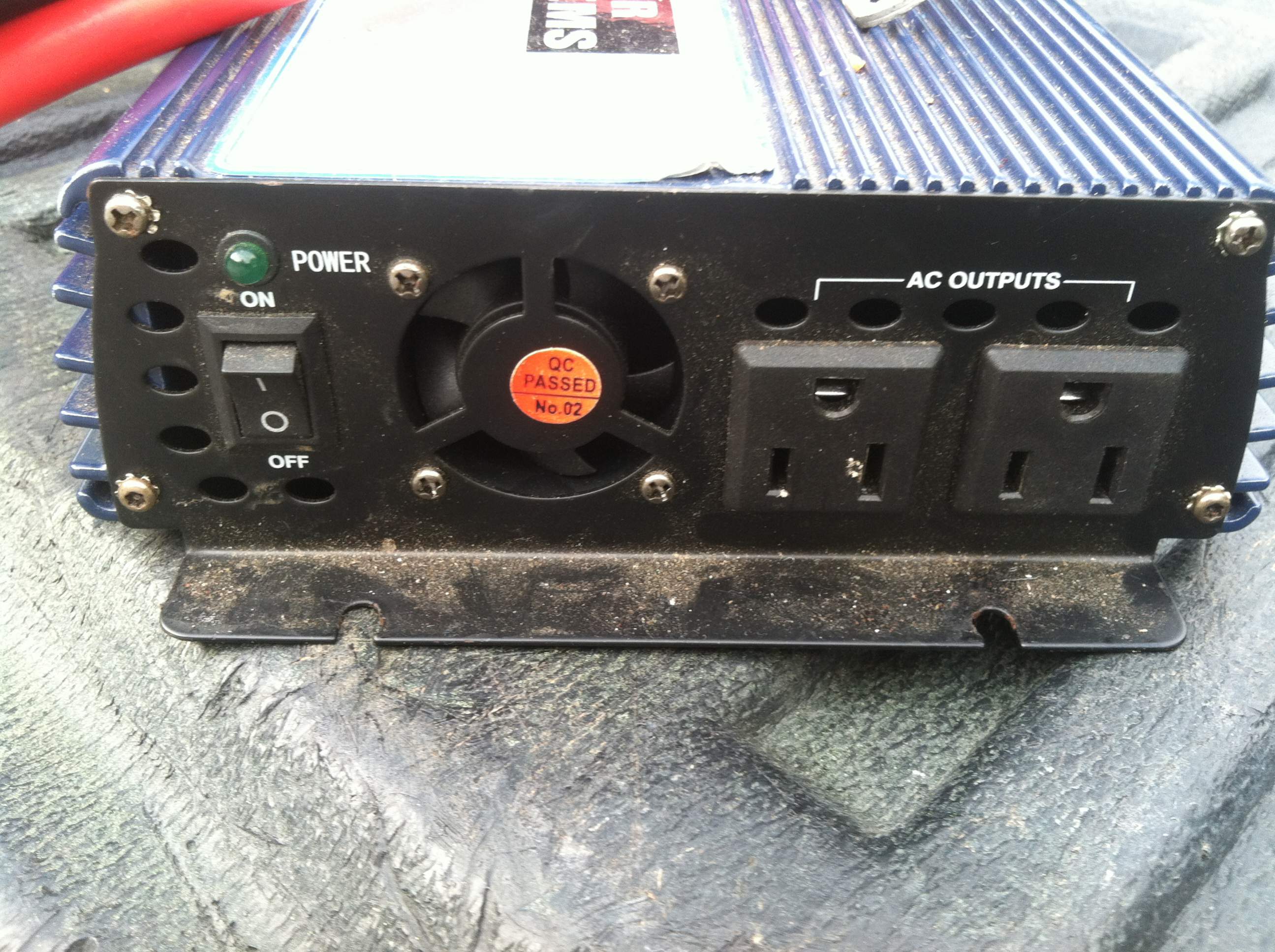

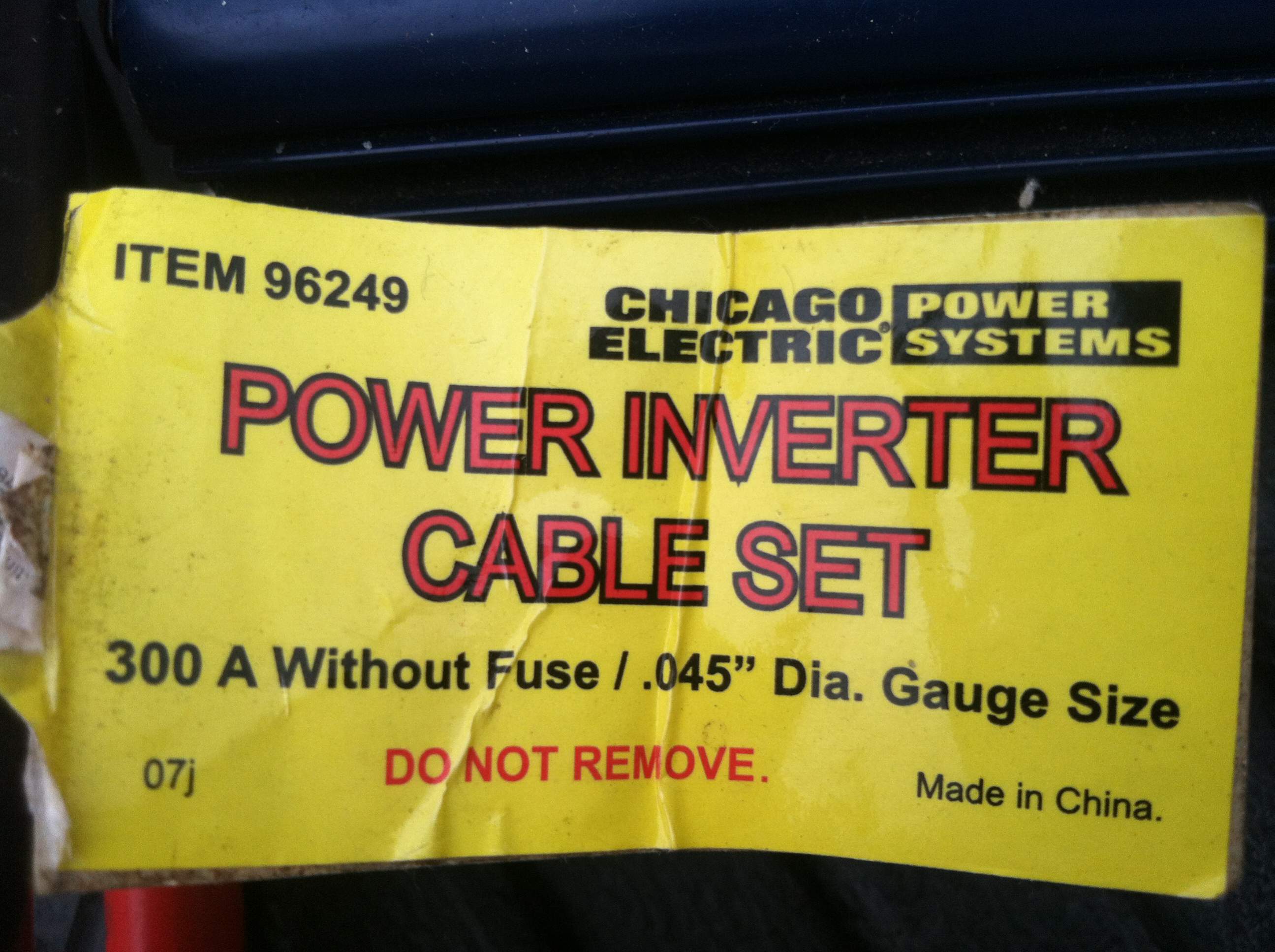

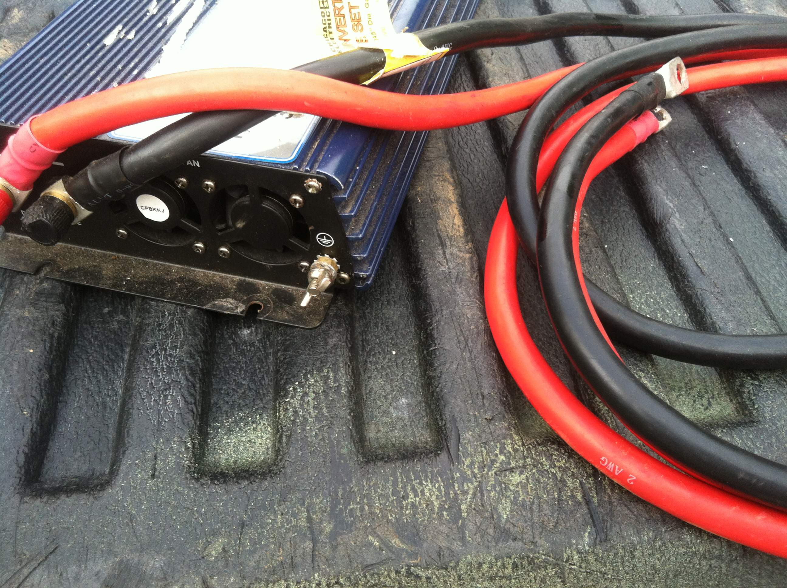

I have a few inverters and this one is a Harbor freight model 2,000-4,000 watts That I hook to the tractor battery when needed just using a couple pairs of vise grips using heavy leads and it has run anything I plugged into it . No need to mount it for the small amount of time it's used . I've had this one for years and they work good ,I have found that making sure there is no load when attaching or removing them seems to make them last forever ,Make sure you unplug anything before disconnect and have the switch off seems to work for me ,Also try not to use long extension cords . 003.jpg002.jpg

I have a few inverters and this one is a Harbor freight model 2,000-4,000 watts That I hook to the tractor battery when needed just using a couple pairs of vise grips using heavy leads and it has run anything I plugged into it . No need to mount it for the small amount of time it's used . I've had this one for years and they work good ,I have found that making sure there is no load when attaching or removing them seems to make them last forever ,Make sure you unplug anything before disconnect and have the switch off seems to work for me ,Also try not to use long extension cords . and yes this will run a large battery charger when you need 200 amps to jump a larger machine .View attachment 331946View attachment 331947004.jpg
