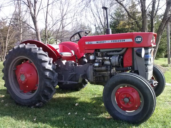

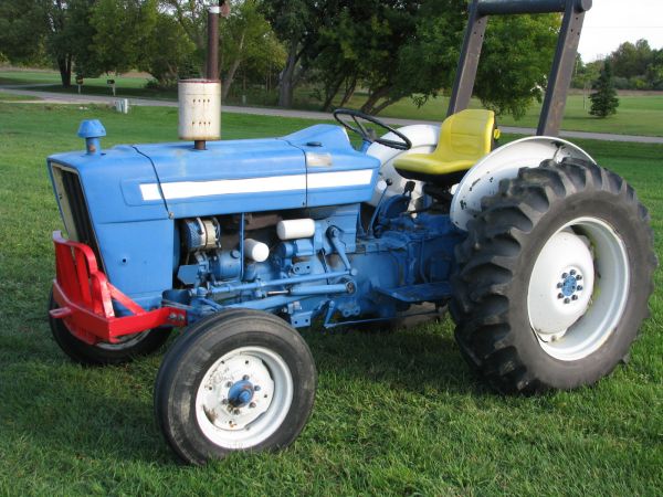

OK guys, found a couple tractors that seem to fit my criteria. Share your thoughts, both in terms of reliability, potential repair cost differences, functions/features that are good bad, etc. Basically do you feel these are a good match for me and if so which one and why.
MF130 Perkins Diesel 2100hrs well maintained in very good condition(their words, not mine), 4spd hi/low trans, live power, pto, newer tires and battery, tool box, extra lighting, $4900
Ford 3600 3cyl diesel 4200hrs, 8fwd speeds/2rvs, tires and rims are good(not loaded). He replaced a tube in one rear, water pump new 2yrs ago, injector pump rebuilt 2yrs ago($1800), 1 remote out back. $4500
thanks,
Ken
