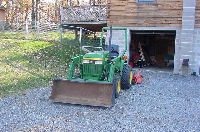

"Originally I was looking for a tractor in the 25-30 hp range, but I quickly came to the conclusion that a smaller unit would do the work I needed. There is also no way I could afford the $$$ to buy the bigger units."
Maybe you should look used instead of new. A JD 770, 870, 850, 855, 950 or 955 would be 20 to 30some PTO Horse Power and cost you right around what the 4100 would go for (looking at the 1987 to 1995 tractors). I'm just noting the Deeres because I know those models...I don't know the older Kubota's, NH or Fords.
There is some really nice machinery floating around that would probably suit you quite well...better, perhaps, then a new machine with less HP.
I run a 1991 Deere 670. Had 600 hours and came with a FEL, 4WD and a practically new Befco C30 60" finishing mower. This machine wouldn't be big enough for your needs but it is right in line with the power output of the 4100, TC-18 (or TC21) and the B7500. This machine cost $8500 and was financed through John Deere (at a higher interest rate, of course).
Runs like a champ...
<font color=red>I always believed in you're better off buying used equipment that can do the job then new that can't</font color=red>
