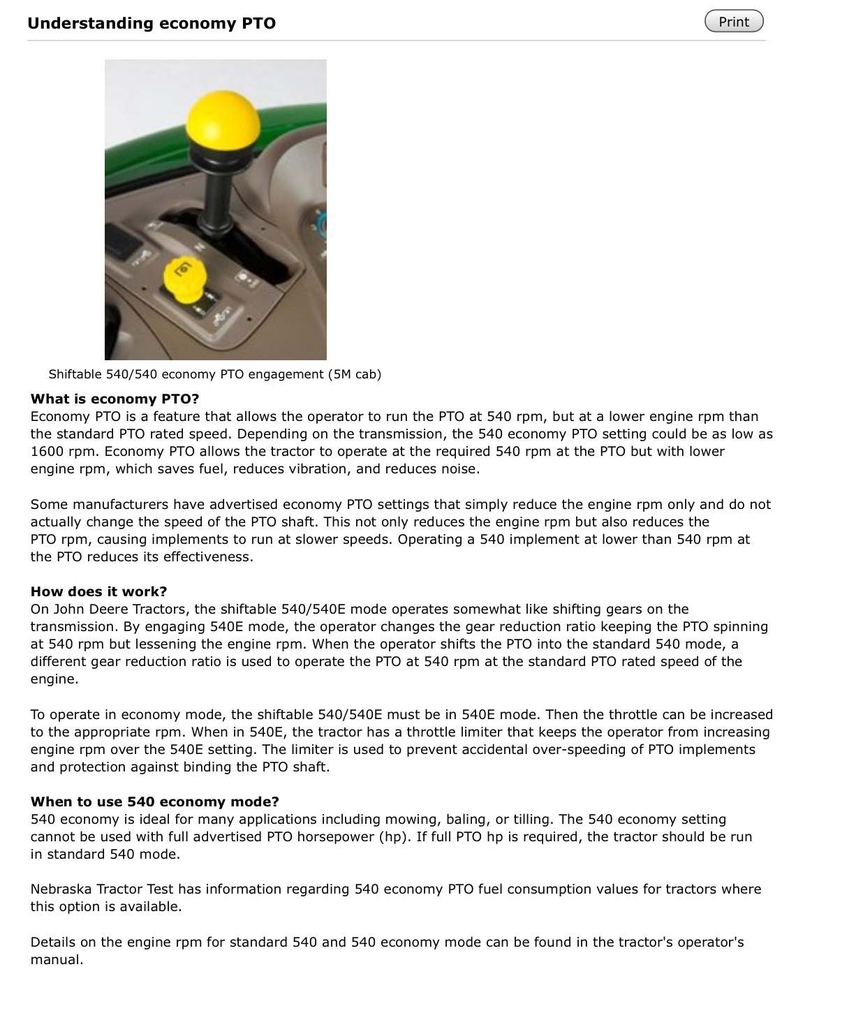

I do it all the time to save fuel. Here is John Deere's explanation:

The efficiency of an engine varies throughout its RPM range.
It's quite possible that an engine will require less fuel to do some amount of work at 1500rpm than at 2100rpm - obviously it's doing the same amount of work in both cases; it's just taking less fuel if it's being more efficient.
This is the idea behind cars with CVT transmissions - you run the engine where it's the most efficient for a given load, and you adjust the transmission to suit. In fact, it's the idea behind having a transmission, even geared ones. My motorcycle can do 60mph in first gear, but it's a **** of a lot more efficient to cruise in 5th or 6th gear at 60mph. Same amount of work done (at least, same amount of work put to the road - it's obviously generating a lot more engine and transmission friction along the way).
What the OP is doing is using the alternate PTO speed as a different gear; it's basically another transmission. The fact than many tractors consider 750/780/1080 rpm PTO speed as "econ" points directly at this. If you don't actually need the potentially higher power of 2100 (or whatever) RPM, use the lower speed range and save fuel.
My tractor's tach shows a range to use the "ECON" PTO setting, and another for using the normal 540 - the PTO will spin 540 in either case, if I've got the lever set right for the RPM range.
