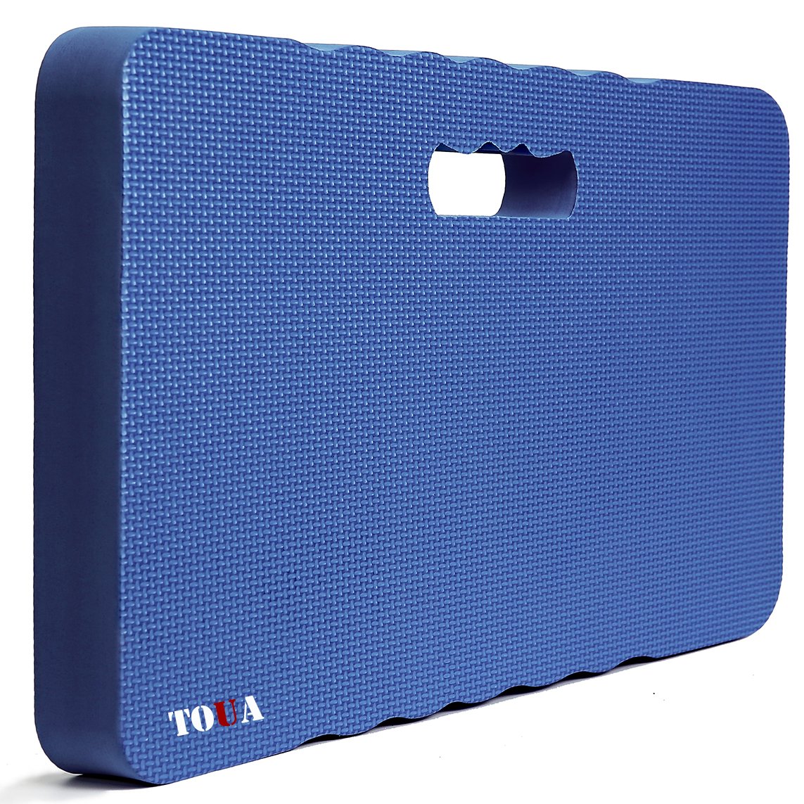

I have a hard time visualizing a seat being 3-4" too low for a 5'-11" operator, but you can perhaps buy on of those gardener pads to get the seat firmer and raise it up to see exactly how to adjust. https://www.amazon.com/Kneeling-Pad...ocphy=9023860&hvtargid=pla-350442720391&psc=1 81BfiUvMH3L._SL1143_.jpg
