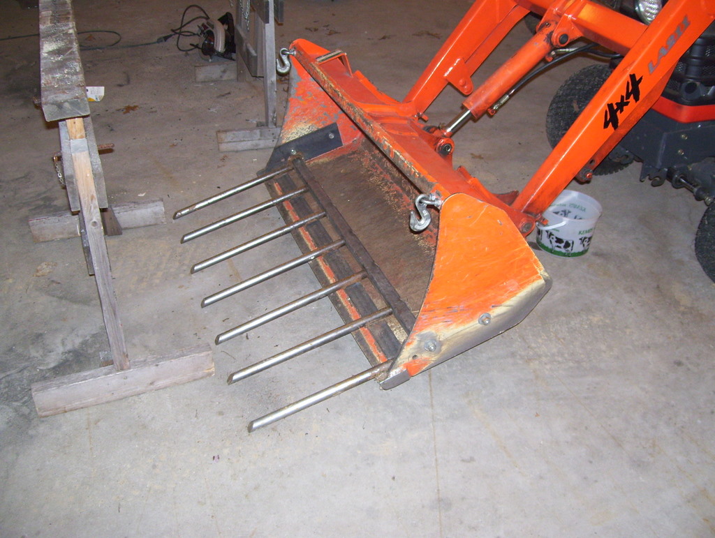

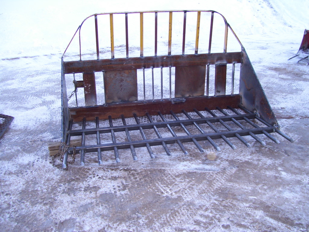

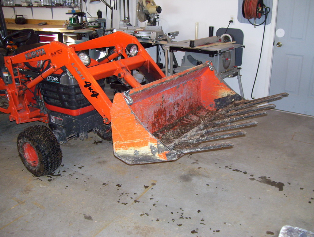

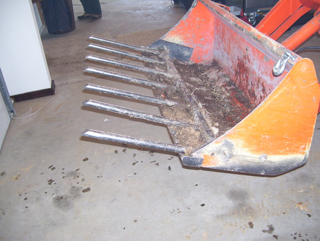

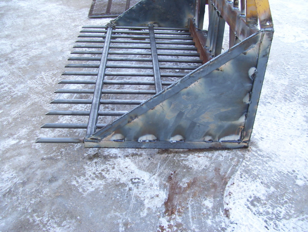

I use a tine attatchment on my bucket to help get under the wood pile and carry more wood.
I may not get a real full load each time, but I'm not handling by hand. If I made another one, I would put tines a little closer together. I also built a full firewood bucket for skidsteer for my nephew that works quite well. The whole bottom is tines so dirt falls through.

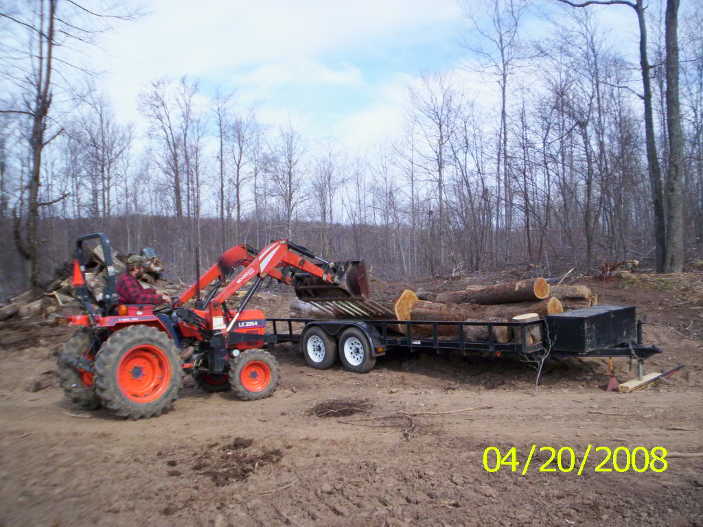

I built one to works good loading logs or wood chunks.
