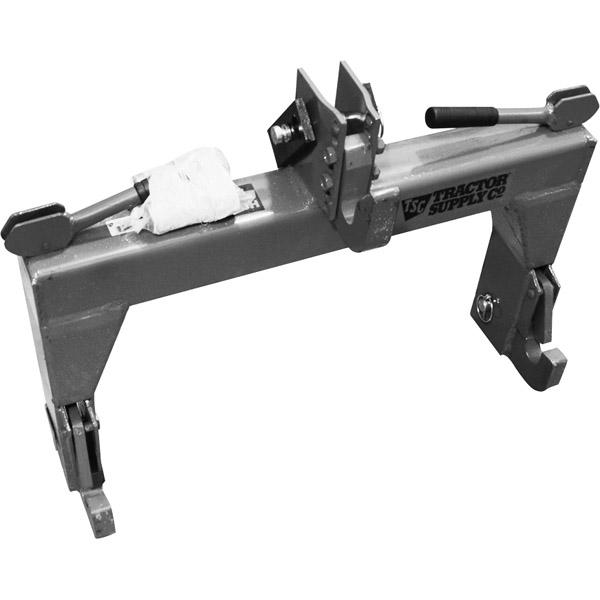

Does anyone have a speeco-Tractor Supply-Northeren Tool Cat 1 quick hitch and know the exact measured distance between the inside of the lower hooks. Cat 1 is supposed to be ~26" but most of my stuff is more like 27". See the attachment.
My local TS does not have one in stock to "measure".
I'm not worried about the top pin height. Mine varies all over.

You're in luck! I was looking at one a couple weeks ago and measured it. It was a Cat 1 hitch at TSC, just like the one in the picture you attached.
Distance between the inside of the lower hooks is 27 1/16"
Distance to the outside of the lower hooks is 29 5/16"
Distance from horizontal line between the lower hooks to the top hook (in the position it was shipped, which is in the center) is 16 1/4". It could go up or down a couple inches.
