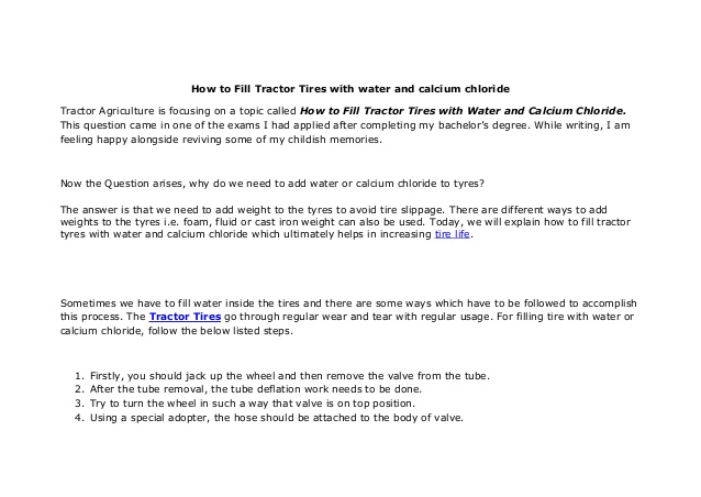

In this chart 75% is described as filled just above the rim with the valve stem at the top, and 40% fill (half the weight of a 75% fill) is with the valve stem at 4:00 o'clock.

Some directions on filling
Here's an Ingersol-Rand filler device.
   / Tractor Tire Water Ballast Weight Chart #4
I used the garden hose adapter from TSC and some fittings to adapt it to a 15 gallon sprayer tank and just dumped the fluid in the tank and every few gallons shut if off and purged the air. I am sure i came out cheaper than that device!!!!

The climate here doesn't need antifreeze so I made this garden hose to tire adapter. I removed the nub in the tire adapter that opens its check valve, since with the Schrader valve removed from the tire there's nothing to push on the nub.
Caution, your house water pressure is greater than the tire is rated for. A couple of times per tire, rotate the tire stem to the top and 'burp' off the excess air pressure.
