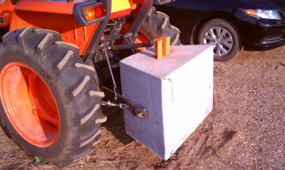

minimal time.. and yes.. i cast my own weights in various sizes and applications.. rear, hanger, wafer, dead ballast..e tc. wheel weights are no different.. and you can pour in place using the tire rim and visquine, some carriage botls and nuts and small rebar or heavy brace fence wire..
lay rim down. lay plastic down put carriage botls in/thur plasic and nut in place with heads sticking up into cement area.. use whatever you need to shape the plastif to make a form you want.. then pour.
I've seen guys make weights with 5g buckets that stick our the side of their tractor wheels.
it's not hard.. and is so cheap it's funny...
in this economy.. we all probably got more time than resources.. unless you are just plane rich.. if you are rch.. sure.. go buy some and pay someone to put them on.. then pay someone to use the tractor..
here are some links to some cast weights i made for my 4600.. these happen to be bumper weights.. but shows the easy process..
