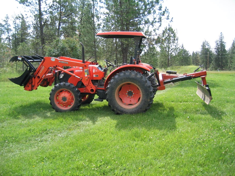

I've had two tractors. Both were purchased brand new. Ford 1700 4WD in 1982 when we moved onto this property. And now - Kubota M6040 - purchased in 2009. I traded the Ford in when the Kubota was purchased.
One of the prime reasons for the larger Kubota. I needed more weight to maintain my mile long gravel driveway. I also had completed all the smaller projects and wanted to move on to the larger ones.
Both tractor were/are four wheel drive and have/had the FEL attachment. Right now I have a very HD grapple on the Kubota FEL. It was installed - along with the WR Long third function - by the dealer. That was nine years ago and I've not had a reason to remove it.
I have 80 acres. If my tractors did not have 4WD - they would just be a more or less useless lump - sitting in my yard. So...... the M6040 has a grapple on the FEL and a very heavy Rhino rear blade on the 3-point.

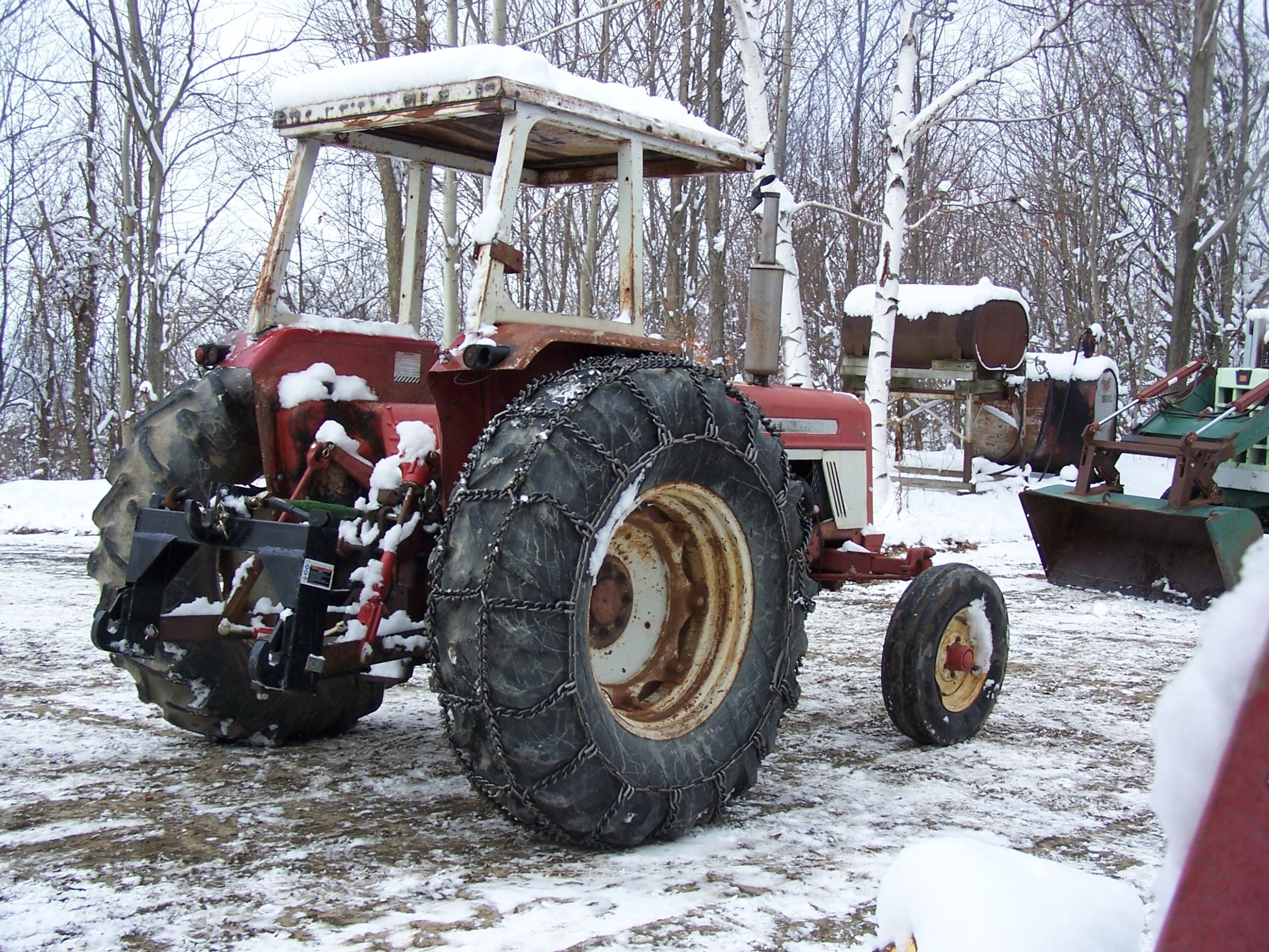

Repairing a broken 4wd tractor is going to be a hit or miss proposition. Of course I will also disagree with many on here a mid sized 2 wd tractor can do much of what may be needed.

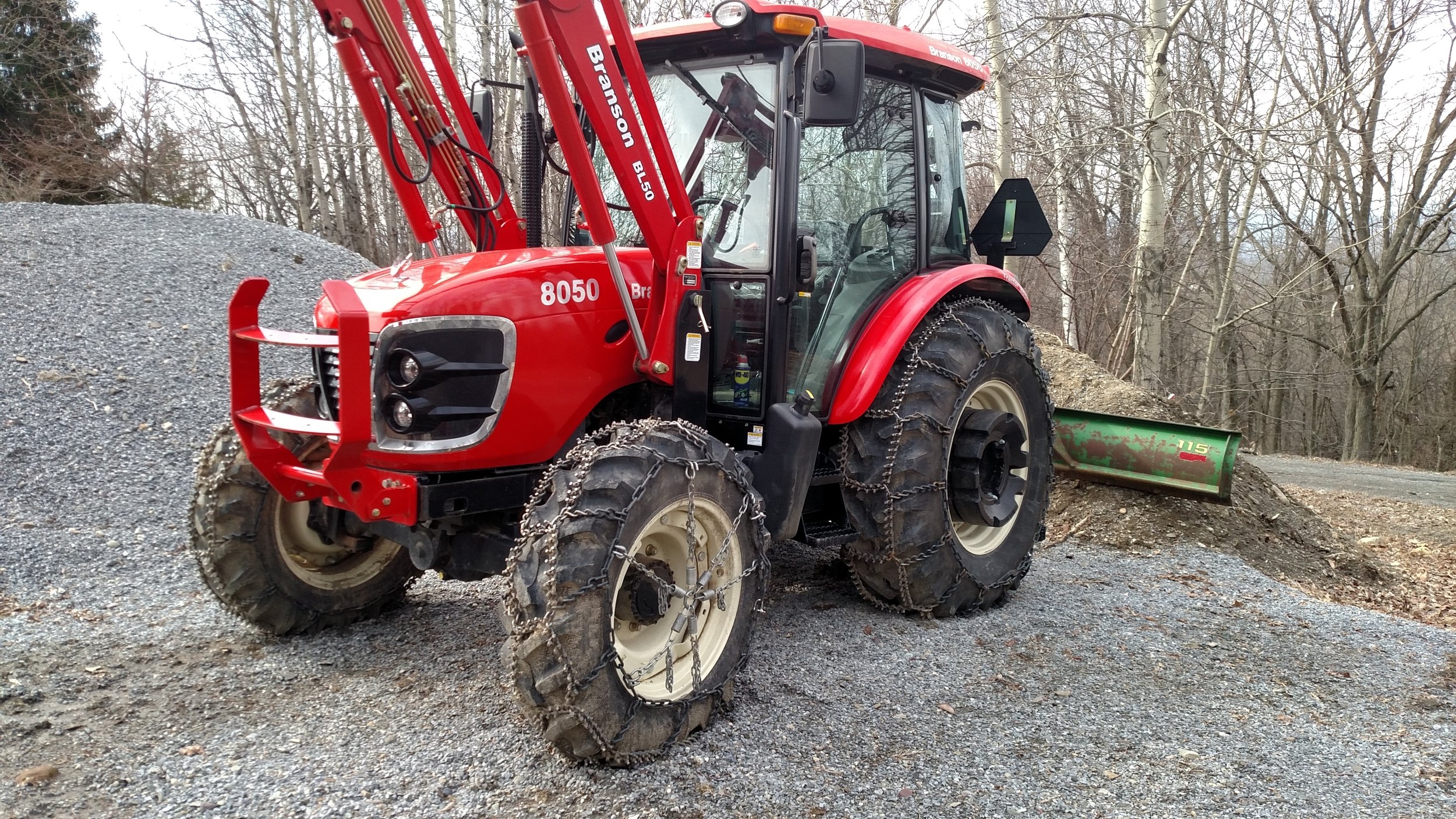

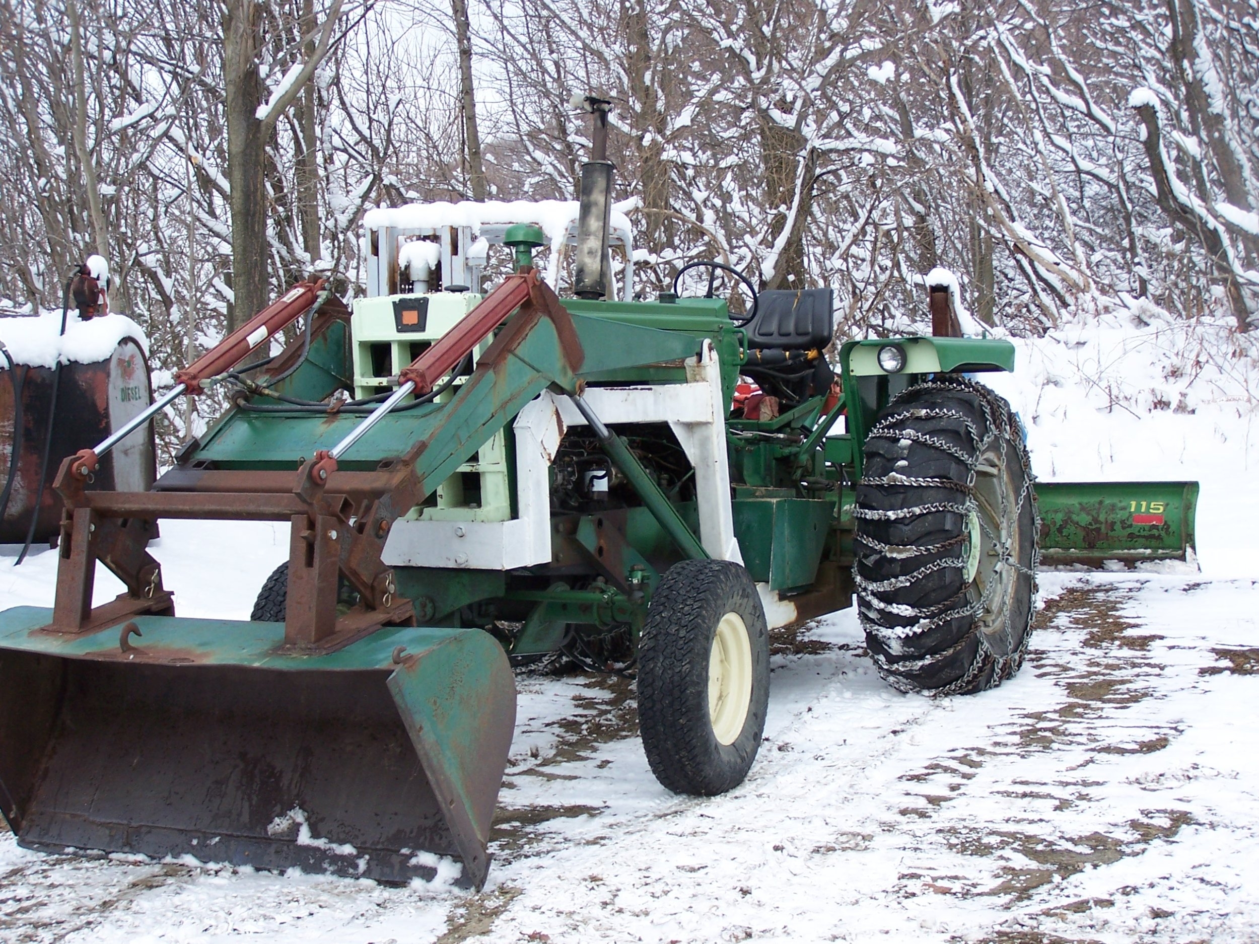

Our first tractor with a loader was a 2wd Farmall 400 with a John Deere trip loader adapted to iit, a narrow manure tine bucket with a slide on pan to make it a scoop bucket, single acting lift cylinders and you pulled a lever to trip and dump the bucket, at times you could relatch the bucket as it swung back otherwise you lowered it while backing up to latch the bucket and go again.
My first tractor on my current driveway was an Oliver 1550 2wd with a hydraulic loader. With chains and ballast she could do what I needed to as far as grading the driveway you did have to work it downhill as at 14-16 degree of slope you couldn't move much material up hill. It did take a while to get things done that a 4wd of the same size would have breezed through and I did borrow or rent 4wd's a few times to get a project done. And when the 2wd got stuck it was a bear to recover, especially if the front tire or tires had gotten over the edge of the driveway and it had to be pulled back and up.
At this time I do have 4wd tractors for most of my work as it is usually easier and faster. That said a 2wd with chains can be a very capable tractor.
Gone now,
Still here and usable,
What replaced the Oliver 1550,
ready to assit when needed,
and the latest acquisition, for the little jobs.
But I would not be afraid of an older 60-100 hp 2wd tractor with good ballast and chains to do a lot of snow removal and gravel grading. Much less money and easier to work on and repair.

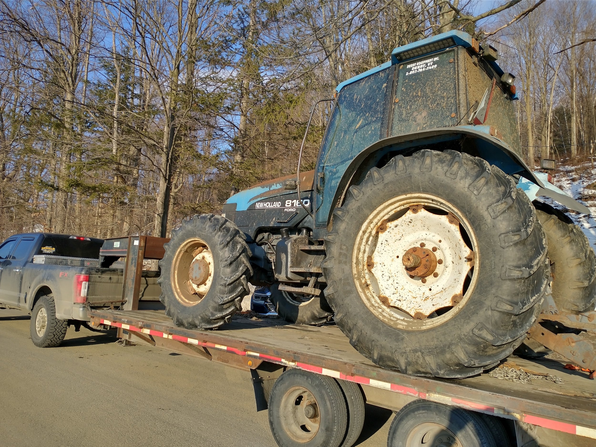

The guy who picked up the 1210 for me has a Ford sitting in his shop taking up space because the parts needed to put it back together are not to be found.
You are better off not trying to fix a front axle and just run it as a 2wd. However that is what he tried to do, and a front hub part sheared, which made it a hanger queen.
