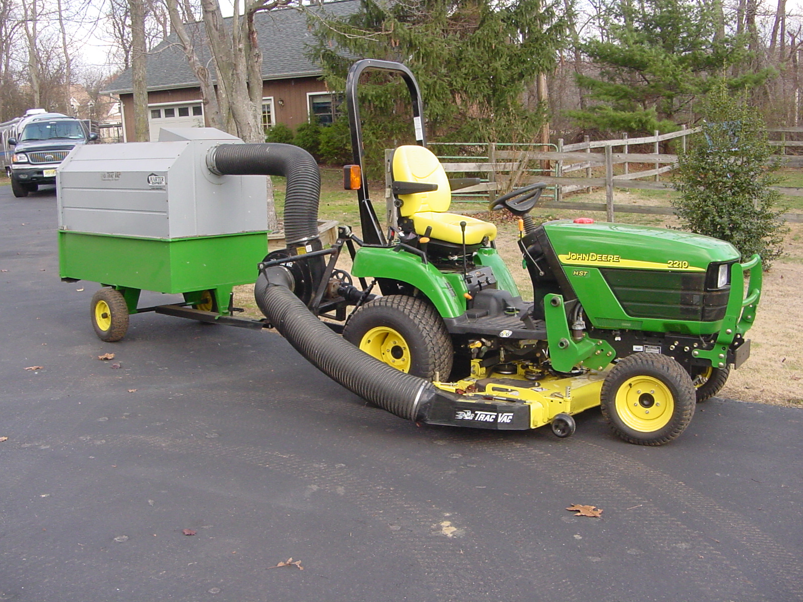

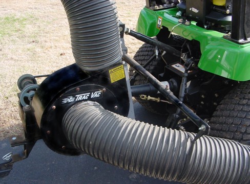

Chevy
I'm running a model 854 3 pt. rear pto driven TRAC VAC on my 2210 and it works great. You don't need the independent lift to run that unit.

Lobo56,
That is the setup I want to get. I was told that I could not raise the 3 pt high enough to raise the deck with the blower mounted & the PTO attached.
It seems I was told wrong.
Have you had any problems with this setup? Does the tractor have plenty of power to handle that seup?
Thanks.
Chris

You need to order the 3” drop hitch for the back of the blower unit, if I remember its 30 something dollars. That way you don’t need to lower the blower unit down so low and the cart will ride level to the blower unit. You set the mower deck to 3 or 4 on the deck height setting and lower the deck till it just stops dropping. You can’t run the mower in float, but I have never had a problem with that. If accidentally put it in float you will only drag the blower hitch on the ground. The 2210 has plenty of power to run the unit, you need a minimum of 15 hp at the rear pto which you have. This thing can really vacuum leaves & acorns of the ground. If anything you have to much 3pt lift.
