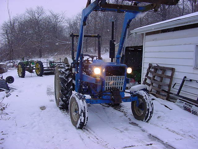

The new one is waiting on the quick tach bucket to get in . Dealer threw the quick attach bucket in that takes skid steer attachmnts... Here`s ole "fred" soon to be replaced. This 4000 hasn`t been fazed during the grueling work I have put it through.

Hey! Ol' Fred has a hitchpin holding his loader together. /forums/images/graemlins/smile.gif

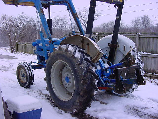

Thanks for the info on the bucket. I hope I will find out tomorrow AM if my quick attach bucket will be a heavy duty unit. The original setting on the showroom had the predrilled holes. We struck a deal when the dealer agreed to "throw in" the quick tach bucket. Since then I have awaited the hardware and the different bucket which as of 01300hrs 2/21 it is in. My sales guy is in route from Daytona returning from the 500. I had not even considered there may be a different grade bucket if I went to a quick tach. Yes ,the memories of "Fred" pulling the 84" Gill double roller pulverizer in third low running a straight pipe in close quarter residential as we are finishing off another lawn prepared to have new seed & fert drug in.That 3cylider gas could really bark. I will miss that, along with weeds higher than the hood being eaten by the Rhino 6ft rotary mower using every pony Fred could muster on a hot muggy day. Hopefully "Frankie" will "handle "similar missions assigned from the operator seat.

I think all quick-attach buckets are heavy duty. The std. duty buckets I've seen are all pin-on buckets. If you have a quick-attach bucket coming, I don't think you have any worries about it not being heavy duty. All you have to worry about is all those additional implements you will want to buy because it's so easy to change out with a quick-attach FEL. /forums/images/graemlins/smile.gif
