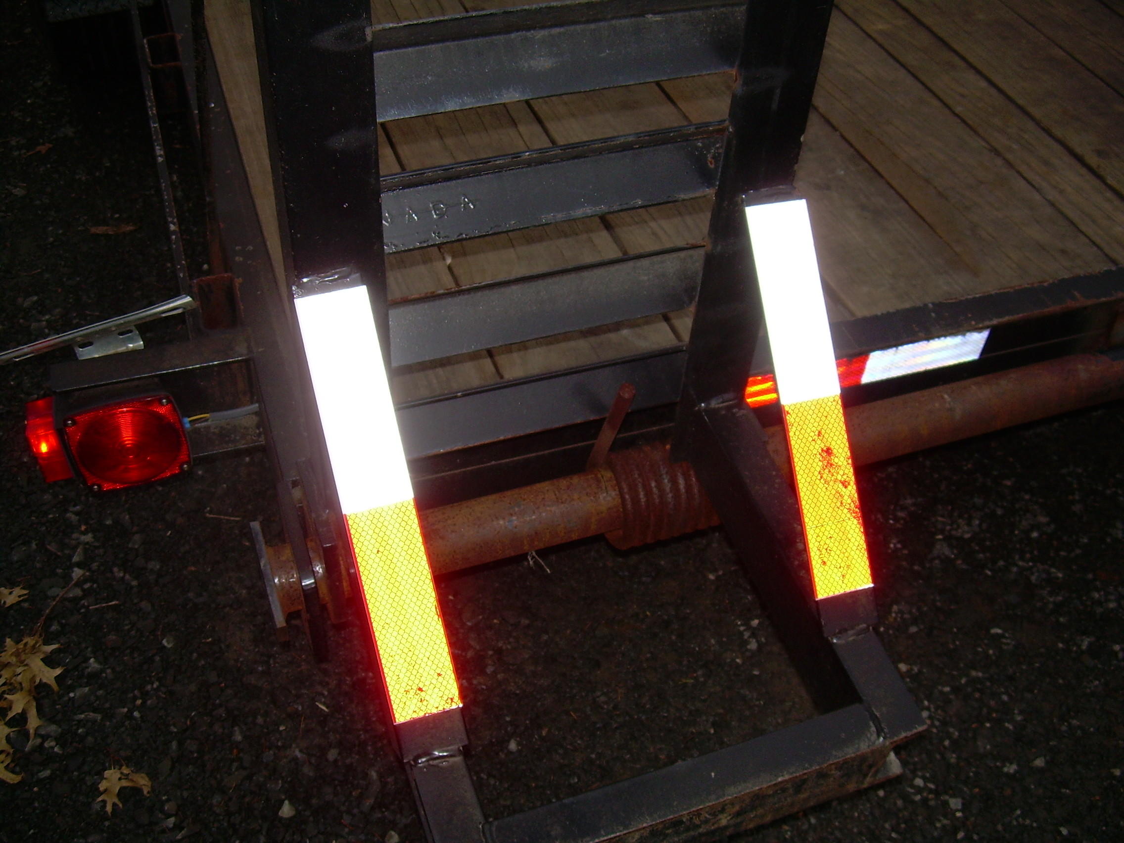

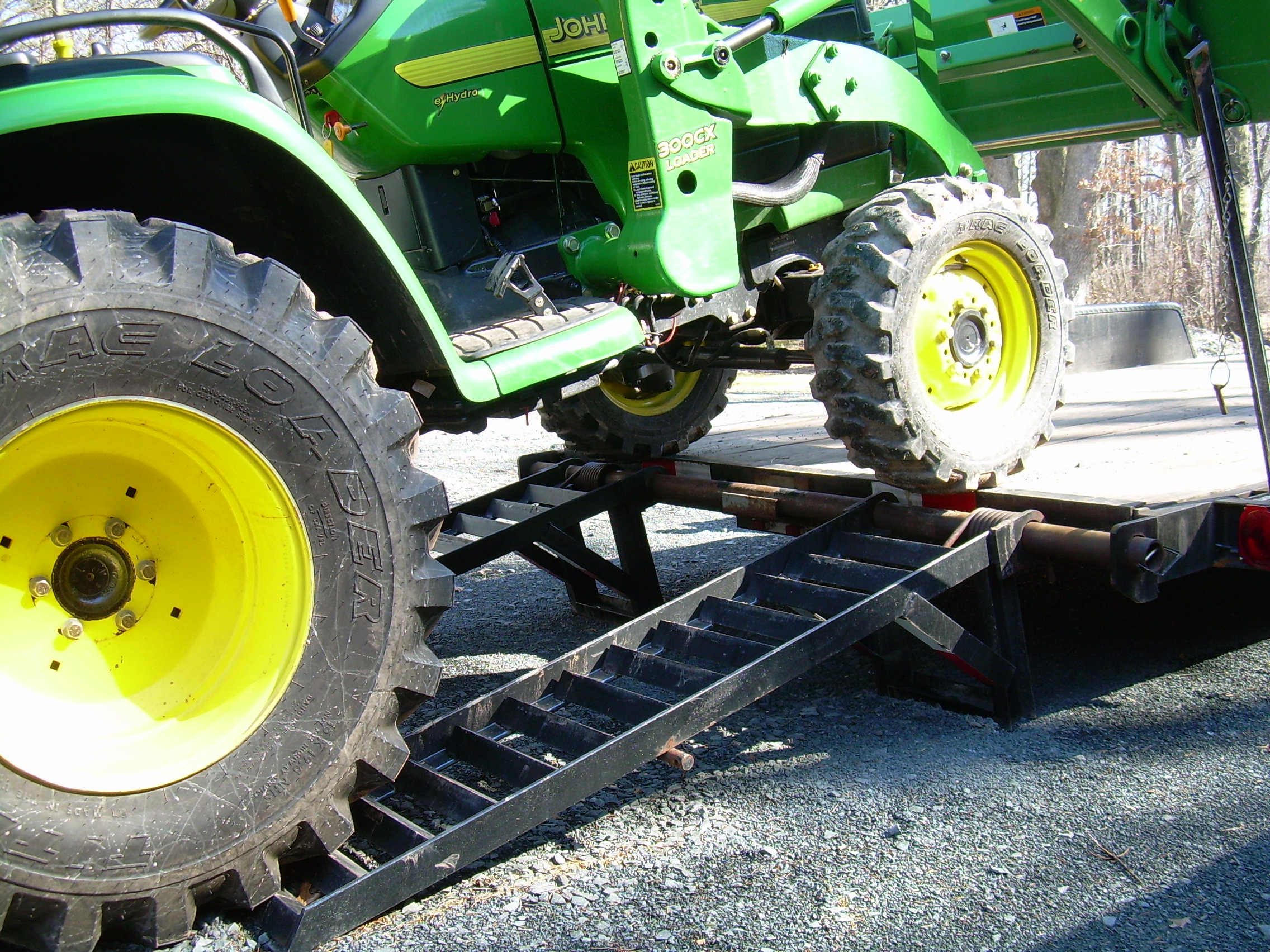

Yeah I've heard of that phenomenon in another thread, people have been killed from it!! I would of never thought about that happening, so it is good to bring it up.
Even though I would not expect it I THINK I would be able to react quick enough to it to avert tragedy. either by pulling forward quickly like your friend, or backing off quickly, a hydro would make that pretty simple, stick would be tricky.
Couldn't happen with my current set up though, since my ramps have the stands built in that touch the ground plus my truck weighs 12.5 thousand pounds.

Dont be comforted into thinking it cant happen. Undulating ground and the rocking effect on a steep enough grade can easily defeat those ramp braces, believe me I speak unfortunatly from personal experience. I trailered 15k on a 24' deckover with those exact ramps with an f550 for 7 years and quickly learned that a 5$ traingular block of wood and the 15 seconds it takes to place it is ultra cheap insurace you will never have an accident. I figured that out after i slid down the hill. And always chock the trailer, not the truck.

Nice trailer, thanks for posting the pics showing the supports under the ramps. This is an important safety helper but as with everything pertaining to trailering, know how and common sense is the bottom line.
