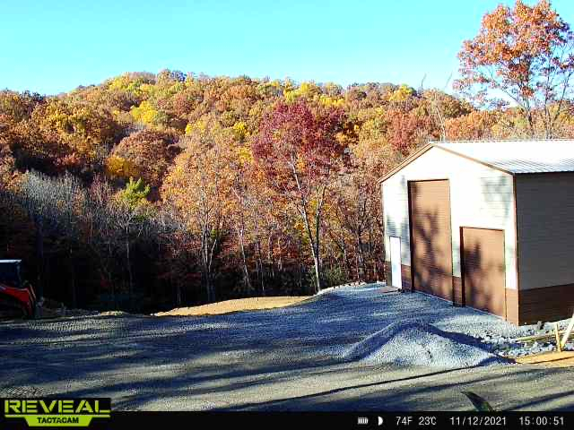

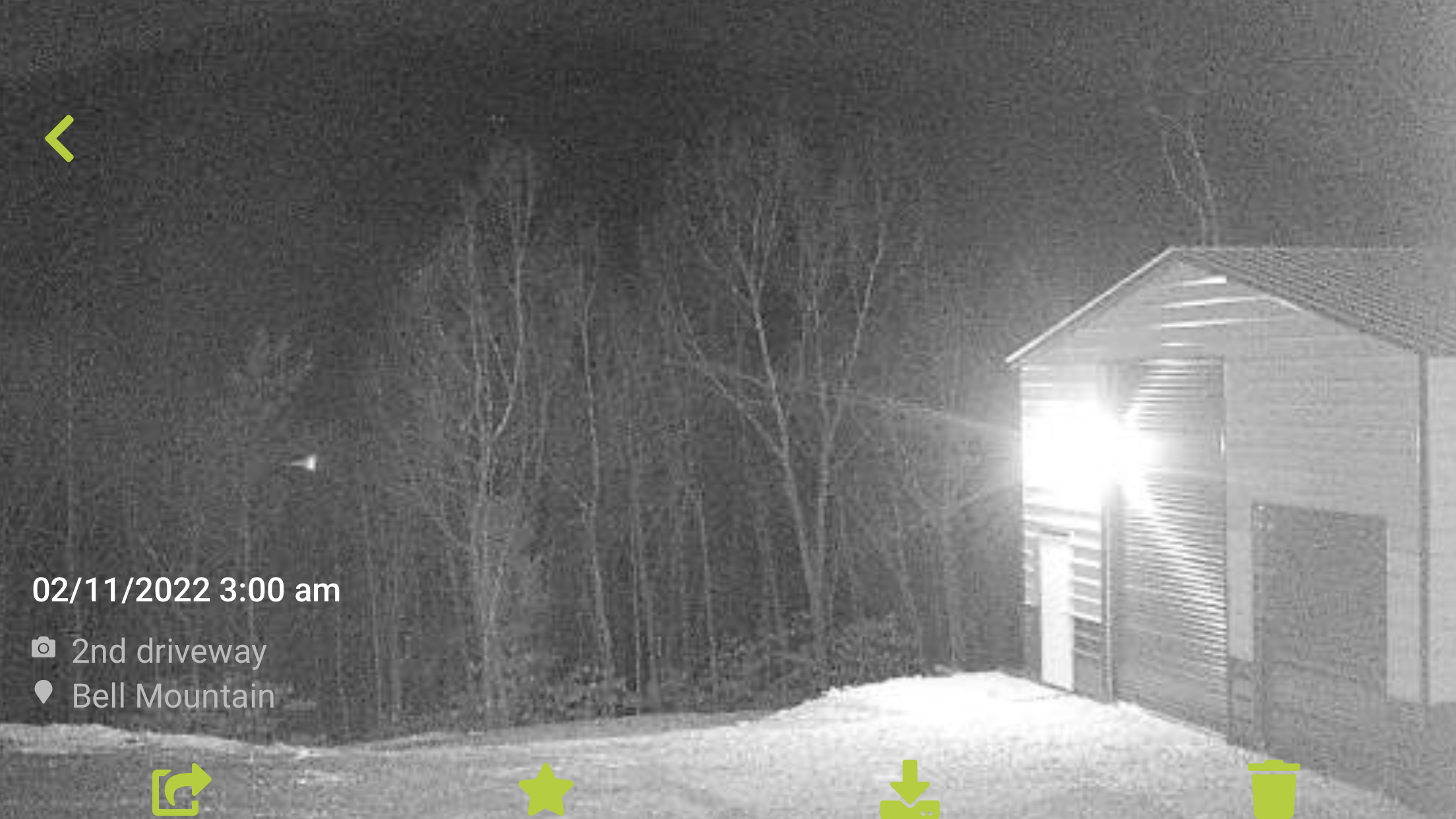

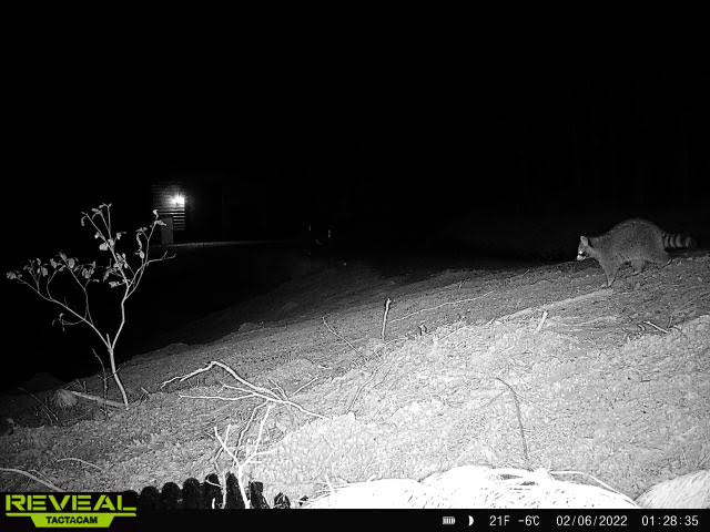

Mine is Tactacam. You need ATT&T or Verizon (please verify) cost is $5/month. no wifi, no electricity required.
If there is motion, you 'a' picture in a minute or so on your phone. The sim card on camera has a lot more pictures but it depends on how sensitive you set it. Mine is set to take 2 pictures/day just to verify that it is working. Batteries last months for me. I like that it gives me the temp as I am not yet full time there.

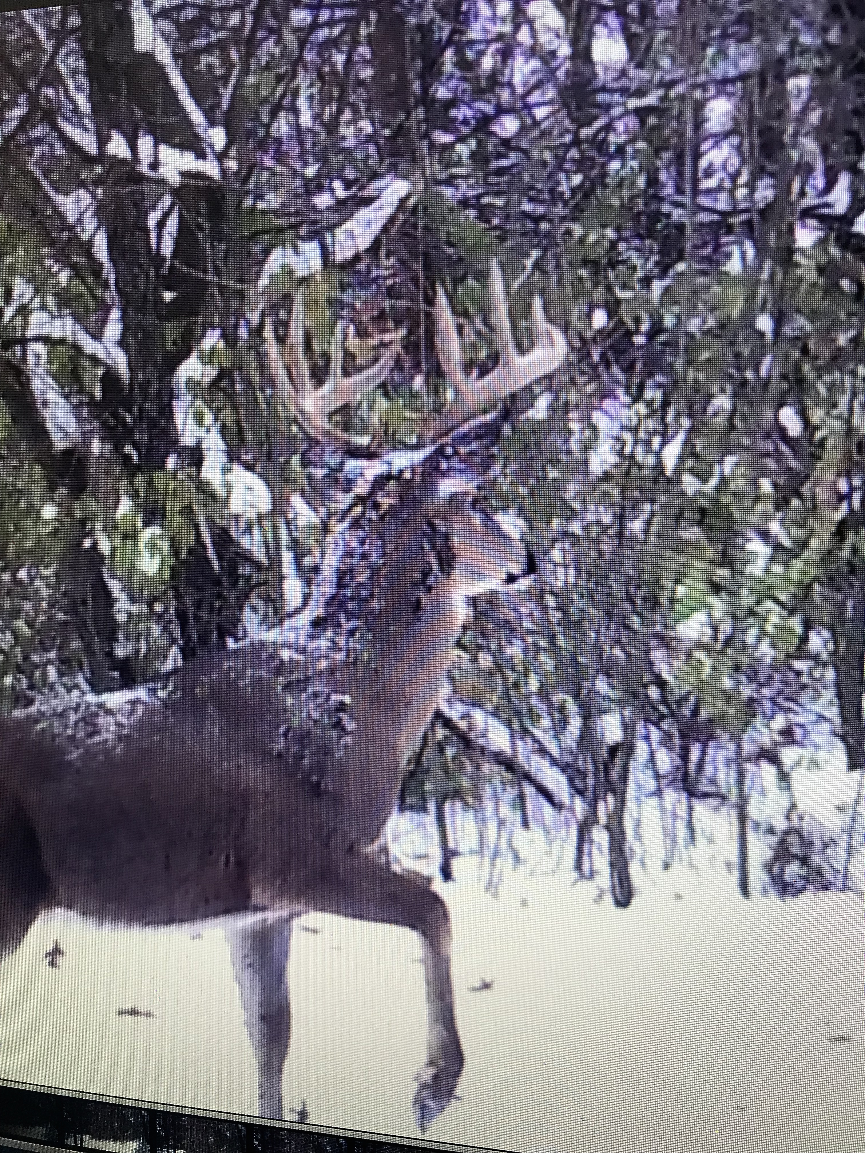

I have 5 brownings.
