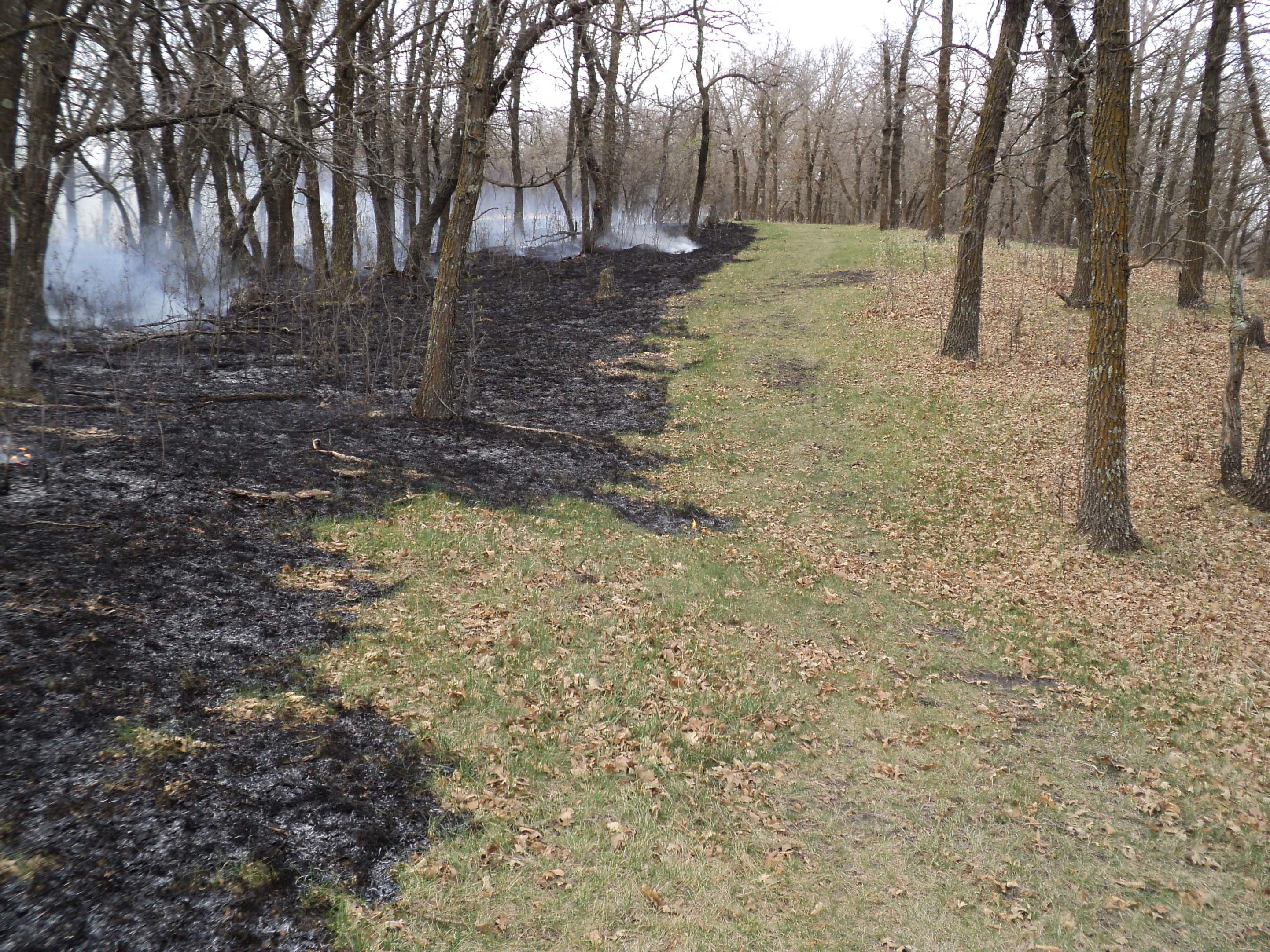

I would try to level the trails out when they dry up with a landscape rake, and then seed the trails to cool-season grasses that can be mowed short.
You need some kind of grass on them to keep down erosion and mud.
I have seen trails improved with loads of gravel but that would be expensive.
I'm trying to get the big rocks out of my trails - some the size of Plymouth Rock when I start digging and prying them out.
I don't use wood chips because my trails double as fire breaks.

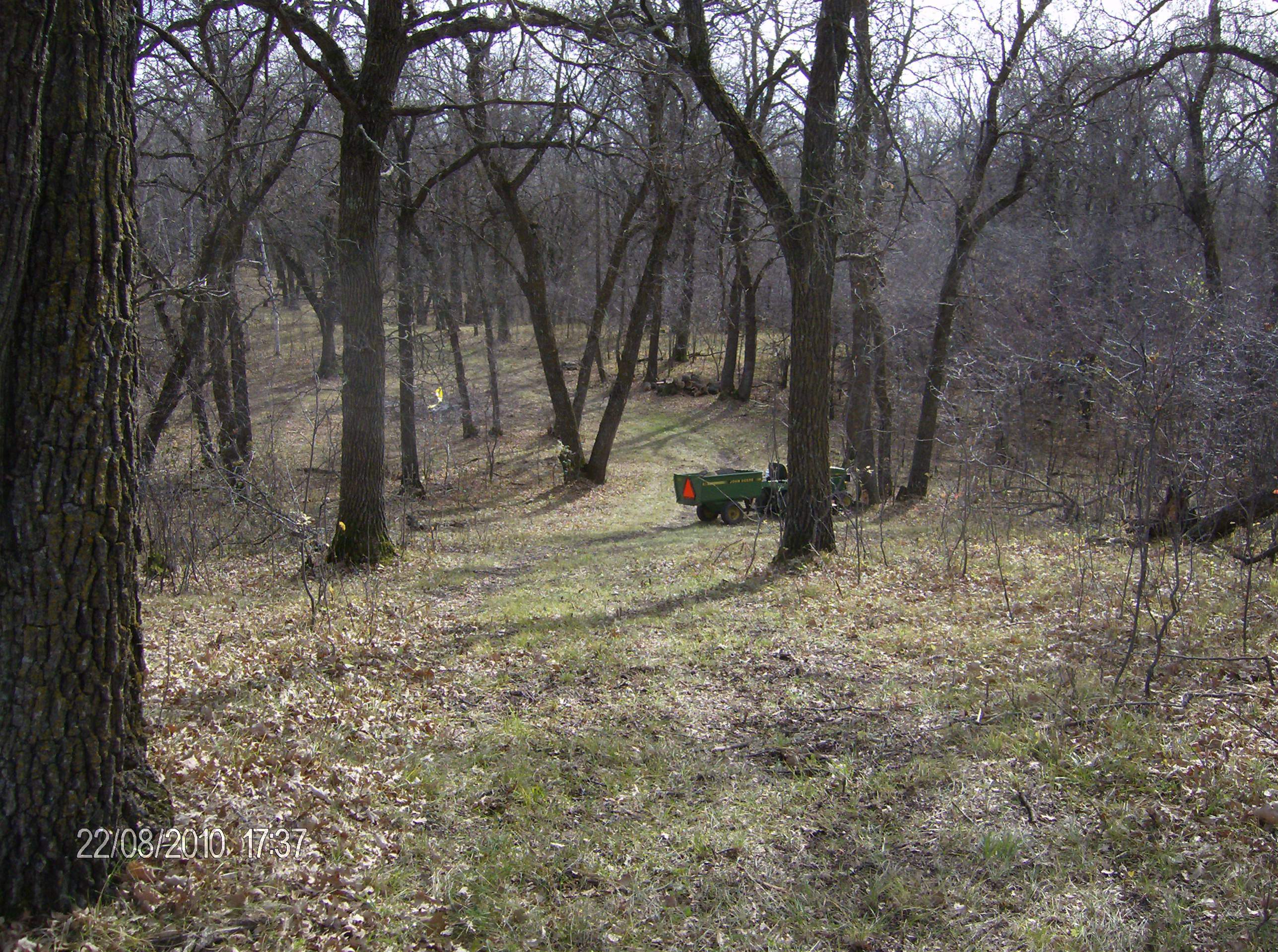

Thanks for the pictures
   / Trail Coverage - Wood Chips? #10
I use wood chips with my trails to keep weeds down. The soggy parts stay soggy so I fill them in with rocks from other projects. The wood chips compact where I drive a lot, but do work. I use my 6" Valby PTO chipper and gator to haul the chips. Whenever I walk in the woods I stack dead stuff along the trails to chip on the day that job comes to the top of the "To Do list".
