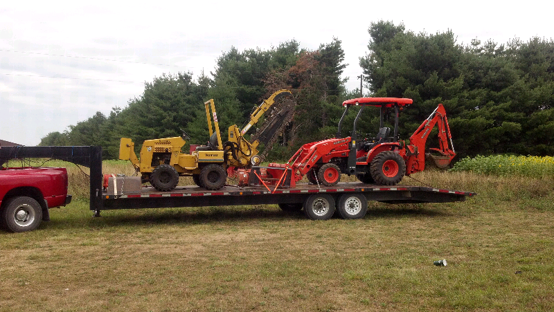

It sounds like a 30' wood be right length. I have one that has 2 8k axles and I really like it,but I if I did it over I would put 10k with single 19.5 tires which gets you around 20k of tire and only 4 tires. I don't like flip up ramps.
I have been looking at ones with hydraulic dove tails but they are pricey. Don't settle get what you need/want the first time. Here's pic of my setup
