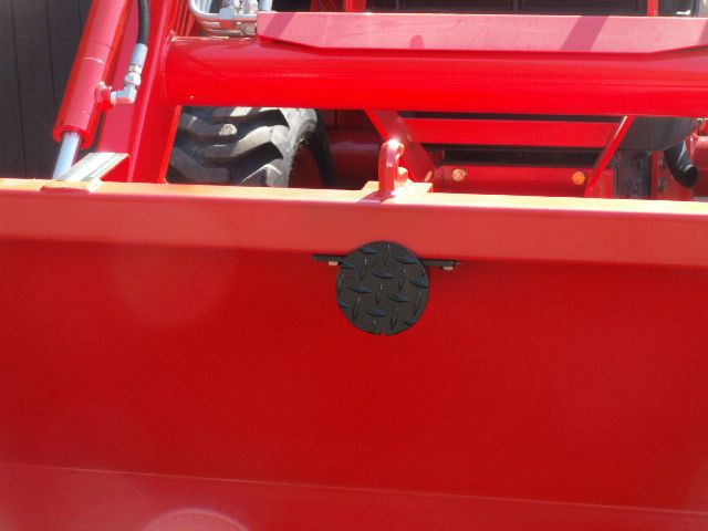

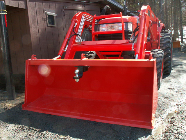

Anyone drill a hole in the FEL and install a trailer ball? I have a backhoe attached and don't like removing it unless absolutely necessary.
Good or bad idea?

My neighbor drilled a hole in his bucket for a ball, and it works fine for him. He is always shuffling trailers around with his tractor, and most of the time, it's with the ball on the bucket. He might have considered the clamp-on receiver hitch, but the first time he needed to move something with the bucket, he had a spare ball and a drill handy, so that's what he did. He has never felt the need to change it.

I hardly ever use the ball on the front bucket because I have a tough time seeing over the hood to hook it up. Plus, the top of the bucket where it is located is to tall to go under trailer hitches. It does work great for GN trailers though. It is close to the FEL pivot point so it is sturdy.

Holes in the bucket have never worked for me and I see other guys welding them shut and getting one of the clamp-on brackets mentioned earlier. That's what I have and it works great by extending the hitch out a foot or so and that makes it easier to see when hooking up.
Here's a pic of a typical clamp-on one from the internet.
   / Trailer ball #9
Clamp on is the way to go!
Buddy had drilled to accept a ball in his FEL and it damaged all the trailers as his cutting edge would interfere.
I welded him up a clamp on hitch and all the problems went away.
He operates a storage facility and moving trailers are a near daily occurrence.
If U can't weld one up there are many sources on the net at affordable prices.
