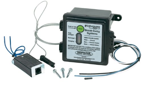

I was going to replace the brakeaway battery system on my trailer . Princess Auto has one on their website that looks to be similiar to it , item #8506289 but it isn't carried at the store here . They have got one called an Engager brakeaway system item #8002177 but I am not sure if it will work as good or better than my old one . My trailer is a flat deck car hauler with brakes on one axel . I might put brakes on both axels later . The axel has the flange on the hubs so it looks to be easy to do . Will the Engager brakeaway system work as well as the other ? It is more expensive $64.99 vs the other $29.99 . I am 200 miles from the Princess Auto store and any other store that sells trailer parts so just drop in and looking at it isn't easy because of my work schedule . Barry.

This is the Engager that came on my Sundowner horse trailer. I like that I can check the battery status. $39.99 from Northern Tool.

I got the engager at princess auto . When I opened the box the battery needed to be charged so I desided to charge it before putting it on the trailer . It has been hooked up to my battery tender since yesterday and still no green light so I guess I got one with a bad battery .

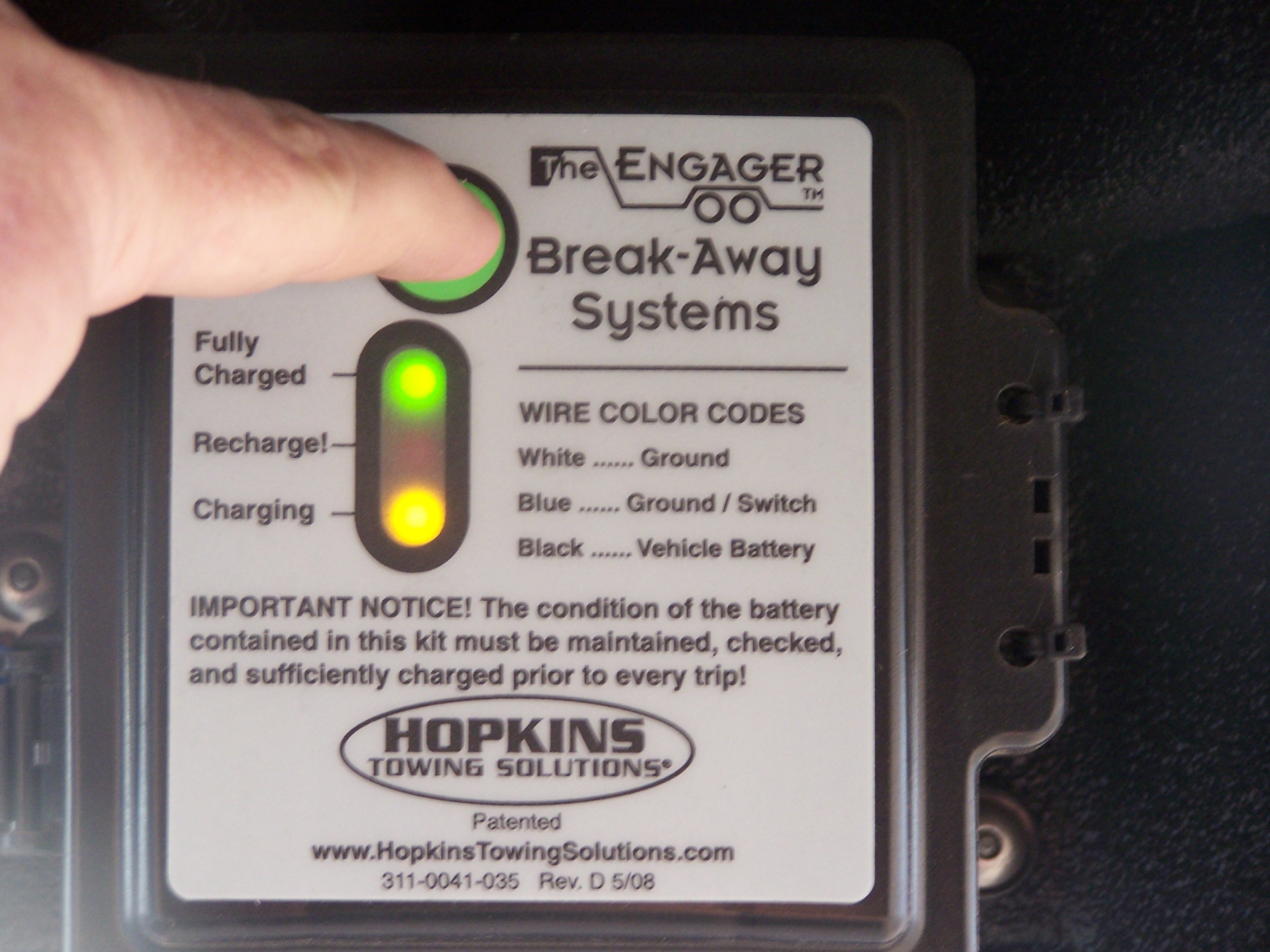

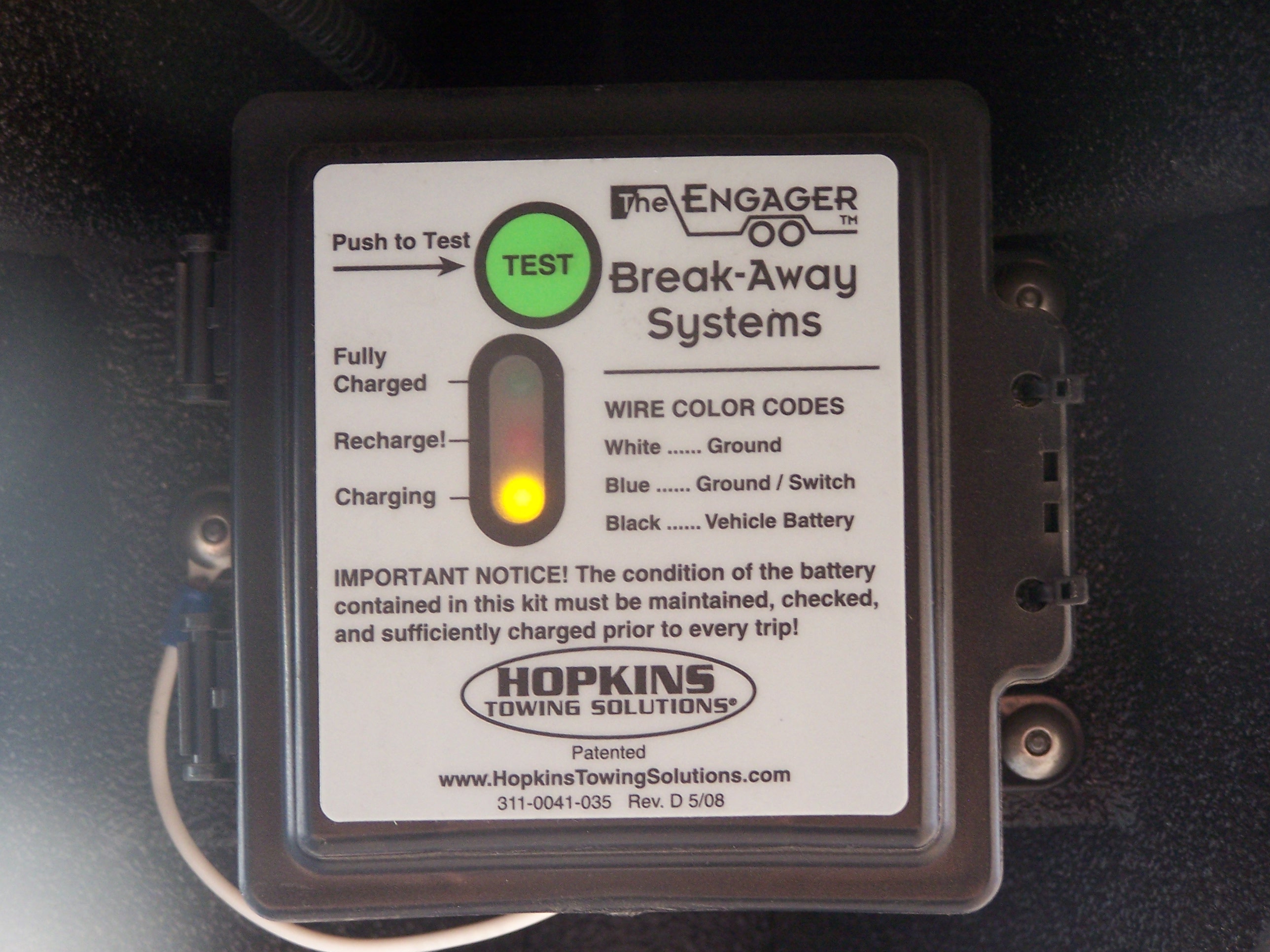

On the engager breakaway system the yellow light stays lit when it is charging. You have to press the status button to see if the the battery is charged and therefore green. Just thought I would throw that out there as I originally thought I had a bad unit because it always said charging
   / Trailer brakeaway kit #10
Exactly. Mine is connected to the onboard battery and always shows yellow until I press the button as the pics show. The other thing I found if I was charging the main battery neither of my auto battery tenders would go into desulfinate mode with the trailer brake battery connected. The main connection at the battery is a ring terminal with a wingnut and screw so disconnecting it from the circuit is easy.
