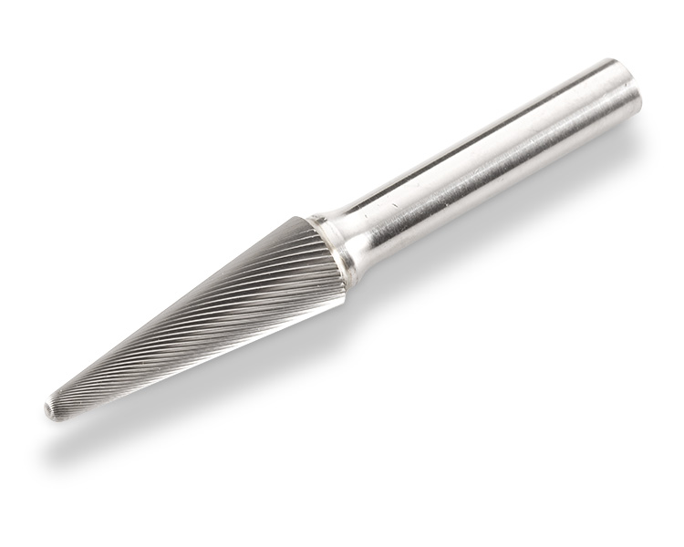

A carbide tapered rotary file will enlarge the hole,, no problem.

Thanks for the tip. I need to get one of those carbide tapered rotary files and get after it. I can already see other uses for the new tool. Sounds like they are typically used in a die grinder or similar tool - correct? Can you use them in a regular cordless drill or is very high speed recommended? Thanks again.
I use mine in a cordless drill all the time.

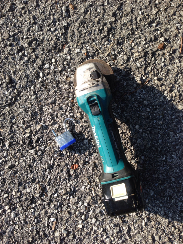

Look underneath on many trailer couplers and you will see a big nut that can be loosened to adjust the coupler. Remove it and the lock on the handle of the coupler does you absolutely no good. Aaron Z
In about the time it takes you to kneel down to look I'll have the lock cut off with my cordless angle grinder.
