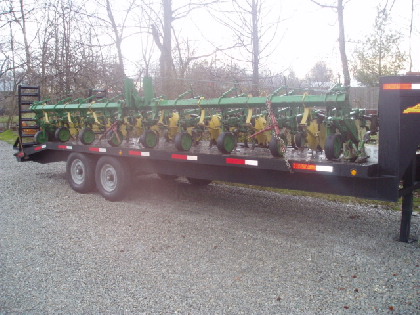

This trailer had treated 2x10's when I bought it. They were not the best of boards.... I have a friend who runs a small sawmill. He sawed out some 2"X 8" White oak for me. It was dried for about a year before cutting, and a good 6 months after sawing. It gets soaked with 3 parts used motor oil/1 part diesel fuel at 2 month intervals. The rough sawn lumber gives superb traction. White oak is stronger than 40 acres of onions...

or 10 acres of cabbage on a warm november day, how long is the trailer?
   / trailer deck #7
</font><font color="blue" class="small">( or 10 acres of cabbage on a warm november day, how long is the trailer? )</font>
20' + 5' dovetail. It looks longer than it is for some reason. That's an 8-row cultivator sitting on it. The frame is 20'-6".
