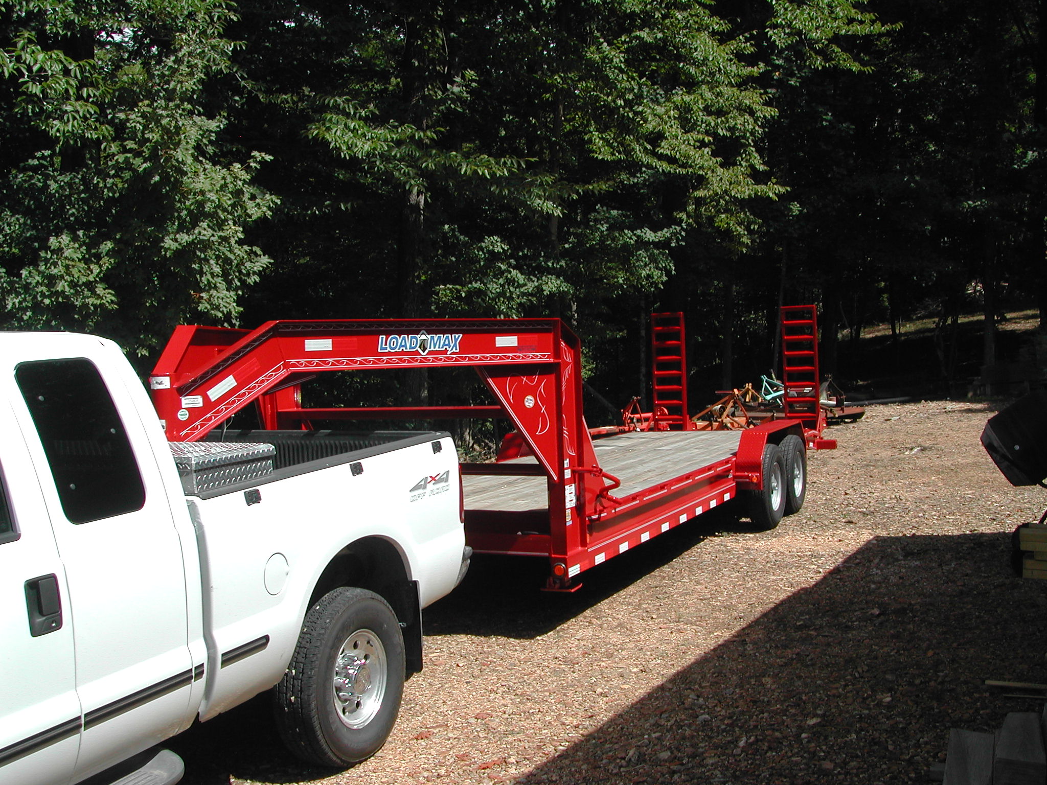

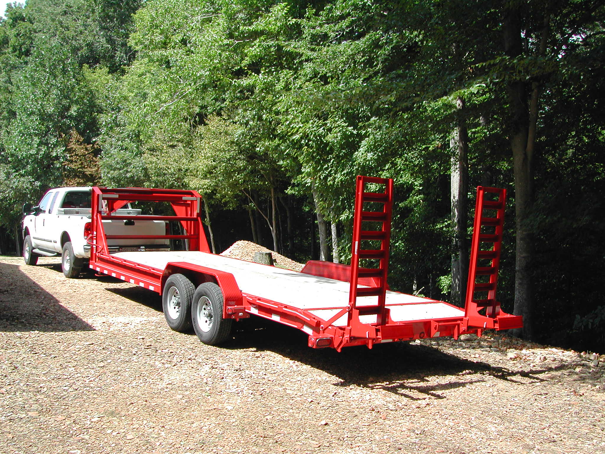

I've got a Load Trail gooseneck carhauler type 22' flat with a 2' dovetail and it has removeable fenders that allows easy pallet loading as well as loading a wide-stanced vehicle. The tops of the tires are maybe 1" higher than the deck and can be driven across easily. The fenders off allows car doors to open without banging too. Only 2 bolts per fender to remove. The lower center of gravity of the lower deck makes a heavy load feel a lot better.

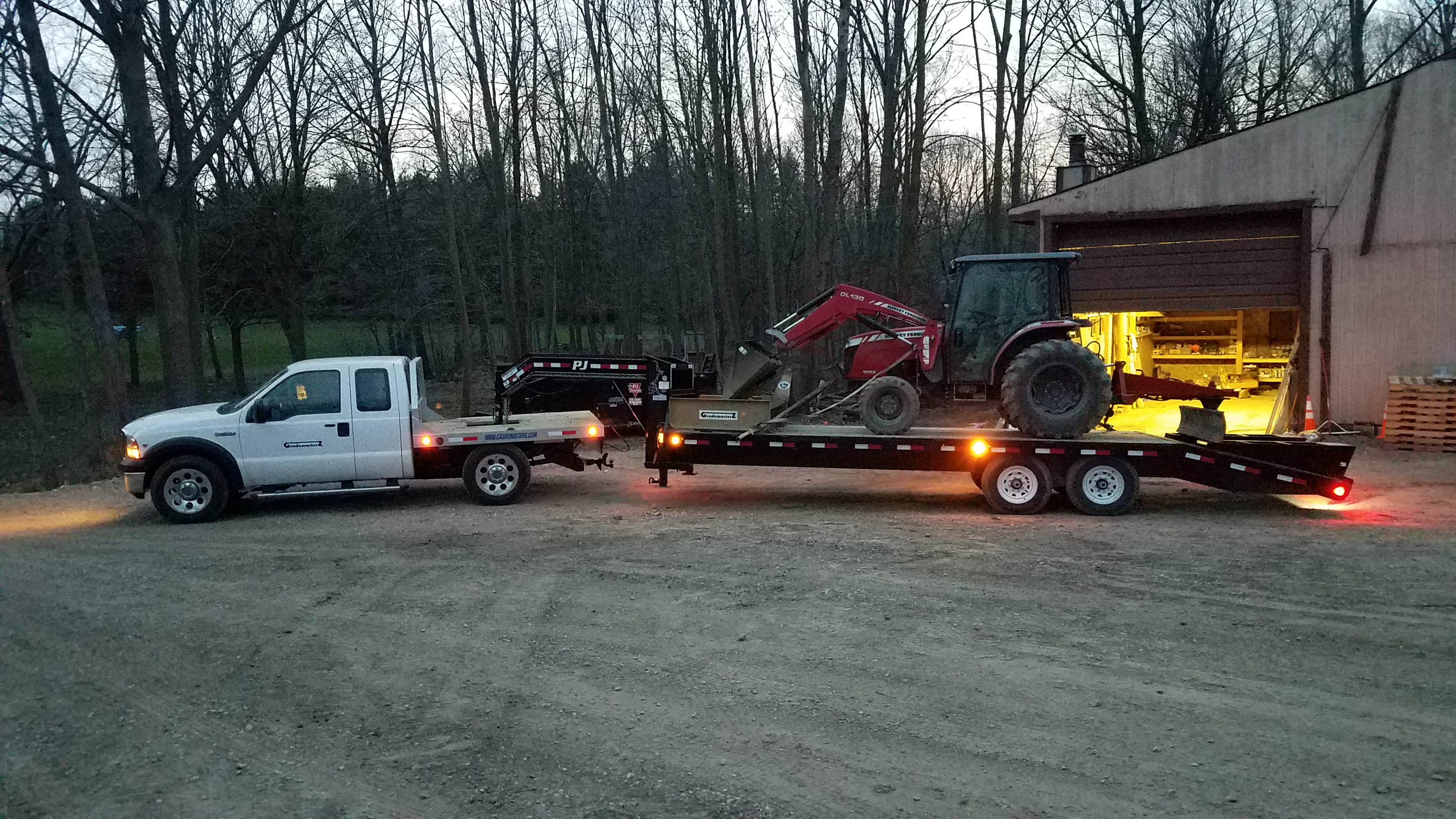

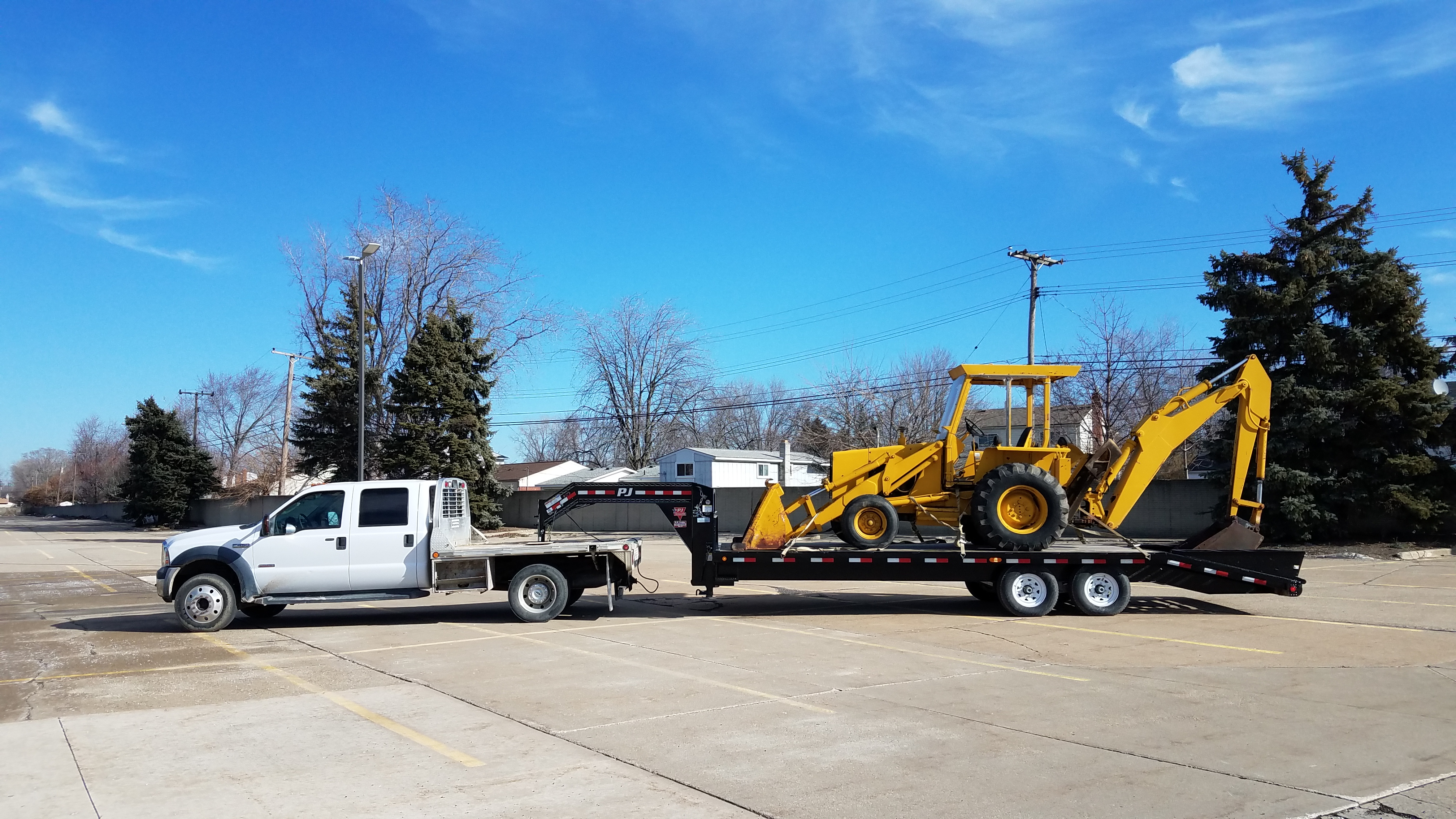

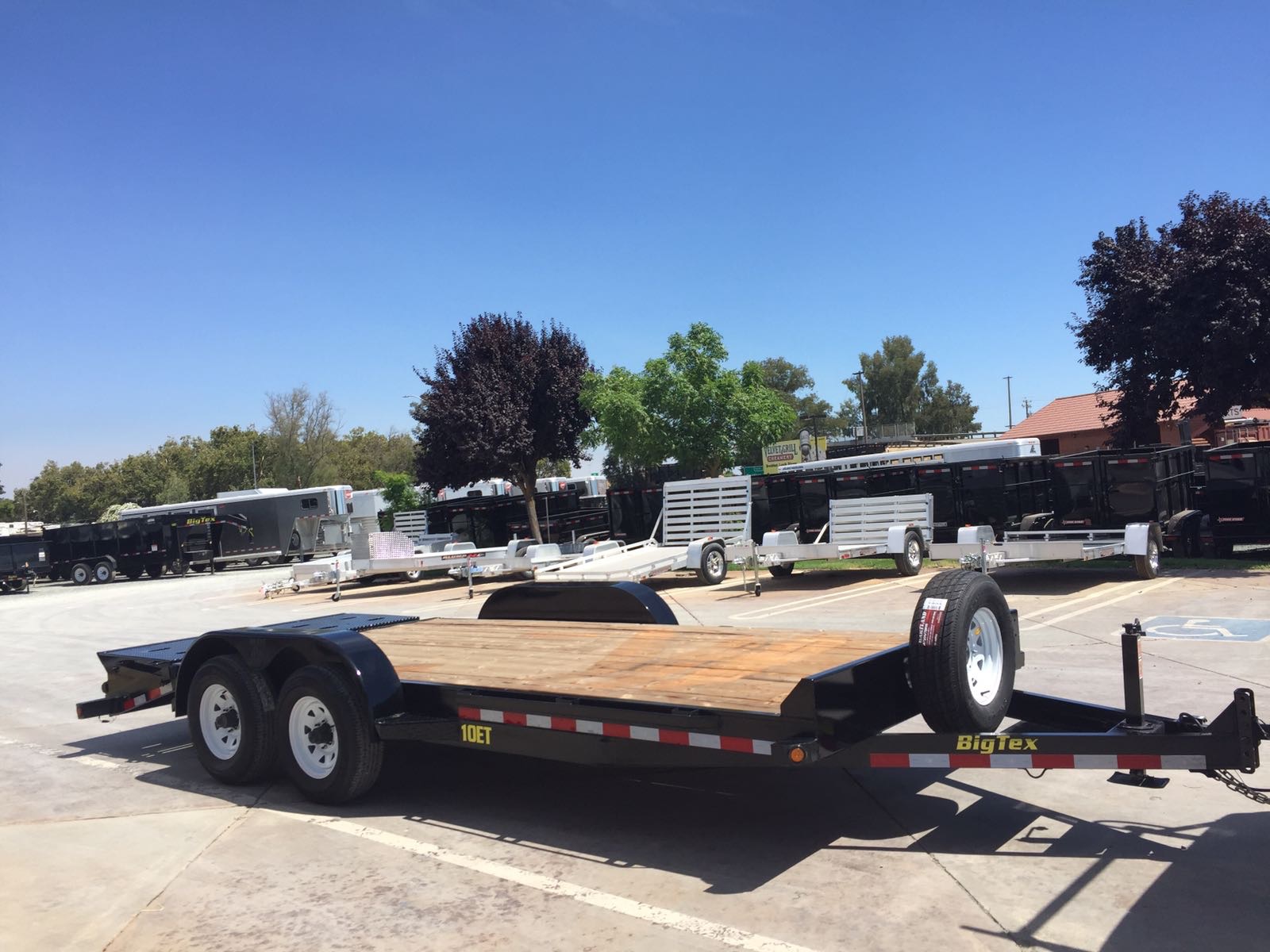

Here is a photo of my current equipment trailer, 18ft Big Tex with mega-ramps. The fenders are removable (2 bolts).

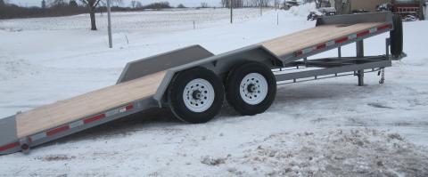

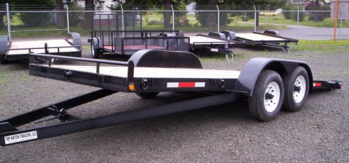

Have you considered rollback and tilt trailers? No ramps. :thumbsup:
Tilt:
