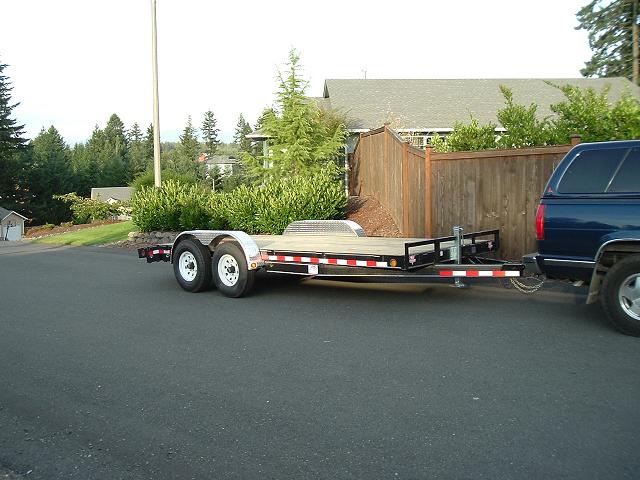

   / Trailer for L-39 & other general purposes #9
The other trick about going between a 5th wheel or a gooseneck and a bumper pull is that you lose your bed and the trailer is only useful to a guy with a gooseneck hitch in his truck. No brother in law borrowing it and most crooks don't have the hitch.
An L39 is pretty heavy and would be about the point where that gooseneck is becoming the right thing to do. Many people report only a minimal increase in price and higher driving pleasure.
You will have a hard time finding an equipment trailer with a 5th wheel setup, most likely it will have a gooseneck which is just fine, easy to hook up since you can visually watch the ball engage from the driver's seat.
If you decide to go bumper pull, know that the typical receiver/hitch/sway bar/ball systems are rated for 10,000 lbs of total weight. A 10,000 lb GVWR bumper pull trailer will weigh at least 2500 lbs so your L39 needs to be lighter than 7500. I attached a picture of my 10k lb bumper pull that I load with 4-4500 lbs of tractor and implement for a combined weight of less than 7000. I love that trailer and pull it with a half ton. /forums/images/graemlins/blush.gif
The 93 cummins is the first intercooled version from dodge and was rated at 140 HP as compared to the modern 300+ HP so the comparison to the modern 6 speed isn't really too good. The cummins has always been a brute though and you'll just need to take her slow and use the immense torque.
