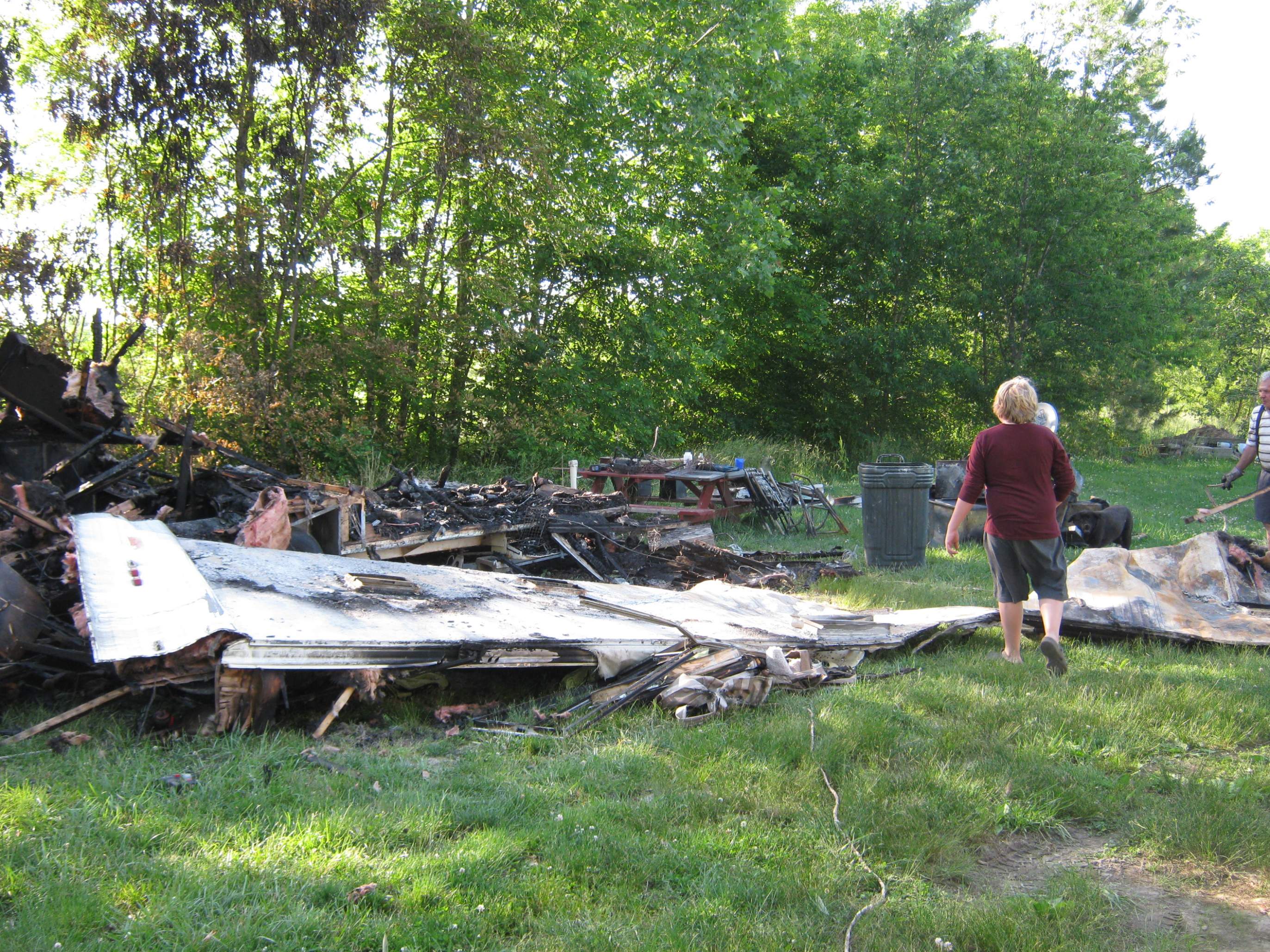

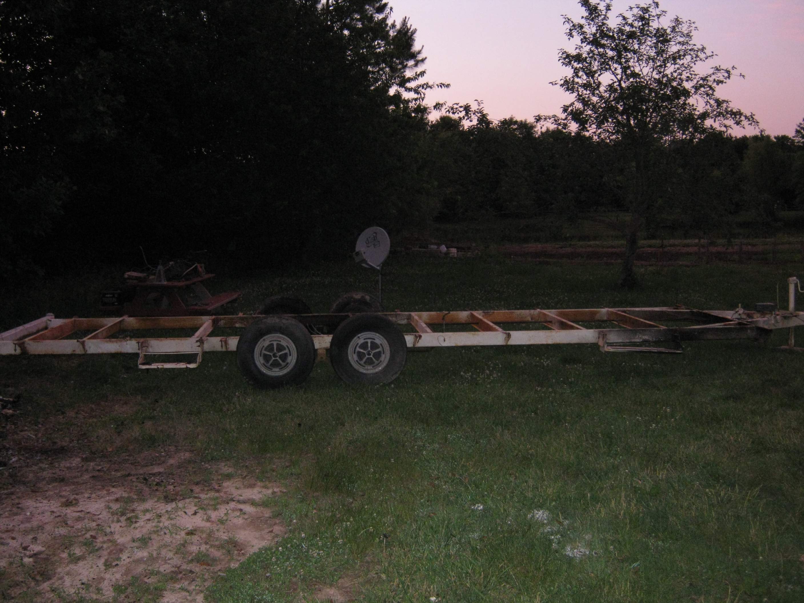

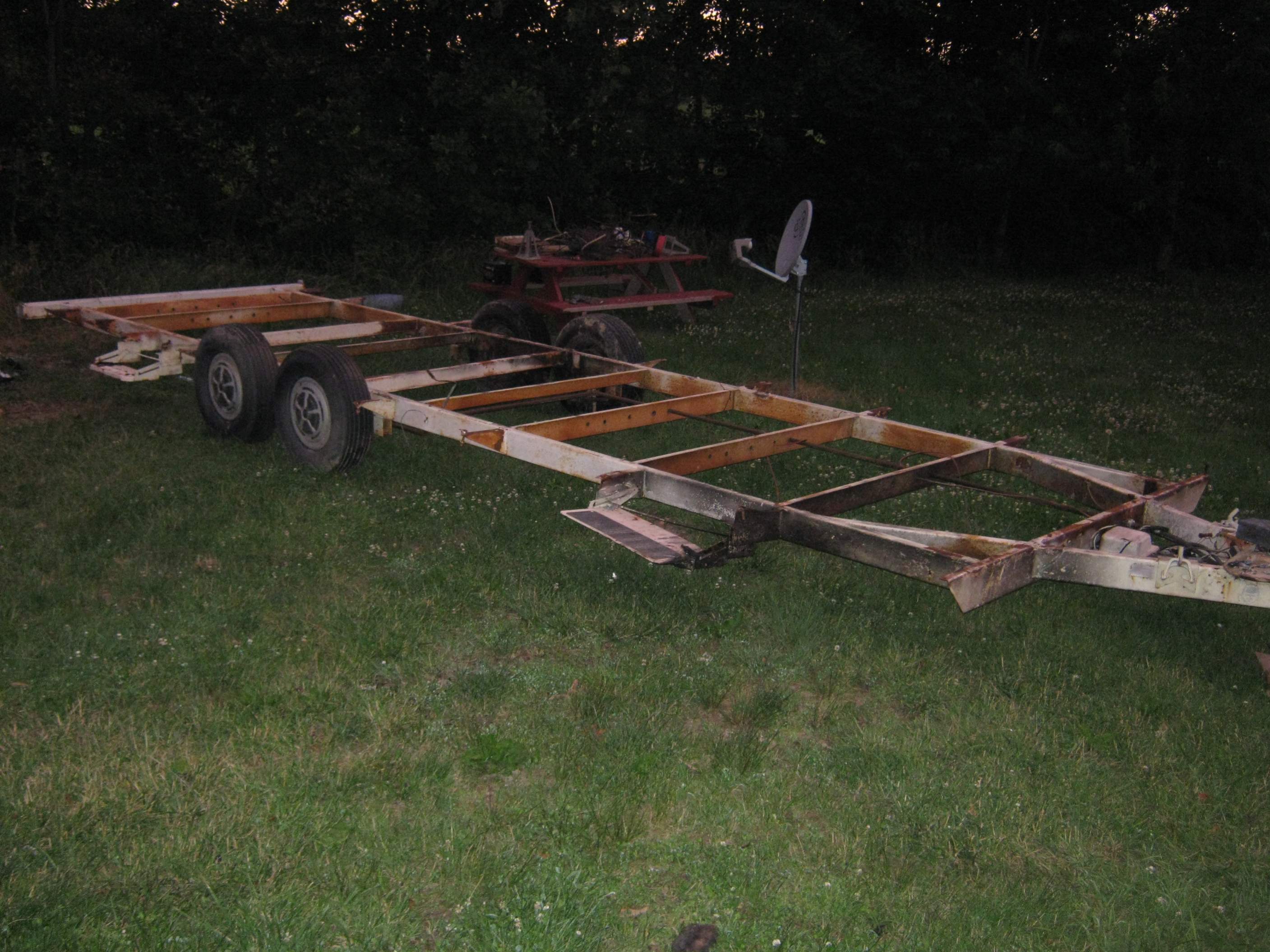

My folks keep a camper at our place to stay in when they come through and we had a little fire....well a big fire. By the time the FD got it put out I wished I had never called them. What a mess! The good news is, now that the demo work and hauling everything off is done I'm left with a pretty nice 28' trailer w/ 4500lb axles and brakes. Although the camper itself was a total loss, the wheels/hubs/tires/axles and frame were basically untouched. I just bought a new trailer last year and don't need this one so it looks like it's going on Craigslist. Now the big question, what's it worth? I have a title but it is for a totaled camper so anyone buying it may have to apply for a home made title...which is easily done in these parts so I don't think that should detract a great deal from the value but I am willing to take that into consideration.
I'm also wondering if this could be made into a decent round bale hauler if it was beefed up a little and the axles were moved a little more forward?

I think you would need to beef it up a lot to handle hay. Certainly the axles would need to replaced. My families 16' hay trailer has 2 6K axles. The outside frame is 5" channel, the inner frame is 3" channel. Two pieces of 5" and two pieces of 3" channel run the enitre length of the trailer. The cross pieces were 3" angle every 4'. The cross pieces bowed in the middle from the weight of hay bales resting there. We later added 2" channel between each cross brace.
My guess is that the shell of the camper provided significant support to the rails below.

If it were me, I would go the opposite way and shorten it up to about 20-22ft and use it to haul 5k-7k lb loads. I think that would be the smart thing to do rather than try and beef it up for really heavy loads.

Darryl I can not see that it has any value for hauling any loads like you mentioned. It has no real frame to work with since was designed to carry a self supporting box.
