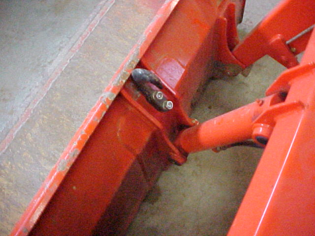

   / trailer hitch for FEL #6
Don't even need a ball, just curl bucket all the way down and hook the ball socket with the hook and go. Works for me!
