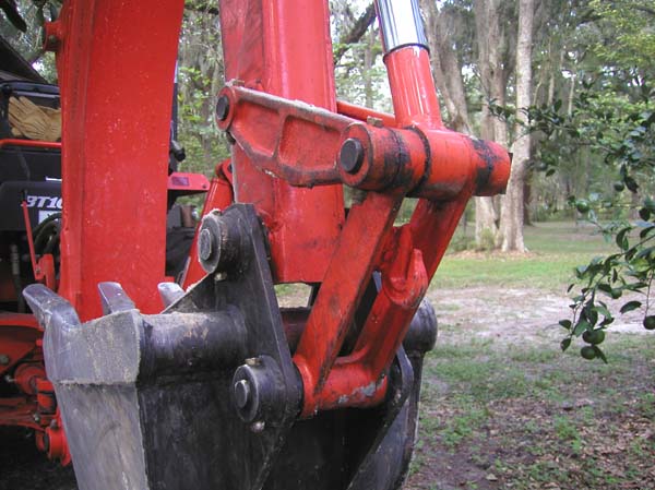

I see many ads for trailer hitches on drawbars at the rear but I use the backhoe all the time and don't want to take it off just to move a trailer.
We have an enclosed trailer that gets storedin a very tight spot that requires every ounce of my backing up going forward skills when attached to the pickup.
I'm thinking if I could attache the trailer to a ball somewhere on the backhoe bucket - the tractor is shorter and MUCH more manuverable - I should be able to place that puppy on a dime.
But where, how to mount a ball on the backhoe without interferance problems?
Perhaps some sort of a slot/sleeve that the ball hitch could easily slide into when needed.
I know there are brilliant solutions out there amongst the TBN fabricators

I made a simple device that I attach to the center of my loader bucket and it has a ball on it. I now see that they sell these.
Mine is simple, but you would probably have to have a welder.The ones you can buy use a screw clamp to hold them in place.
for mine I used a pe=ice on steel angle iron and set the ball on one end and the other end drilled a small hole 3/8 in the bucket . and used a bolt to attach it. I just reciently welded the bolt solid and drinlled it out to take a lynch pin. This makes it easy to put on and off.
My trouble is remembering where I put it last..LOL
The advantage to this type is that I can see the trailer and its much easier to jog it around.

I'm not aware of a hitch that goes on the backhoe arm/bucket. That would be rather stressfull on the geomotry of the arms & hydraulics, and may not be a very good idea.
--->Paul
   / trailer hitch on backhoe? #9
A Kubota B-21 is a TLB.
I would simply weld on a plate to the upper rear lip of the BH bucket and install a trailer ball onto that with the bucket levelled.
I welded a clevis hook onto the BH of our L-39 TLB as seen in the attached photo, something similar with your B-21 is possible with a ball hitch... /forums/images/graemlins/wink.gif
