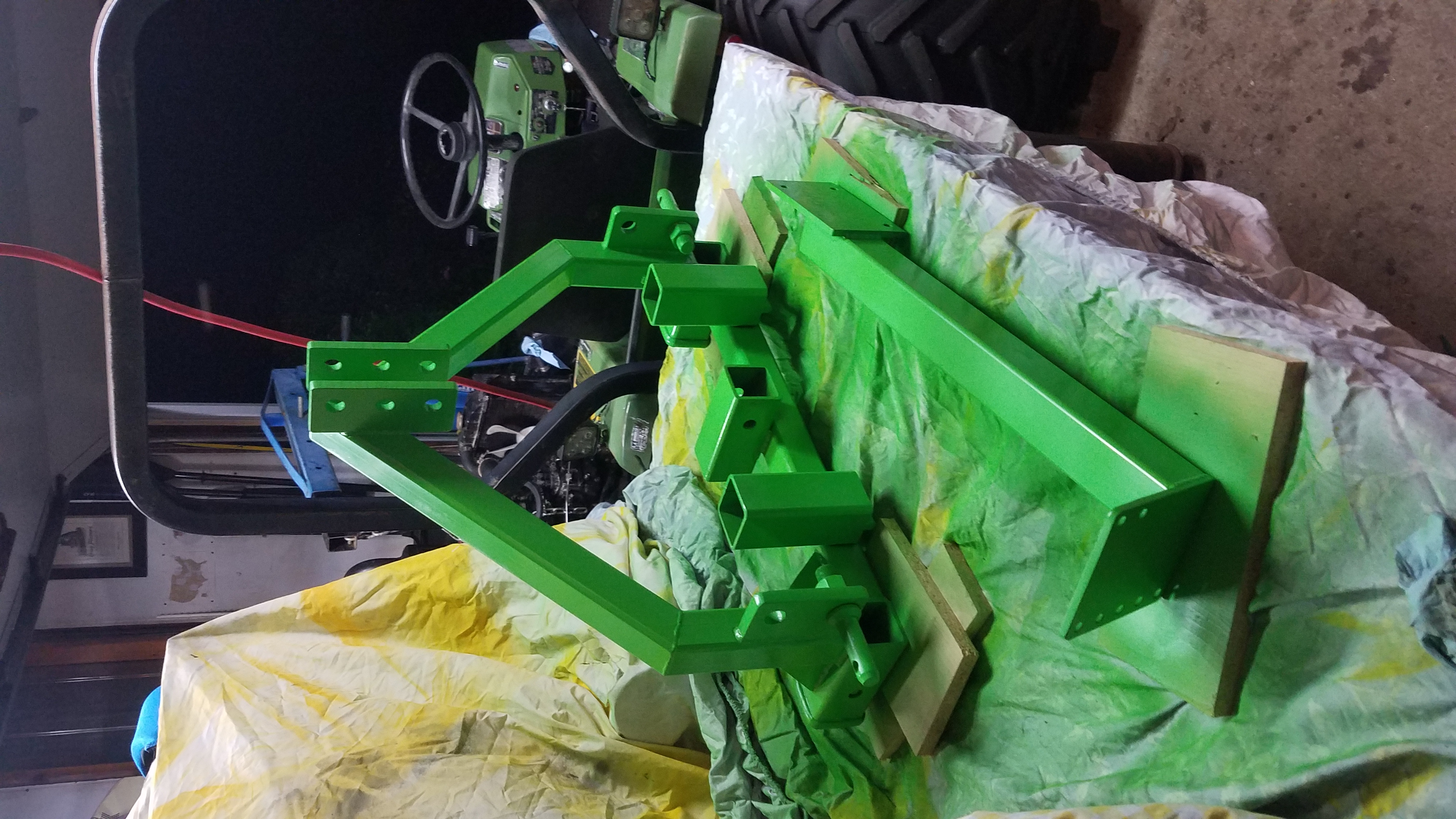

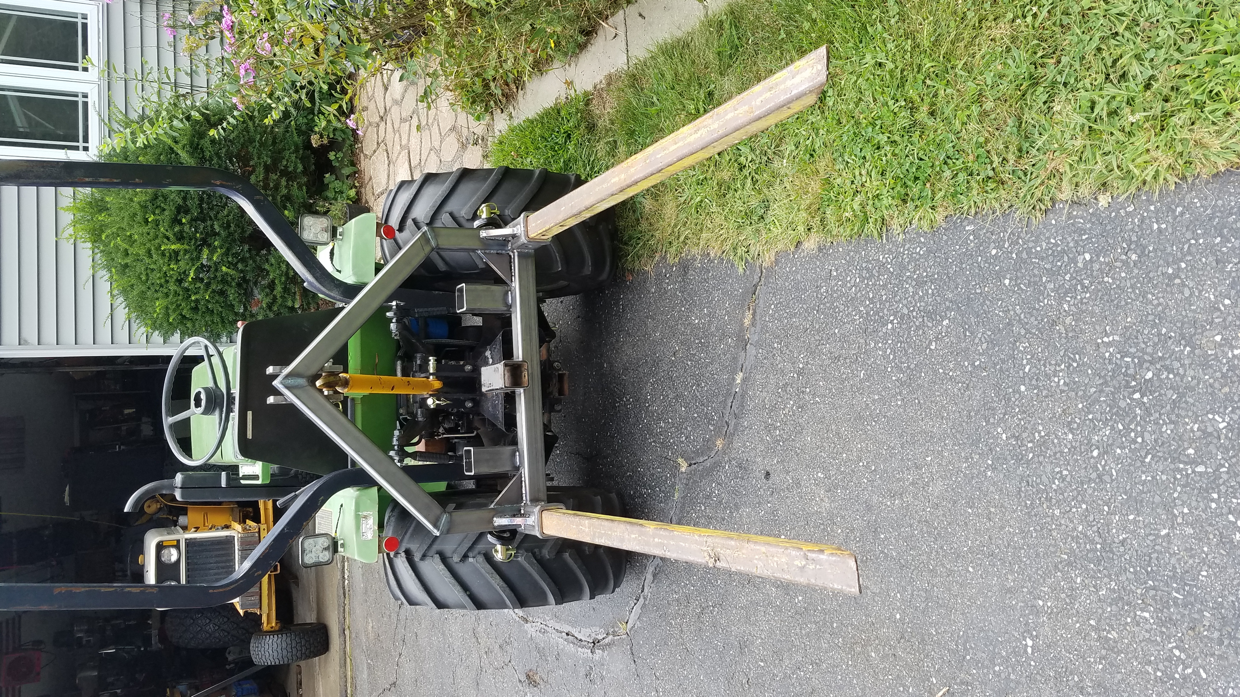

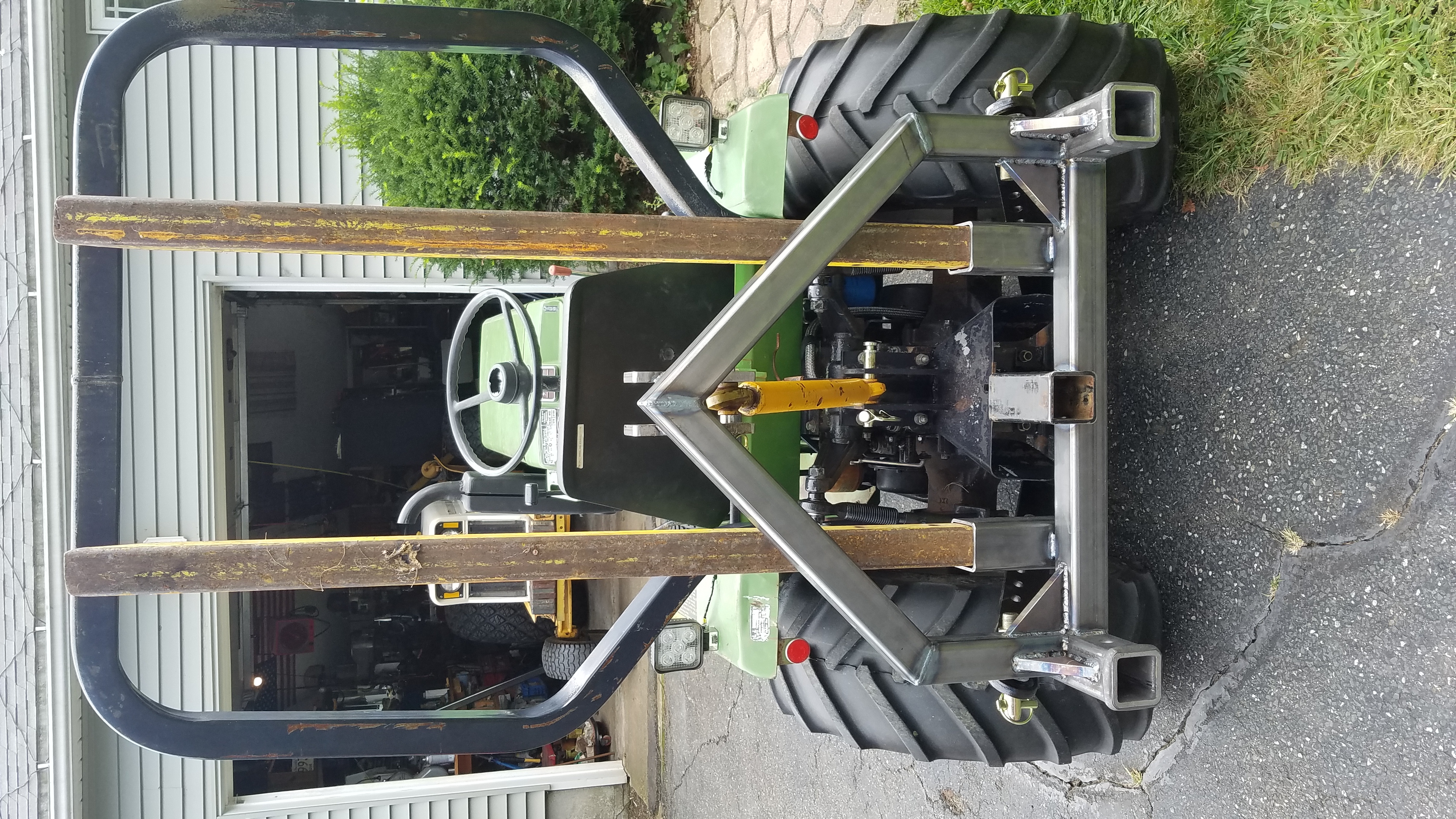

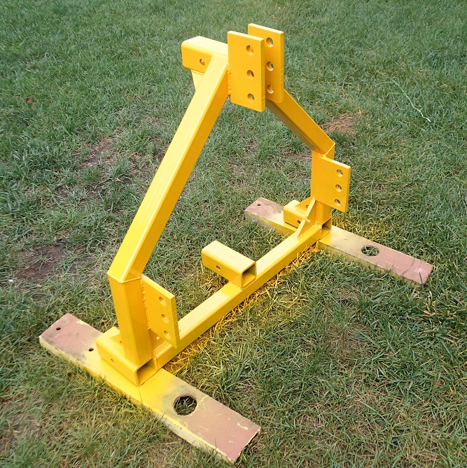

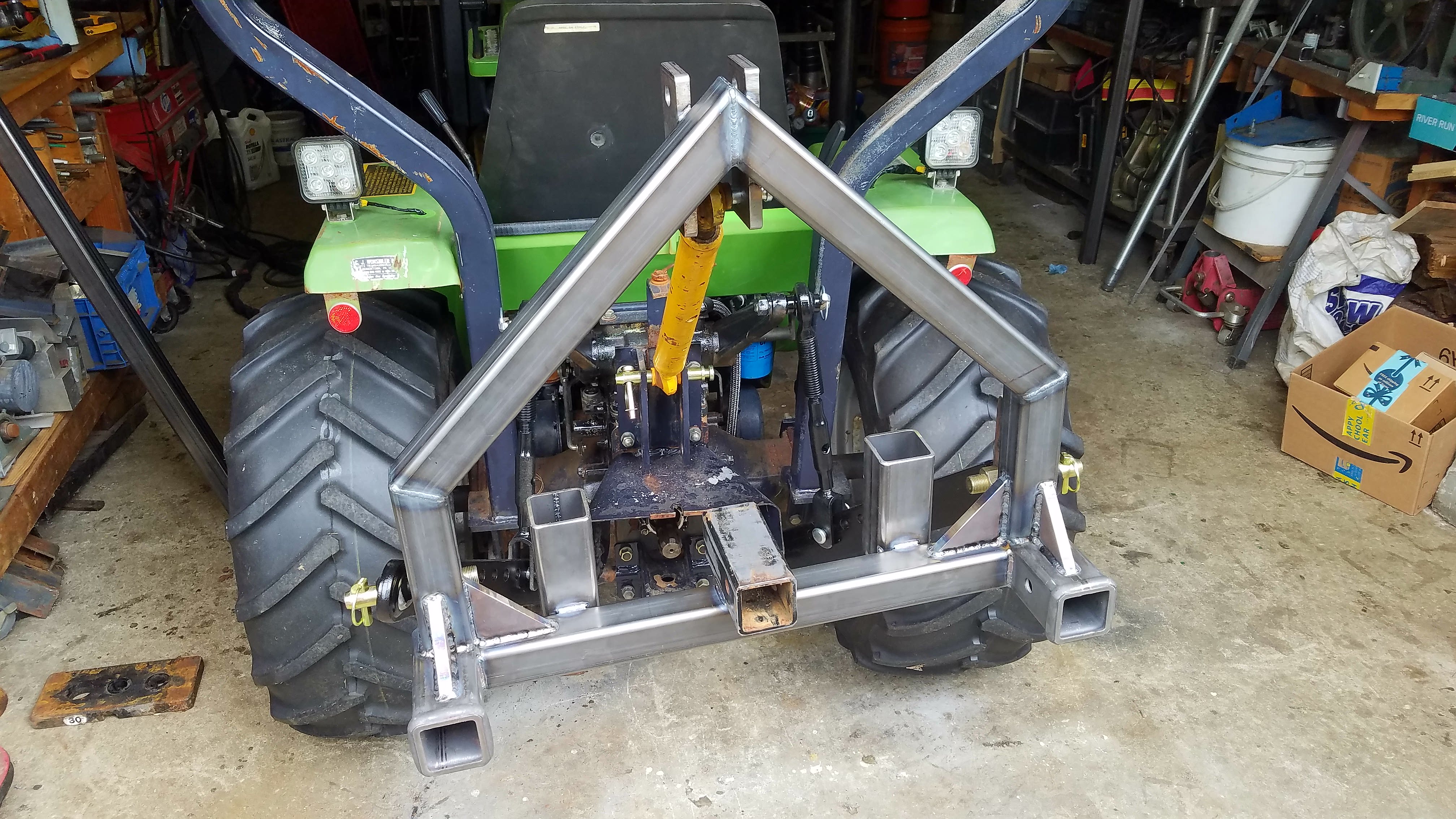

I experimented with a hitch design very similar to this on my IH Cub Lo-Boy 185 a few years ago. It has worked out so good I had to build a 2nd one for my recently picked up a Deutz-Allis 5215
99% of my tractor usage is moving pallets or trailers around the yard. This utility hitch is designed to do both of those extremely well.

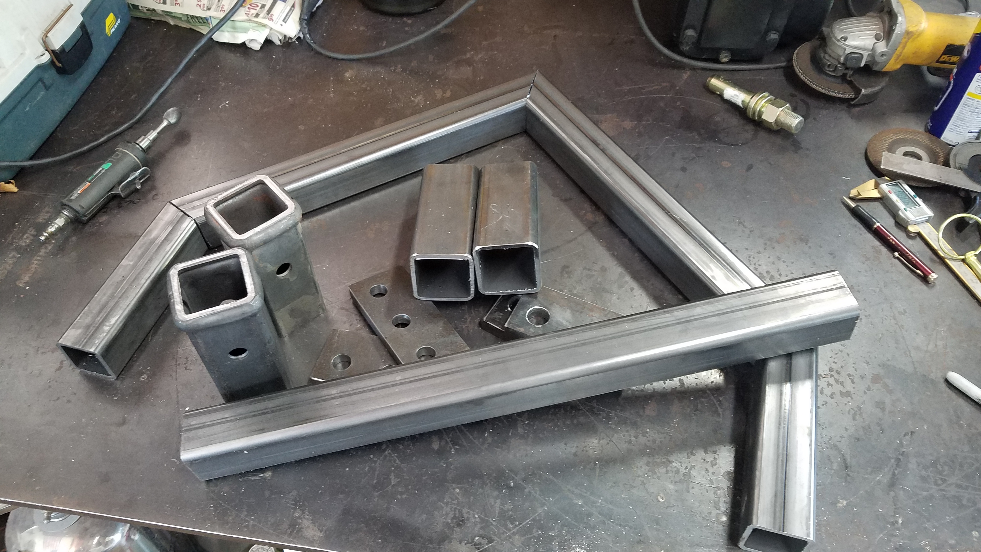

Made from 2x2x3/16 square tube, 1/2" plate, and weld-on 2" receivers available on Amazon.
(Yellow version made for Lo-Boy in 2015)

It's funny you mention the for storage pockets. I didn't think to add them to the lo-boy hitch years ago and it's been on my to-do list ever since. Needless to say their both outfitted with them now.

Hi nice job do you have any dimensions was the mitered cuts on a 45 degree any info would be great thanks Mark

Nice fab work and welding, like the pockets for the forks and extra receivers. Nicely built.
Jim.
   / Trailer Mover / 3PT Forks #9
Good job....is that TIG welded?
Yes TIG
