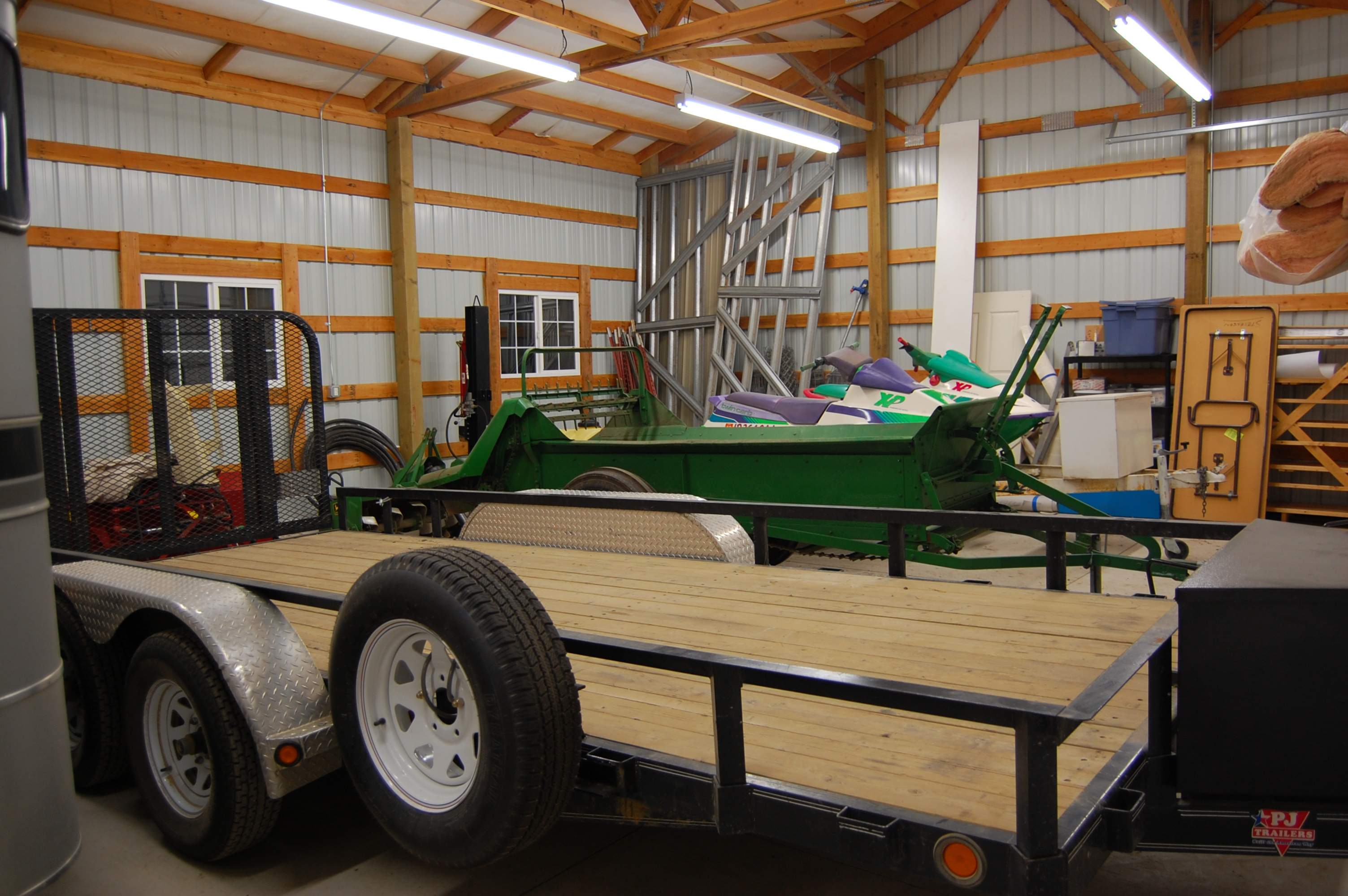

i bought a standard 16' car trailer for about 2400 us, and beefed up the rear drop gate with some c channel. I also built a front box. i can drive my jd870 up the ramp with no problem. ive also carried a medium sized track hoe on occasions. i fitted 2 rotating trailer jacks on the rear end to allow for heavier equipment to be loaded without stressing the trailer ball. ill have to sell this trailer and get a 5th wheel unit to support the weight of my new tractor though. some sort of dove tail unit i suppose.
