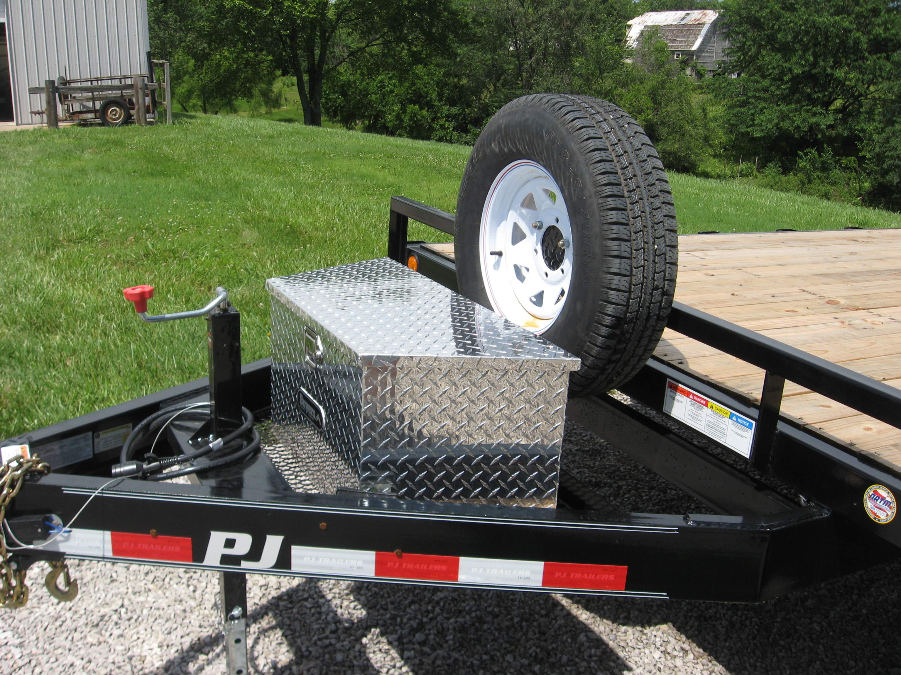

How about the best of both worlds? I just bought a 20' PJ Trailer with removable pipe rails. So, if needed, any/all of the rails can be removed in about 10 minutes.
Like you, I don't expect to often need a car hauler type trailer, and I like having the rails there to tie of onto, but having the option is really nice. Of course, between each pipe rail socket is a stake pocket with allows converting the trailer to one with solid sides for hauling dirt, etc.

"Is there a pro vs con of the leg jack location? It appears some are at the very end of the trailer - nearest the coupler vs some are back from the coupler location and closer to where the trailer deck begins. "
Three problems I see with having the jack forward rather than back. First, depending on how far forward it is, it could limit your ability to install a tongue mounted toolbox (having the spare tire mounted in there didn't help things). Second, if you ever want to use a weight distributing hitch, the crossmember that holds the jack may interfere with the brackets. Third, if it is too far forward, your tailgate may hit it when it is lowered. I had the first two issues with my trailer, mainly because the jack was almost in the middle of the tongue.

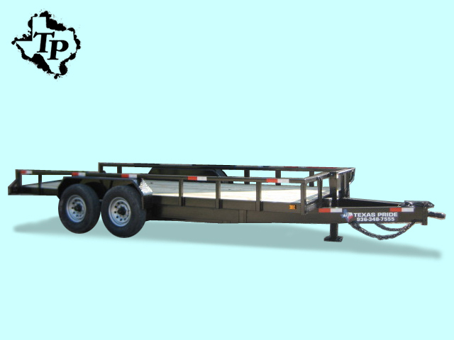

Photo 1; rub rail with stake pockets - attached ramps - forward leg jack

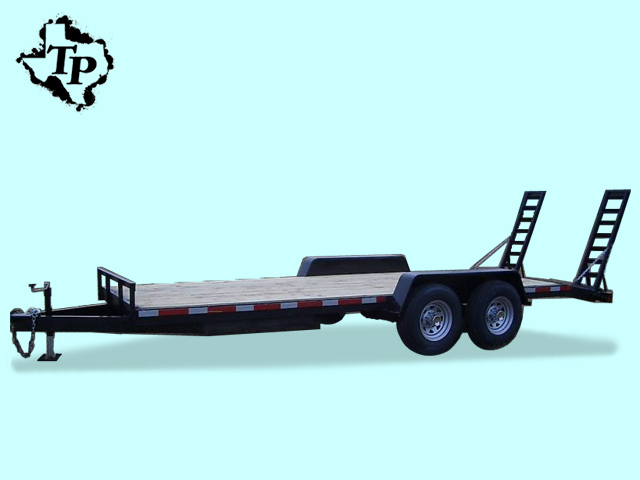

Photo 2; pipe tope - slide in ramps - jack near deck

Go with #1 but makes sure you get the rub rail the full length. It just makes chaining down so much eaiser.

I'll never own another trailer with a forward jack. Too easy to drag the jack when you go into a steep parking lot, or through a ditch. The closer it is to the pivot point (the hitch) the more likely it is to drag. additionally, if the jack is up front, it is more trouble to drop the tailgate with the trailer hooked up.
10k spring loaded, drop leg jack for me from here on out...
