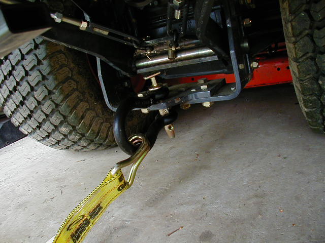

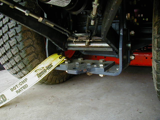

I actually hook mine to the inside of the drawbar with straps. The attached picture shows where I attach the straps to the rear of my unit now (only one side shown)
I first bougt a clevis to go through the drawbar, but the other day decided to try this spot and I like it much better.
   / trailer question #7
This picture shows how I was doing it with the clevis, of course I had two straps pulling from opposite directions, but it still only gave a single point on the tractor and if one broke would have loosened the other without the tractor even moving so that is why I have changed now. If one breaks now, the tractor has to move also.
