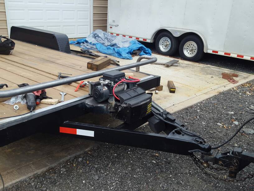

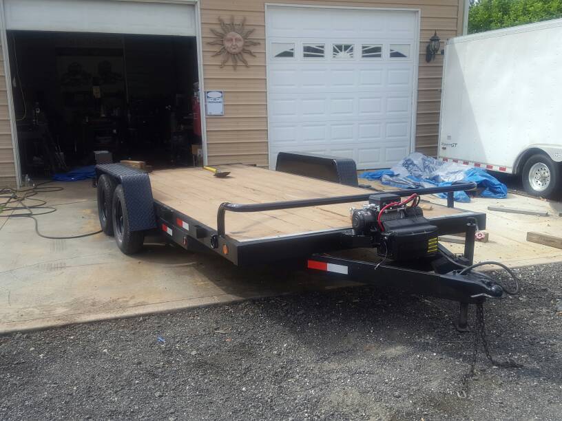

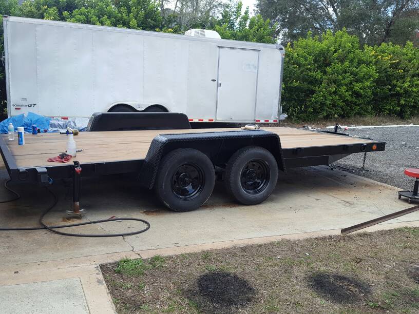

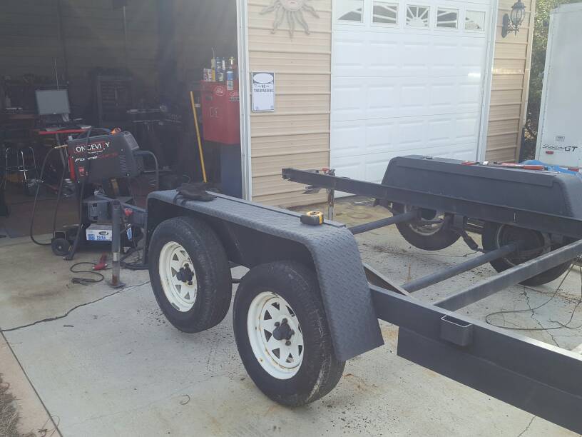

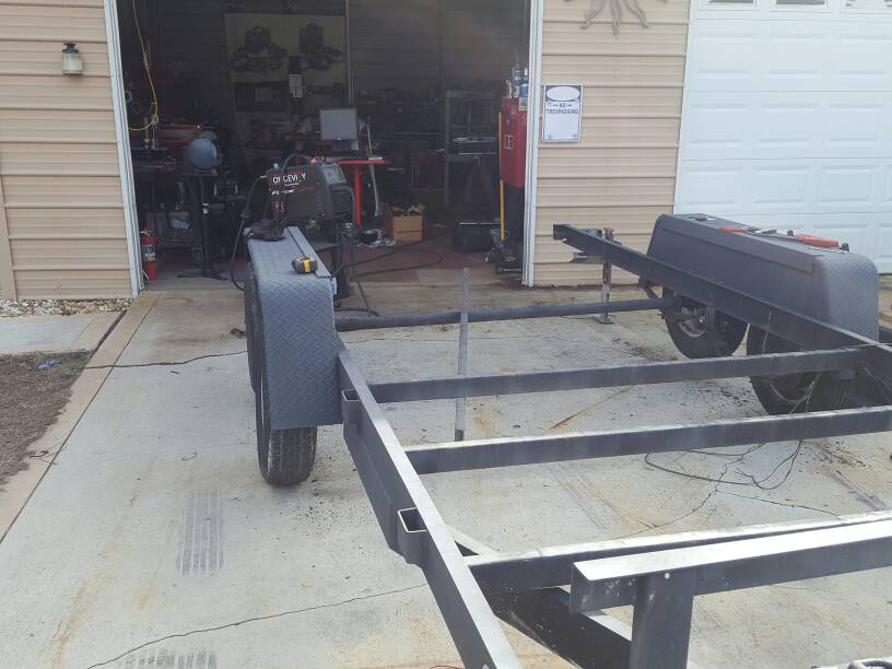

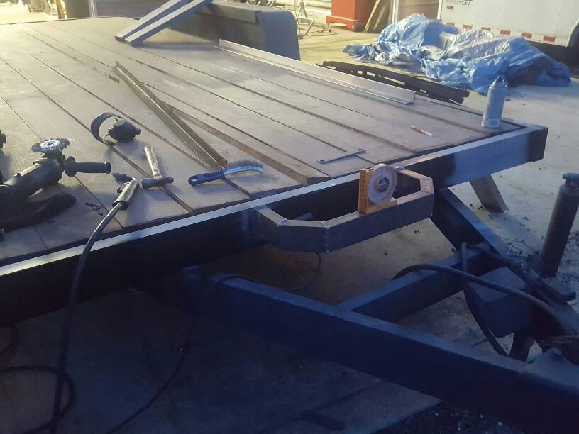

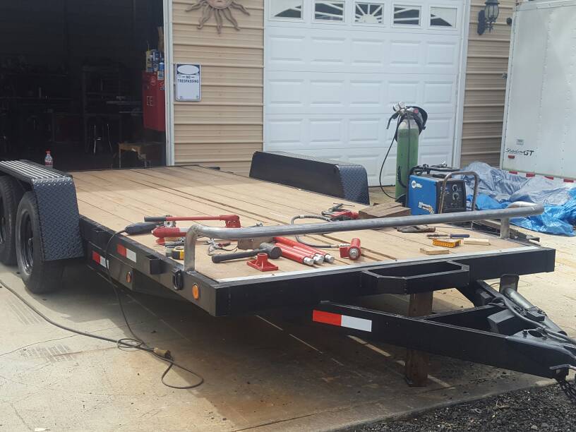

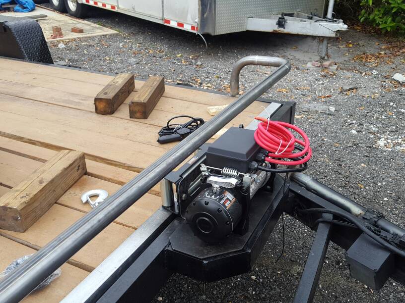

We had broken cross members on the 16 ft flatbed trailer, 3/16 channel went in to replace the weaker factory prices, a new coat of paint, a custom bent header tube and a 12k badlands winch was installed 20180127_150450.jpg20180127_150457.jpg20180211_182948.jpg20180221_141041.jpg20180304_121958.jpg20180310_120301.jpg20180311_171734.jpg20180311_183121.jpg

Looks good.
Now put brakes on the 2nd axle to MTGA (Make Trailer Great Again) :)

Looks great!
You might want to consider putting an upright on each side of the winch so that if you bump it with vehicle wheels, it won't bend.
