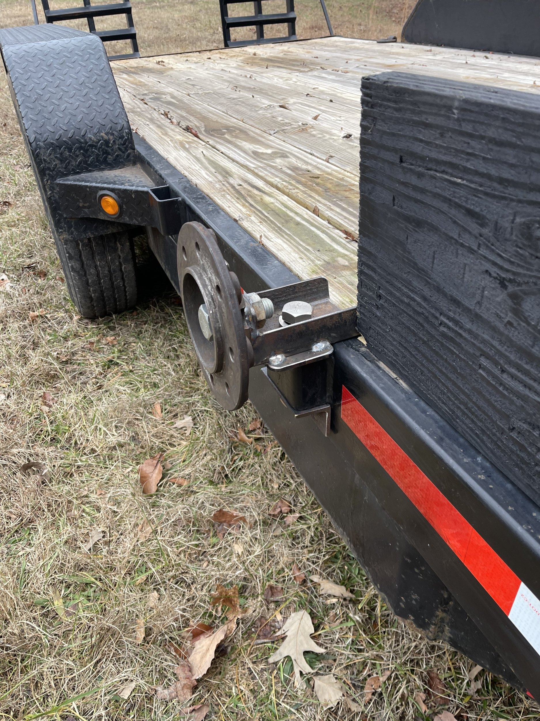

Ideas on building a trailer stake pocket spare tire carrier? Store bought types look too flimsy.
Want to be able to carry tire inboard or outboard. Bolt or clamp with lug nut size fastener to not rattle or easy to walk off.
Ideas please.

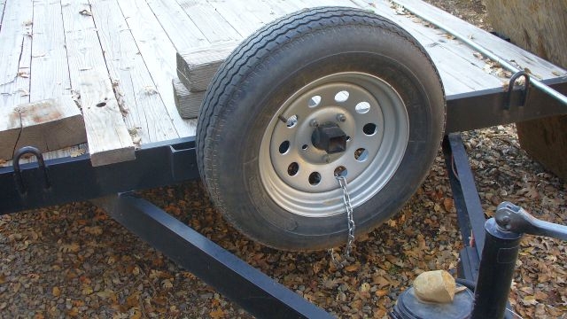

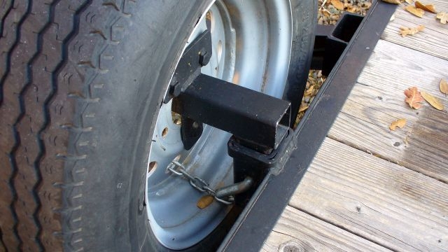

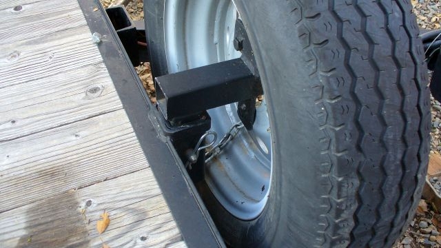

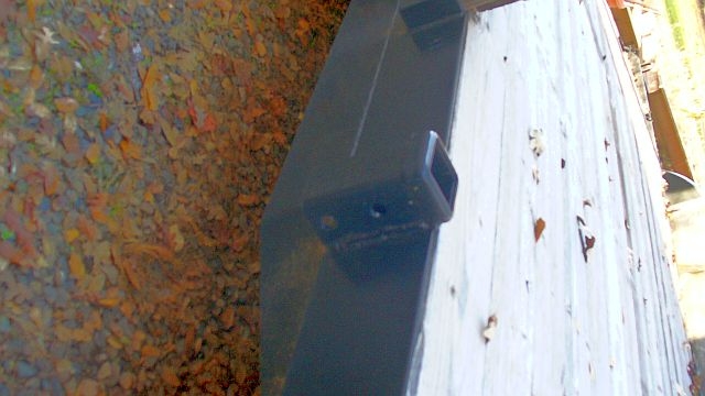

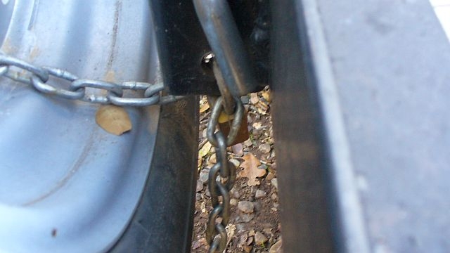

I made a spare tire carrier by using some 2x2 inch steel tube and it plugs into a standard 2 inch receiver hitch welded (vertically) to trailer side rail...Have two receiver locations, one on front of trailer and one on side of trailer incase load overhangs front.... Also front receiver allows me to plug in a winch mount..... Stake pockets are odd size and it takes extra effort to custom fashion exact size insert to fit stake pocket (at least on my trailer).... Also drilled side of insert and receiver so holes lined up and a padlock can be used to secure insert and a bit of chain for tire to trailer.... ..

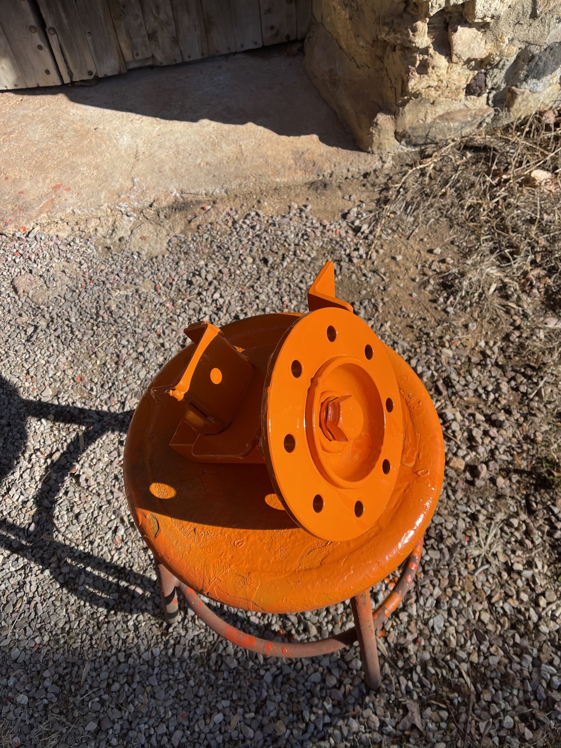

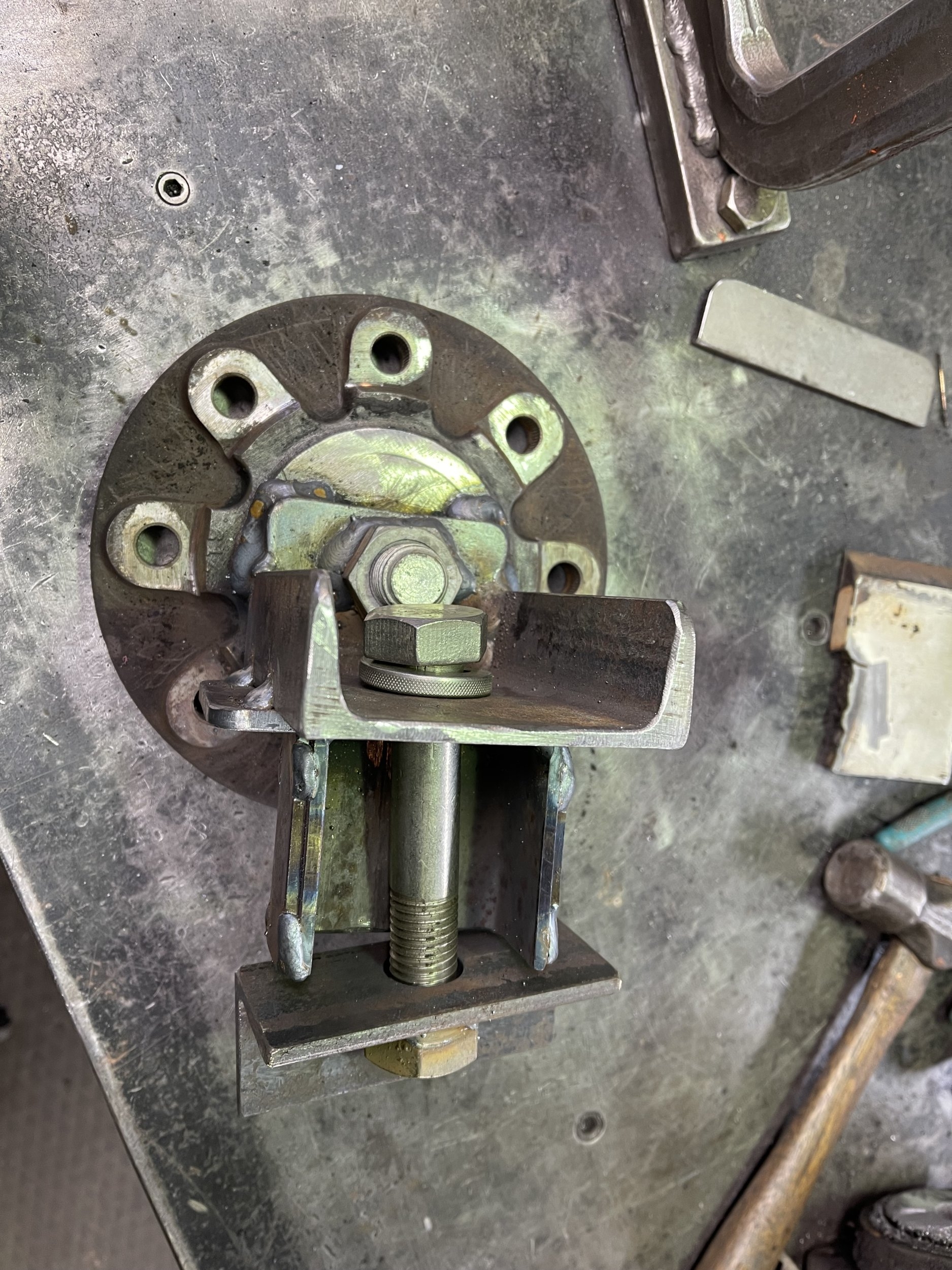

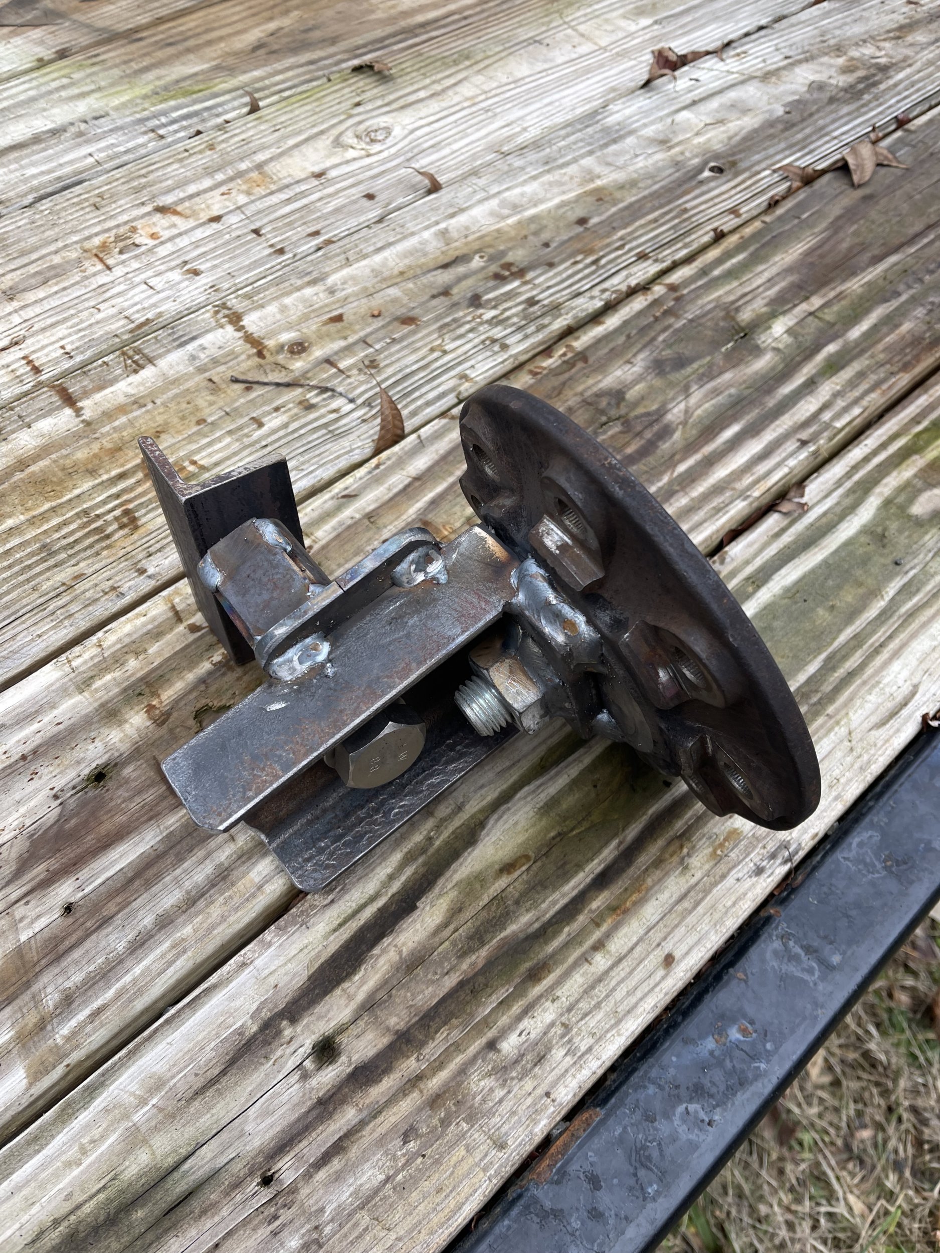

Test fitting. Good project to use up scraps
and bolt bin.
Hub from past dodge truck repair. Cast steel? Welded and bolted for strength.
All nuts welded. One 7/8” bolt to clamp
Rock solid. Keeps spare inside fender width.

Custom made carrier in paint shop. Cool weather slows the process. Drilled one lug stud for a padlock. Thinking using 4 studs.
   / Trailer spare tire stake pocket carrier

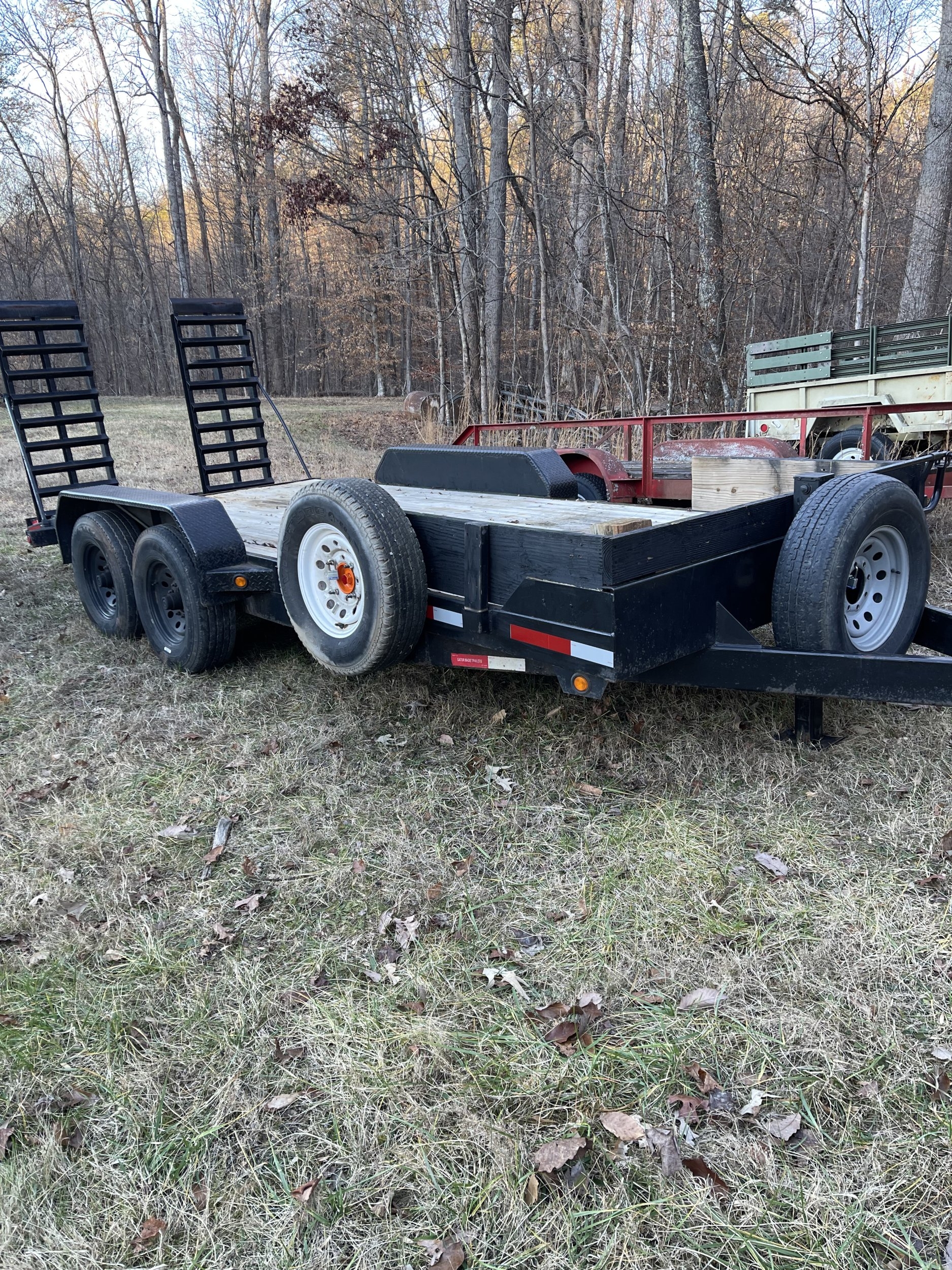

Finally installed. Holds tire close to bed rail and within fender width. One 7/8” bolt to install or remove. Rock solid with no movement or rattle.
Drilled a wheel stud for a padlock.
