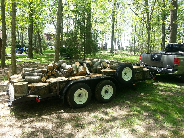

   / Trailer tire clearance #7
Here is a pic of mine loaded down and they never rub.
Chris
