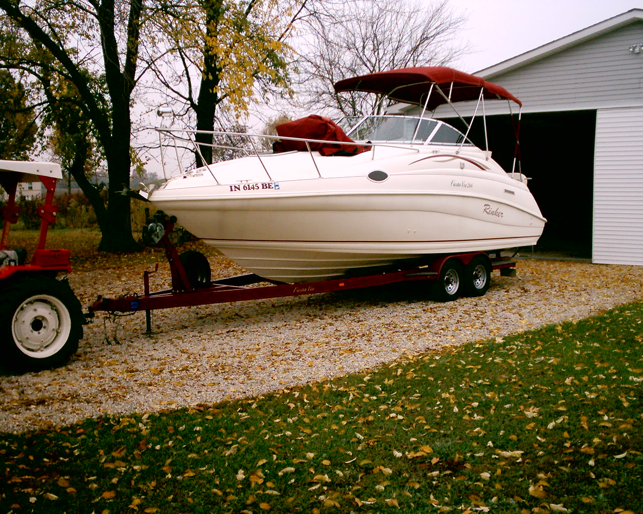

Diamond man remember there is a difference between jocking a trailer around in your flat dry driveway and pulling over 20K out of the woods on hills in the mud up to the wheels on a "farm" tractor.
I don't even own a flat draw bar. Just giving the guy a idea. I also made a Reese style hitch out of one I took off of a Explorer. It is made of 1/4" and 1/2" thick steel and is heavy duty. I pull boats upto 25 K with mine all the time and it does not flex one bit. Just like you, I built mine for under $50.
I do like your idea of making a 3pt receiver adapter from a truck hitch. I was only pointing out that ( at least Most ) of those units like TSC sells are rather lightly built. I also suspect you are able to pull the 25K with the CUT because of ideal conditions. My tractor weights almost 10K and I've had enough tongue weight on my 14K trailer to lift the front end up even with weight in the bucket on the front. Put that same load out in the field in mud and on a hill and it had better be built tough.

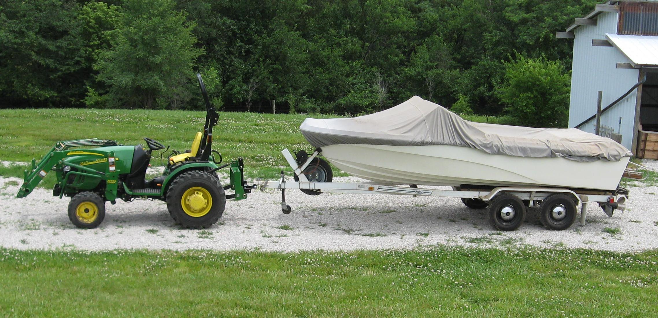

SailorBob,
If you have any welding skills, you can build something like this.
Sheesh JJ. Is it stout enough?
Looks like something the government would buy to lift a 200 lb trailer.
Great build, and it looks tougher than most anything on the tractor! ;)
