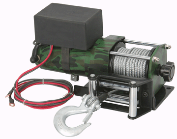

I have a 18' trailer and mounted a 3000# capacity winch from Harbor Freight. It has 50' of cable and came with a snatch block to double the capacity even though I have never used it. It has met all me need and then some for $69.
I mounted a piece of 3/8" plate and then mounted the winch to that. I started with a battery on the trailer but removed it and now just use my Jump Box. I mounted two battery lugs to a piece of plastic and marked the appropriately for + & -. I have used it to pull up 2 Corvettes, a Suburban, a Lumina, a Cavalier, and a Kia.

Here is the winch but mine is not camo but all black. I will be away from the trailer until Thursday but it should be a easy job to fab something up for your needs.
Chris

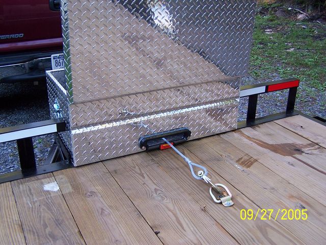

Matt,
I have a hydraulic tilt bed trailer. I made my own frame extension on front of mine to mount a box in which I installed a winch and an electric / hydraulic power unit. I added the power unit to replace a manually pumped jack that originally tilted the bed. The winch is an 8000lb unit I bought at HF. (not a famous name winch but it does what I need it to do) I sometimes use a snatch block pulley to double to pulling power if needed. I use a separate battery that operates both the winch and power unit and is charged whenever its plugged into my trailer hitch plug. I've used the winch about 20 times or so to haul up dead vehicles.
