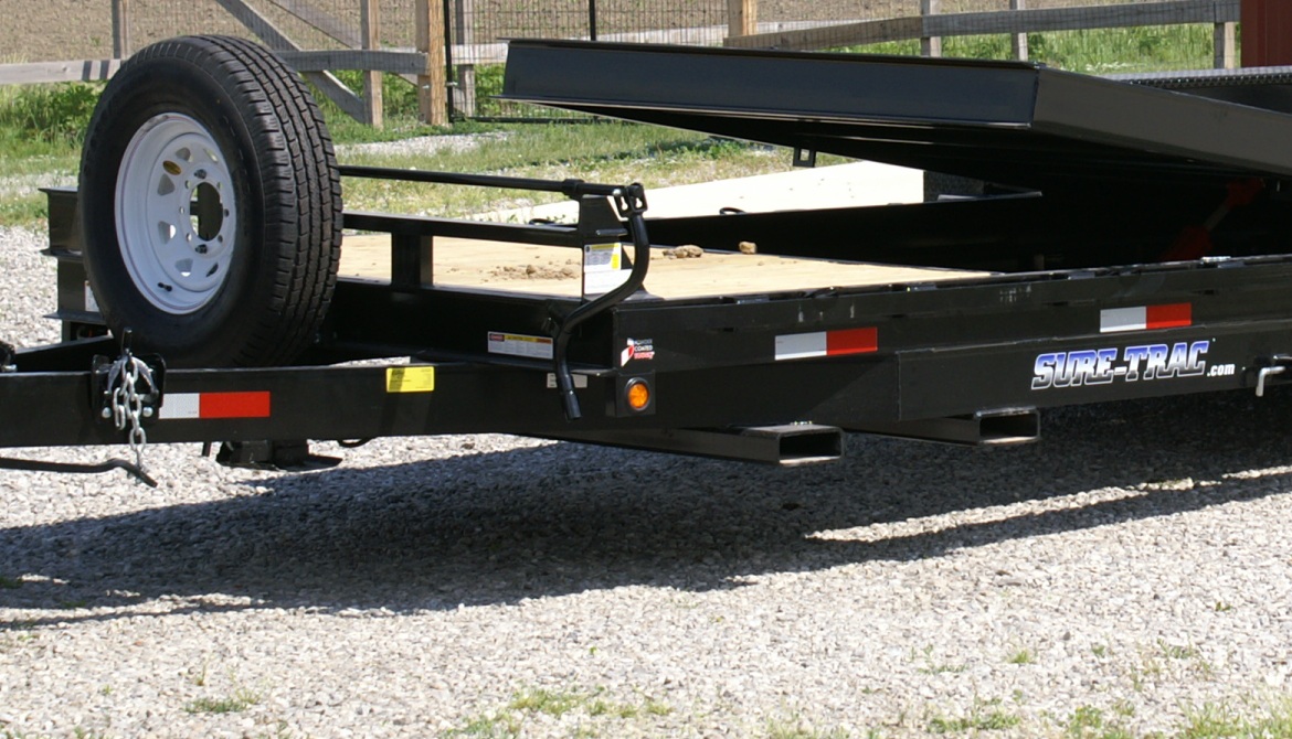

   / Trailer with fork attachment storage #8
Here are some pics of mine. It is a SureTrac and I just use a chain and binder to hold the forks on.

Thanks for the pictures and input. I can see how it might be difficult to spear the trailer if the ground is uneven, also the width restrictions on a 102" trailer. I'll have to buy a gooseneck and put the forks on the upper deck.
