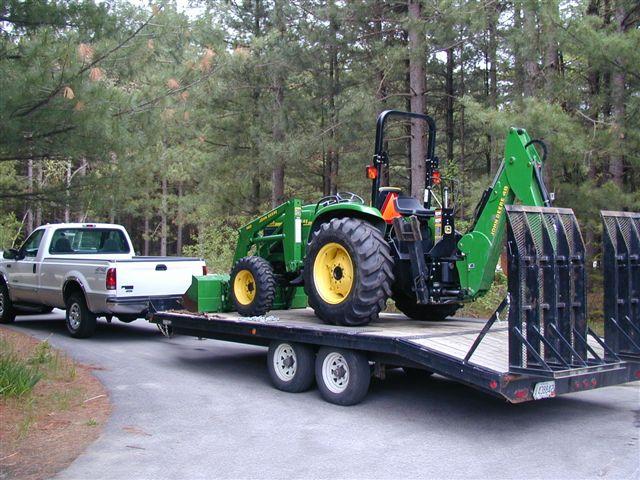

If you trailer with the backhoe attached you will have to be careful about scraping the hoe mount. I delivered my 4600 w/hoe /forums/images/graemlins/frown.gif to its new owner and had a tough time getting it on and off a trailer with just a beavertail and ramps. The trailer I rented was what is called a deck model, meaning the deck was above the trailer wheels. I wanted the extra width for the tractor. Some trailers have the deck lower, between the wheel wells. Less room but probably easier to load. If I ever buy a trailer it will have tilt bed, I hated messing with the ramps and grinding the bottom of the tractor.

<font color="blue"> If I ever buy a trailer it will have tilt bed </font>
A convert... /forums/images/graemlins/grin.gif It's truly the way to go. /forums/images/graemlins/wink.gif /forums/images/graemlins/smile.gif /forums/images/graemlins/cool.gif
