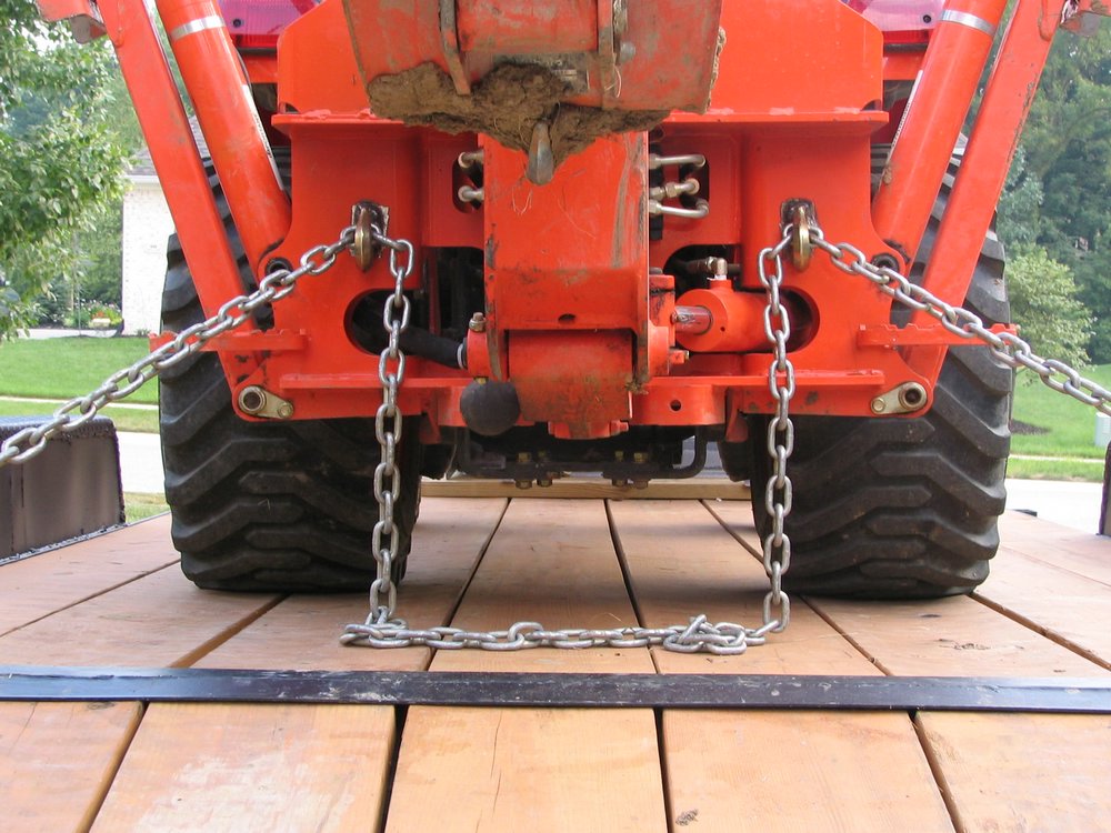

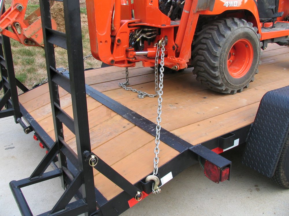

One other thing I have heard is that the machines need to be tied down at four separate points (rather than running a chain or strap through the frame or around the bucket etc). I towed heavy equipment for years using only a "front chain" and a "rear chain" ran through the frame and never had a problem, but I guess the theory is that if one of the chains broke, you would be SOL.
Here is what I came up with for my little toy ....

/ Trailering a B3030 #13
BX24, i can't answer for Lawn King, but as someone with real world experience, i can say that it takes neither to get a ticket (or worse) for this type of thing. Its just how law enforcement is trained today. If there is anything they can write a ticket for, they have got to do it. The officers on the street want to keep their job, and the state wants their revenue. Unfortunately, its really about the revenue. I can't tell you how many times i've heard this in casual conversation with LEOs. In a previous life i owned a towing service, and might have been the guy the law called to tow away your improperly tied down/inspected/loaded/registered trailer with tractor on it. Of course...... i was also harassed/ticketed/fined for the same infractions / grey areas myself. Unfortunately...... for everyone who says they see unbelievable junk going down the road, with crap on board not even tied down....... i see it too and very rarely do you see law bothering those people. Again.... it comes down to economics. If you are driving a nice truck with a nice trailer with a nice kubota on it........ you can afford a ticket !! Plain and simple. I've even heard officers in scale houses say (as a particular truck rolls through) .... hey, we haven't given so-and-so a ticket for anything in a long time, go out there and find something to write him up for !
Your set-up looks good. I would make sure your front straps are permanently marked by the manufacturer with the working load limit(either with tags sewn into them , or printed right on the strap itself). I would also recommend you put a strap (or a chain through your center hook) over the bucket. And........ since your backhoe must pin in the upright position (always have it pinned/locked in place), if it doesn't pin or lock in place side to side.... i would chain it or strap it from being able to swing.
I know eighty percent of the members on this site read this tie-down stuff and think "this doesn't apply to me / they will never bother with me / this only applies to commercial vehicles", but i can assure you today there were officers in your state being trained to write tickets on this stuff TODAY.
