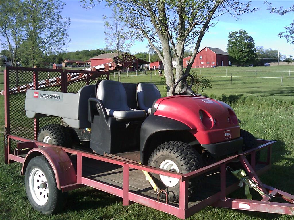

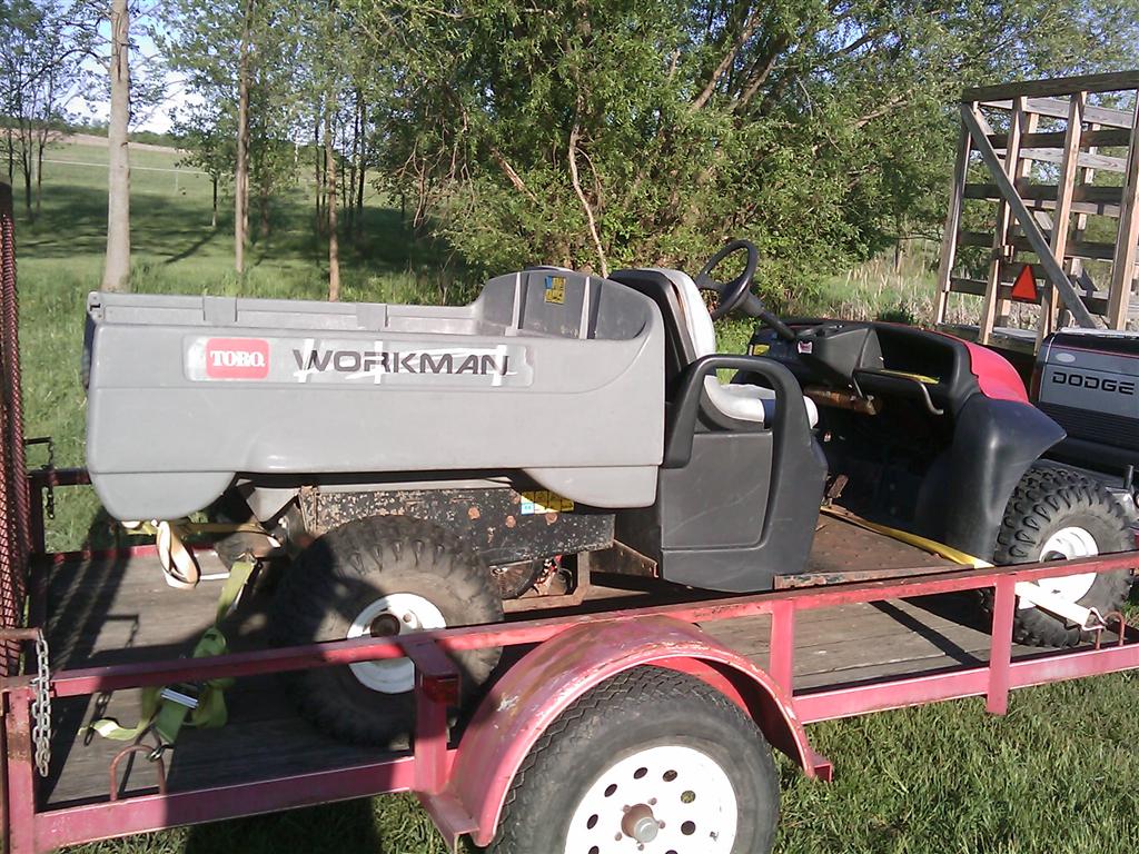

We have a Polaris Ranger 6x4 with seating for 3 and a Ranger 4x4 with seating for 6. What I do is use 4 straps. On the front I connect to the bumper. It's very robust and has a winch mounted to it. On the rear I connect to the trailer hitch in the safety chain spots. Again, very robust.
Chris
   / trailering a gator 6x4 #5
I hook 2 straps on my RTV front grille guard, and 2 straps to the back axle.
